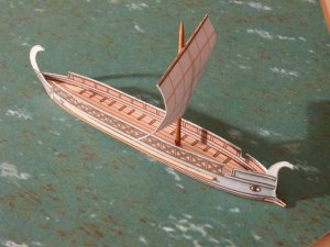

When Al Hazlet first introduced the Roman Seas products in this forum (->http://www.cardmodels.net/forum/showthread.php?t=3789) I tasted blood and I simply had to have some on my own. However, I'm not a wargamer and my goal is to built them as display models. I started with an out of the box build, anyway, to get used to the design. And this is the result:

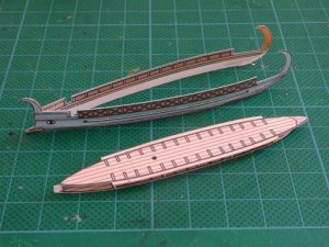

Due to their nature as gaming miniatures these models have some peculiarities that have to be changed for a display model.
The scale nominally is 1/300, but actually all ships are enlarged to provide enough deck space to set up the crew. The actual scale can be estimated from the distance of the oars, the Interscalmium, which, according to the roman engineer Vitruv, was about 92.5 cm in the roman fleet. The model has 15 rudder banks on 51mm length and thus has rather exactly my standard scale of 1:250. Cross check: The ships l.o.a. of 9cm calculates to 22.5m, which is scarcely longer than the Navis Lusoria replica from Regensburg (->http://www.vefag.de/, goto 'Römerschiff') and only a little shorter than the Triacontor, according to H.D.L. Viereck, "Classis Romana - the Roman fleet" (both likewise with 30 oars).
Further the rudders are printed on the hull sides for easy and fast construction. I, of course, want to have them as seperate parts. I couldn't remove the rudders at the computer, because the original files are protected. Therefore, I printed the hull sides one more time on thin paper and pasted over the rudders with small bits of it.

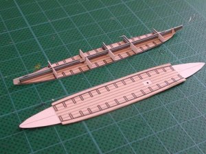

The biggest issue is the stern, where a large hole gapes in the hull. To close this gap I started with providing the hull with an egg crate style interior. The base plate was made from a deck, extended at the bow and shortened at the stern. Then longitudinal and transverse bulkheads were added from cardboard. I also printed the deck on thin paper and glued this onto the undersurface of the deck, so that the protruding parts of the deck get color also on the lower surface.

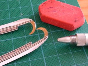

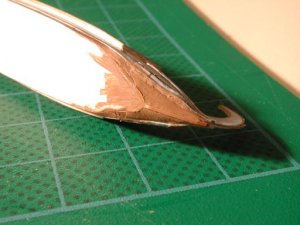

Before glueing the hull sides to the interior structure they are prepared in this way: I pre-formed the hull sides with a rounded tool on an eraser, beginning at about the last field of the railing. Additionally, I repeatedly cut in the edges, but this might be unnecessary. After the hull sides were attached, I cut out a triangular piece out cardboard in the color of the lower hull (taken from a screen shot). The edges were thinned by sanding and the whole piece was pre-formed on the eraser, too. After dry fitting was satisfactory, I glued the triangle to the hull. I especially payed attention that the edges were thoroughly attached. I used diluted PVA glue, well, mainly because I always do, but in this case this glue has the advantage that the humidity softens the cardboard, which makes forming easier.

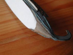

To immitate the keel I glued a strip of cardboard along the centerline. Finally, after sanding the bottom flat and some touching up with Tamiya XF-52 'Flat Earth', the stern is finished!

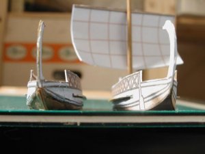

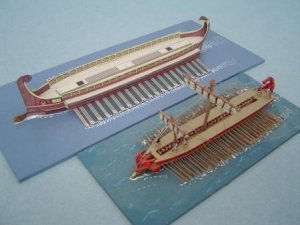

I agree with you about the "scale creep" of the Roman Seas ships. I'm attaching a picture of my Langton 1/300 Greek trireme next to my Roman Seas trireme. The Langton model is dwarfed. 1/250 for Romans Seas seems correct to me. I think that's probably just as well, since the best 6mm soldiers for it are Bacchus which are also oversized. Not to mention it makes the models a little easier to build.
Hats off to you for adding detail. The only thing I did was add the extra deck piece. I think the ships would look better with the decks full of soldiers (although when the heck would I have time to paint 6mm ?). But they can stand alone as card models. Since these are vector graphics, you could conceivably blow them up to 1/72 and fight some great boarding actions with plastic troops. That's where adding the egg crate interior would become essential, I think.

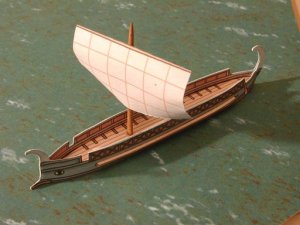

Finally... the scout ship is finished!
For several reasons I've stalled this build for over than half a year, but I wanted to finish it in time for the model show in Oberschleissheim on march the 3rd and 4th, and hey, I did it!

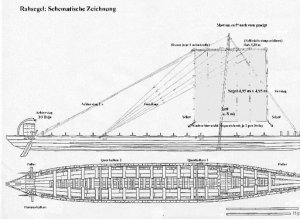

It was mainly the rigging, that was still missing (and please foregive me in advance any wrong terms, I don't do this in my motherlanguage. Actually, this is all based upon the Wikipedia article on rigging: http://en.wikipedia.org/wiki/Rigging). First of all, I had to find out how the roman s rigged their ships. I took my informations on this subject from H.D.L. Viereck: 'Classis Romana, Die Roemische Flotte', Hamburg, 1996. Additionally, I contacted the University of Regensburg, and I got specific information on the rigging of their aformentioned replica of a navis lusoria.
In general, the rigging was relatively simple.
The standing rigging consits of forestay, backstay, and the shrouds. All lines run through blocks and tackles.
The running rigging consists of a double halyard, sheets, braces, and clewlines and buntlines. Furthermore, the romans also used lines running from the mast top to the yard ends, which I unfortunately havn't found the english term for. The braces run through blocks. Very characteristic for the ancient rigging are the clewlines and buntline, which run in a direct line from the yard to their attachmentpoints in the back of the ship (on modern sail ships, in contrary, these lines typically run on the inside of the shrouds and, therefore, are quite unrecognizable).
Based on the rigging plan I got from Regensburg, my model has two shrouds on each side and none of the linesIdonotknowthenameof. I've ommited the halyards (no vale la pena) and I simplified the braces, i.e., I used a single line. This is, because the thread I used for the rigging is far from being as thin as it should be.
(Note, that in the plan shrouds and halyards are ommited, and the sheets are only indicated by arrows. Some quite good pictures that show the shrouds can be obtained from the 'presse' section of Dr Christoph Schaefer's home page http://www.antike-multimedial.de/201.0.html, e.g., at http://www.antike-multimedial.de/761.0.html?&tx_jppageteaser_pi1[backId]=650).

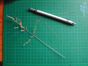

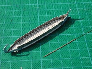

First the mast. I made it from a bit of dried gras, reinforced with a brass rod.

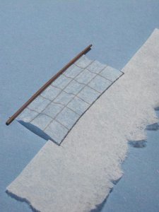

The yard was cut from two layers of card board and the sail was printed on tissue paper. I've folded and precrumpled it a bit, then fastened it to the yard. The corner of the sail hang loosely from the yard, which probably isn't historically correct, but definitely looks good. I used diluted PVA glue to keep the corners in their form.

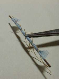

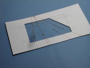

Next came the cordage.

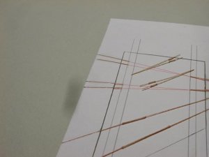

Shrouds, forestay, and backstay were put in a jig and then treated three times with diluted PVA glue. After the glue has dried, the thread is quite stiff and can easily be attached to the model.
