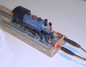

I made my one myself for partion of the price asked in the shops. On a sweep market I could get plenty of cheap roller beerings with pressed in axles. I cut pieces of Aluminium L profile 10x10mmx15mm and drilled 2 holes and pressed the bearings into the holes.
On the another side I drilled an another hole for a fixing screw.
The basis is made from 2 about 500 mm long square tube (10x10 x500mm) where on one side I milled a long opening (about 460x3 mm) long for the fixing screws.
The L pieces with the bearings are easily placed in correct location, the power is feed into the basis tube. Even I can adjust the rail distance. My test track is good for TT 1:120 till Scale 1 (1:32).
:rolleyes:
