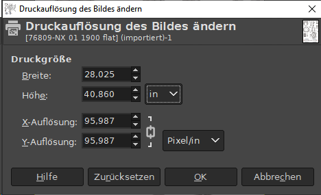

The resolution is DEFAULT PC IMAGE RESOLUTION which is 96dpi:
This means the image is 28x41" big! The page contains all the parts necessary to build the model. So you need a 28x41" big sheet of paper to print everything properly. Well, to be exact, your sheet of paper still needs to be a bit bigger because your printer will leave a small portion of the rim white. I may be mistaken but I do not know of any sheet of paper which is that big.

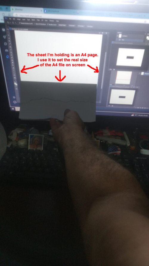

What do you mean with "open in picture 1:1 to see the actual size"? Does Photoshop display an image at printing size on the screen? For example, if there is a 1"-line on the page which is supposed to be printed 1" long is displayed 1" long on the screen at "1:1"?
yeah, something like that. If I create an A4 page, with the same real time measurements, and open in print size, I can see exactly what it will look like on paper, That's How I do "Eyeball Scaling". lol

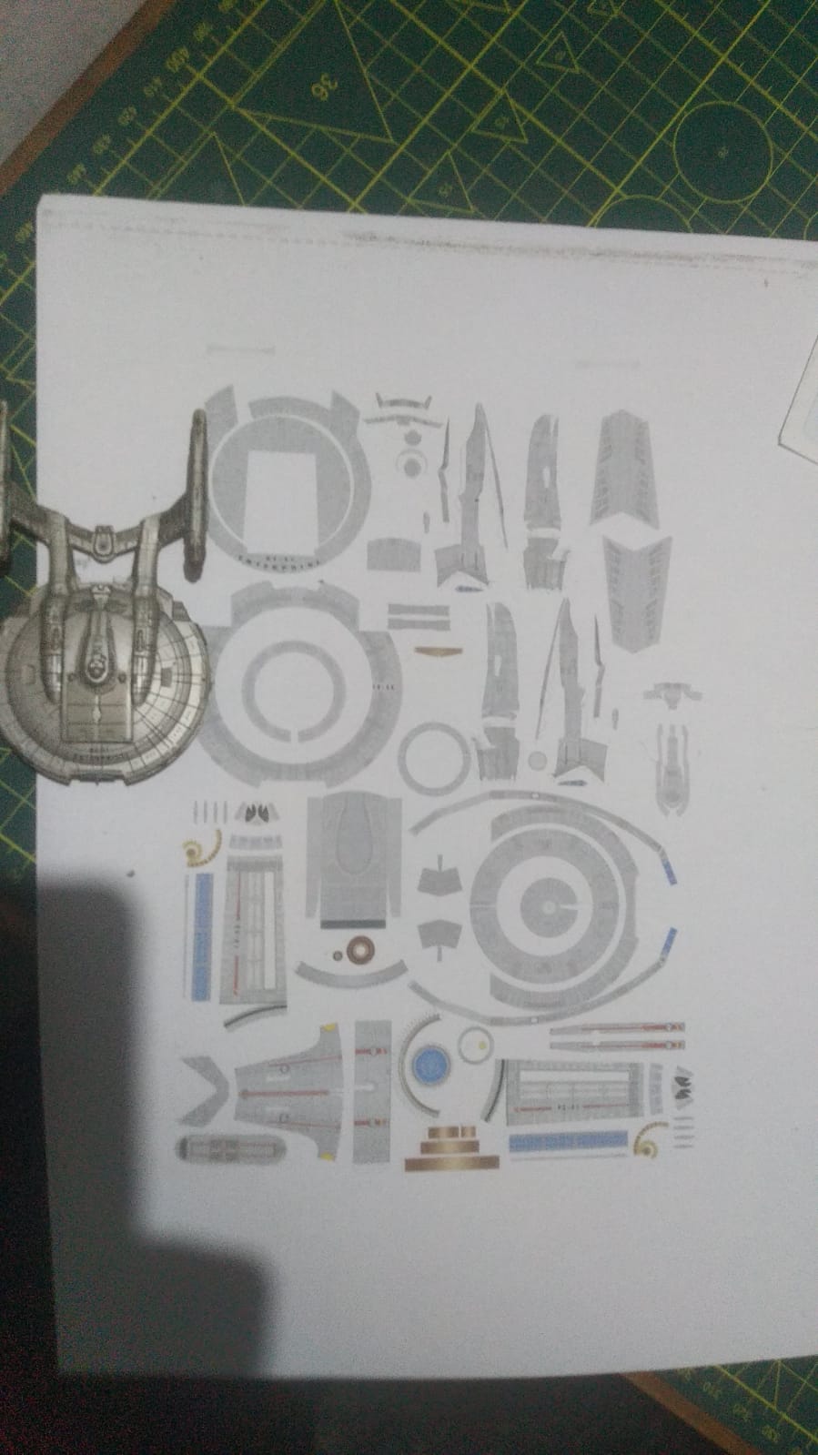

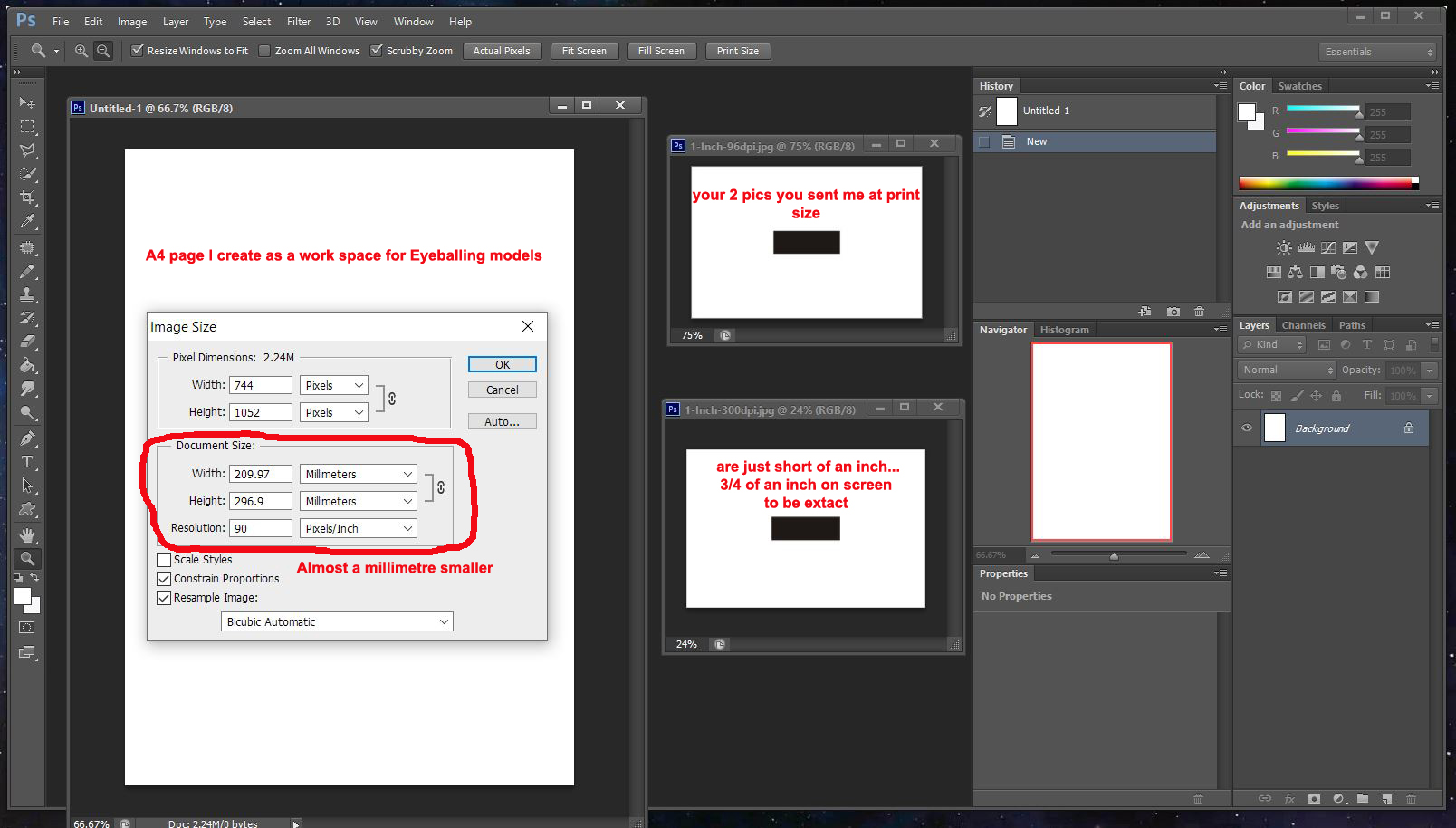

Ok, I'm going to show what and how I do it by fotos....
Ok RF, here's what I do first... What I see in "Print Size" (depending on the image, sometimes I have to make small adjustments, like in the top one of your 2 fotos) the bottom one is the 300dpi (that one to a bit longer to adjust. view foto below) I then creat an A4 page (the one on the left).
Then I do what I wrote on this page.
Next I adjust size of original model (this case, your bars) and transfer them on to the A4 page.
Save it as a JPG file and print.
It's a bit of a hassle but I get this result.
BTW; I readjusted it so now it's correct.b202e272-0316-471c-946d-ad7386995d8d.jpg
1:2500 exact.
BTW; I readjusted it so now it's correct.View attachment 221570
1:2500 exact.
