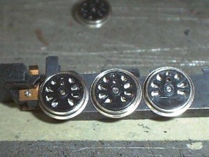

This is how I repair the split axles on Bachmann N scale locomotives.
The materials required are.
3MM ID brass tubing
Loc-Tite (super glue will work but sets up faster)

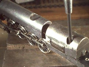

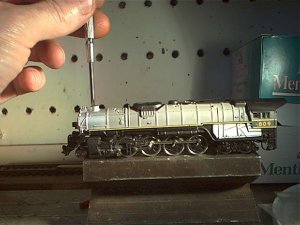

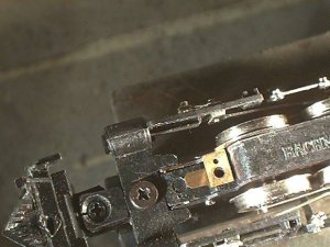

To dissassemble the locomotive, remove the screw in the smoke stack and lift the front of the boiler and slide the shell to the back off the tabs on the rear of the frame.

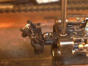

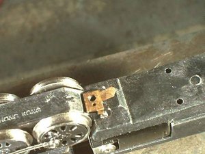

The front side frame rail screws must be loosened to release the light wires before the weight is removed. The cylinder block can be pulled downward to access the screws.

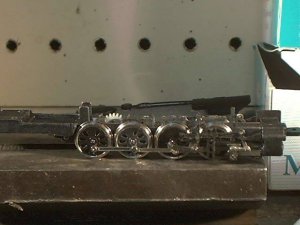

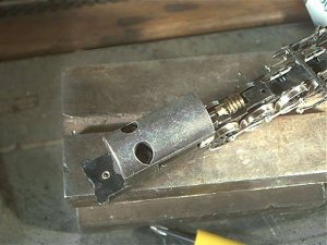

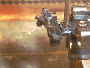

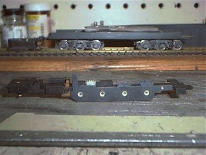

Remove the crank pins on the second set of drivers and remove the cylinder block and valve gear.
then remove the remaining crank pins and siderods. The pins are pressed in and can be pried out with a small screwdriver.

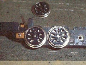

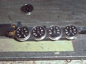

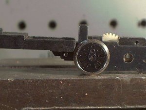

Remove the drivers from the frame by prying them outward with a small screwdriver.

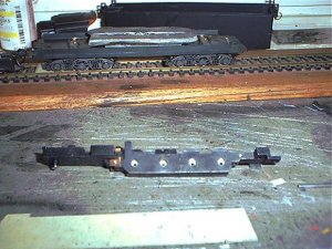

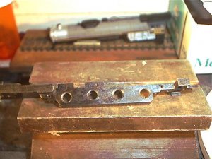

Remove the side frame rail screws, remove the frame rails and gears.
Wash all the parts ( except motor) with warm soapy water and dry thoroughly.

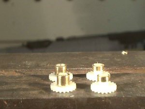

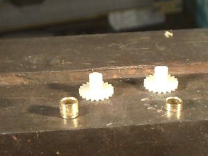

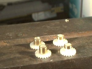

Cut 4 sleeves from 3mm ID brass tubing.
2 .130"
2 .065"
The 2 sleeves on the rear axles must be shorter to provide clearance for the reduction gear.

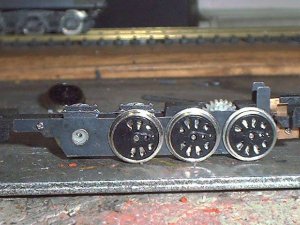

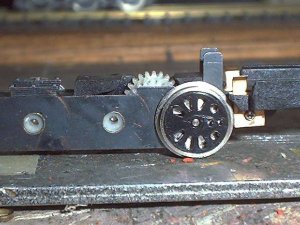

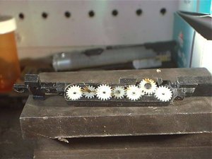

Reinstall the gears in the frame and apply a small amount of grease on the gears.
Then reinstall the side frame rails and screws.

Installing the drivers.
I start with the right rear driver. Put a dab of grease on the driver bearing and a small amount of Loc-Tite on the axle and press the driver into the axle center.
Rotate the the reduction gear counterclockwise untill the crank pin on the rear driver is at the 12 O'clock position. This takes the play out of the gear train.
Lube and Loc-Tite the next driver and press it in with the crank pin in the 12 O'clock position. Rotate the gear train by the reduction gear to verify the 2 drivers are in time. Re adjust the driver if necessary. If you use super glue instead of Loc-Tite this must be done quickly before it sets.

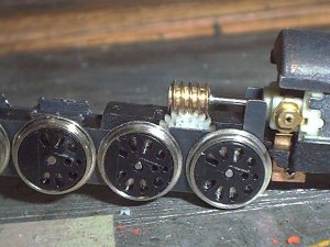

Check the mesh of the worm and reduction gears.
I found this loco needed to have this clearance adjusted. This was done by removing a small amount of material from the frame to lower the motor.
