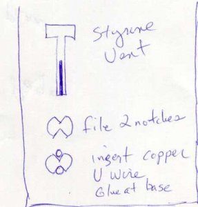

Or a rotary plastic vent switch.  File two slots up the sides of the stem with a triangle file and put in a piece of copper wire bent in a U.  Super glue it at the tip.  Turn it 1/4 turn in above contacts it's on, 1/4 it's off.  Retain it in a plastic socket so it stays straight and in.  FRED
