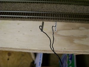

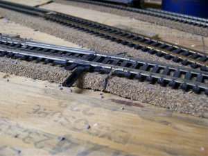

For a couple of bucks a piece, and if your soldering skills aren't the best, you could pick up feeders already attatched to the rail joiners, call terminal joiners.
Using the same method Russ mentioned above by drilling a hole small enough to run the wire through the roadbed. These will also be hidden when ballasting the track.
Atlas and Model Power, as well as others make terminal rail joiners.

Thanks guys, I'm a little more educated on that. Yeah, Russ I am using flex track wherever possible, partially because its cheaper. My soldering skills are ok, but I do like the look of the terminal joiners, I'll have to keep that in mind. I've got more confidence on rail soldering. I'm used to getting frustrated by circuit boards where the connections are smaller and the spacing is tighter.
