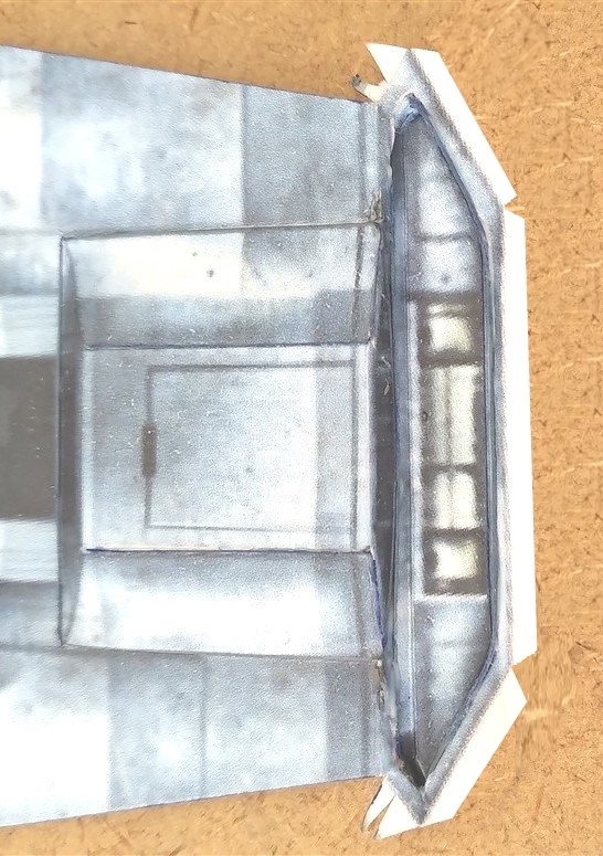

This is part of the rear landing unit printed on A4 which I practised with to get the feel of the build.
I will start by printing out the parts on plain paper just to check the fit, correct tab locations and method of assembly. Once satisfied I will number the parts and then start to build in modules.

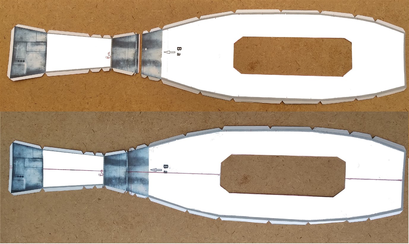

Main body.

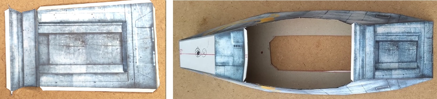

Join the base parts B to Ba and then re-enforce base B with 1mm card using the template guide provided.

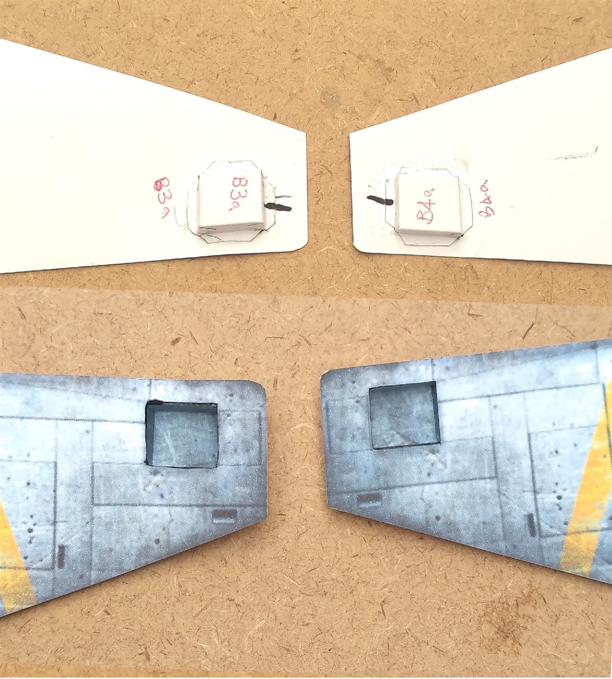

Assemble parts B3a & B4a and when dry, fit them to sides B3 & B4. Note that there is an alignment dot on one of the tabs on each part. This tab faces the front of the body.

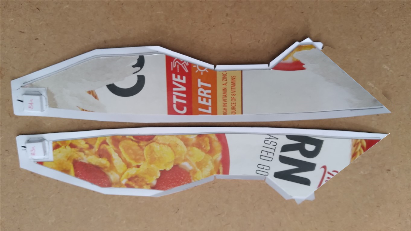

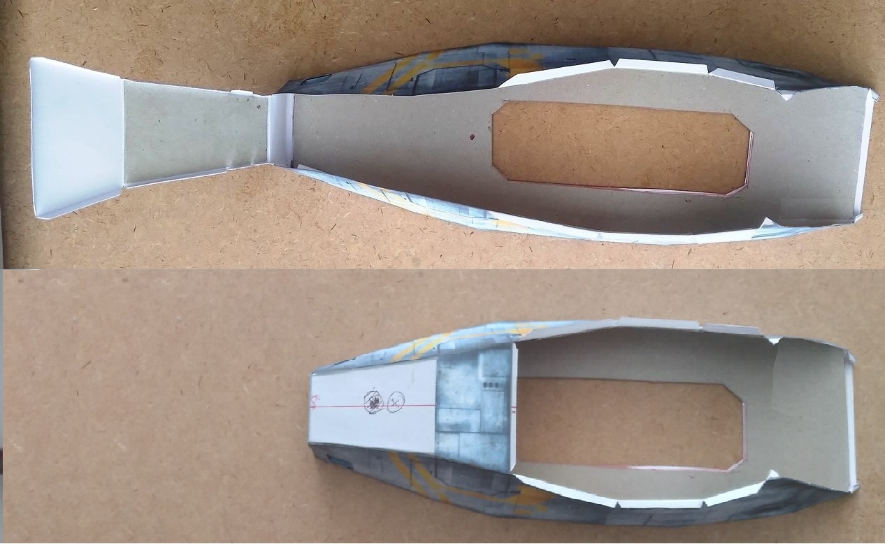

Using cereal box card, reinforce sides B3, B4 and part Ba as shown, leaving room for the base tabs at the bottom.

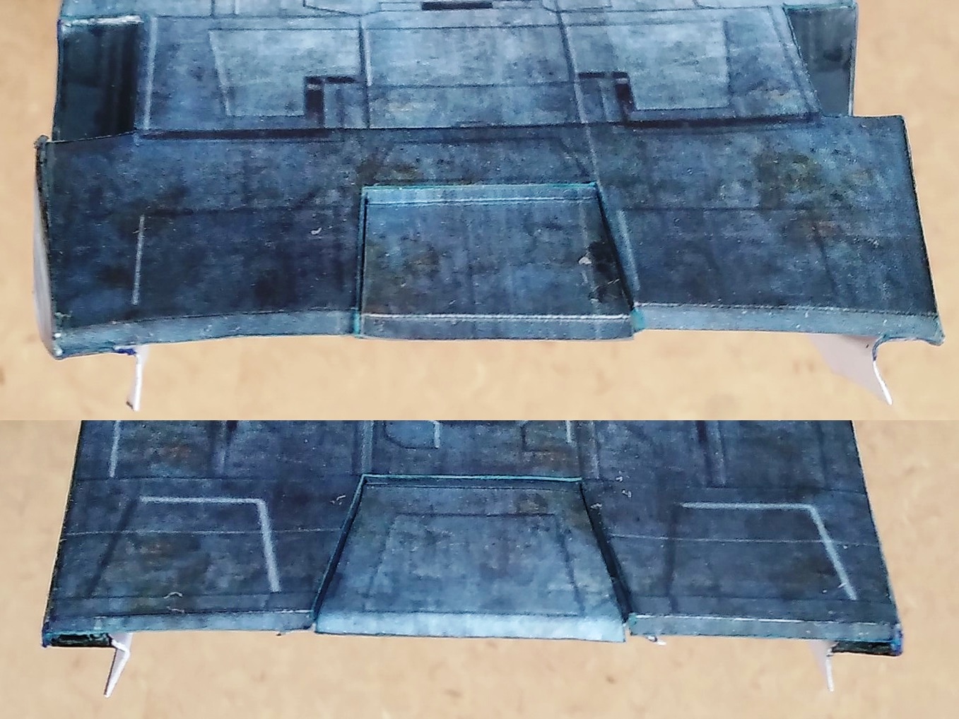

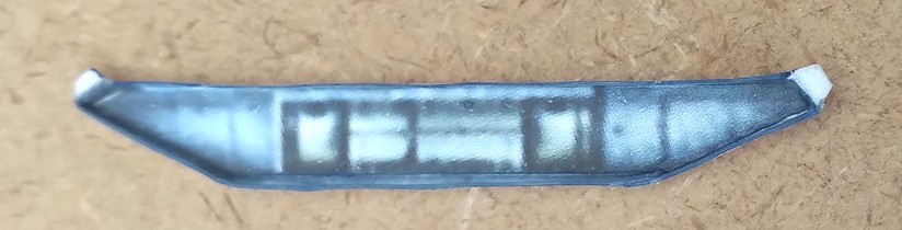

Rear landing unit.

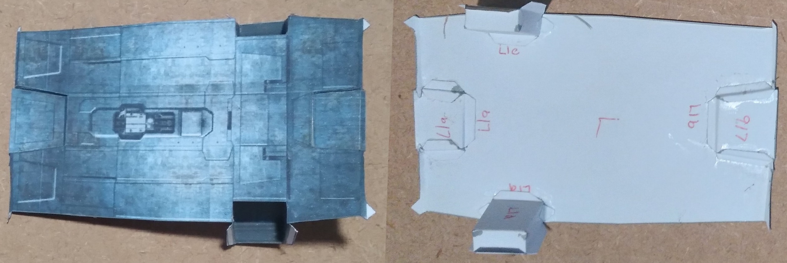

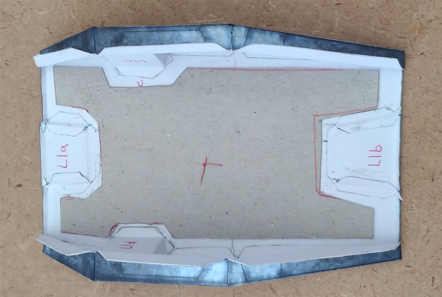

After assembling parts L1a, L1b, L1c & L1d, glue them to part L.
Now attach sides L2 & L3 to L.

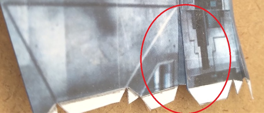

Note that the front and rear bend slightly.
Add reinforcing card.

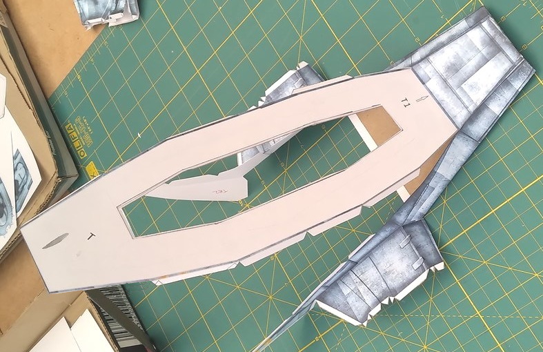

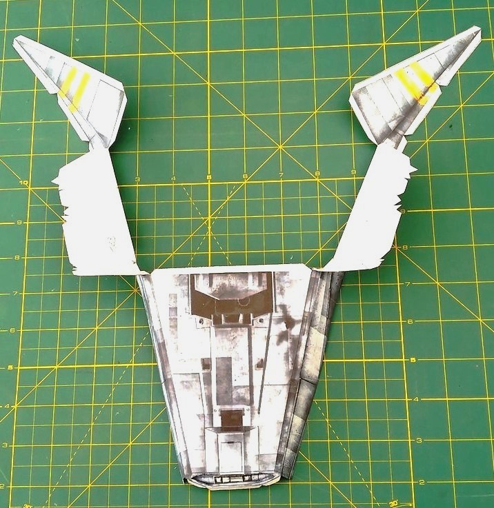

Upper body (Module 2).

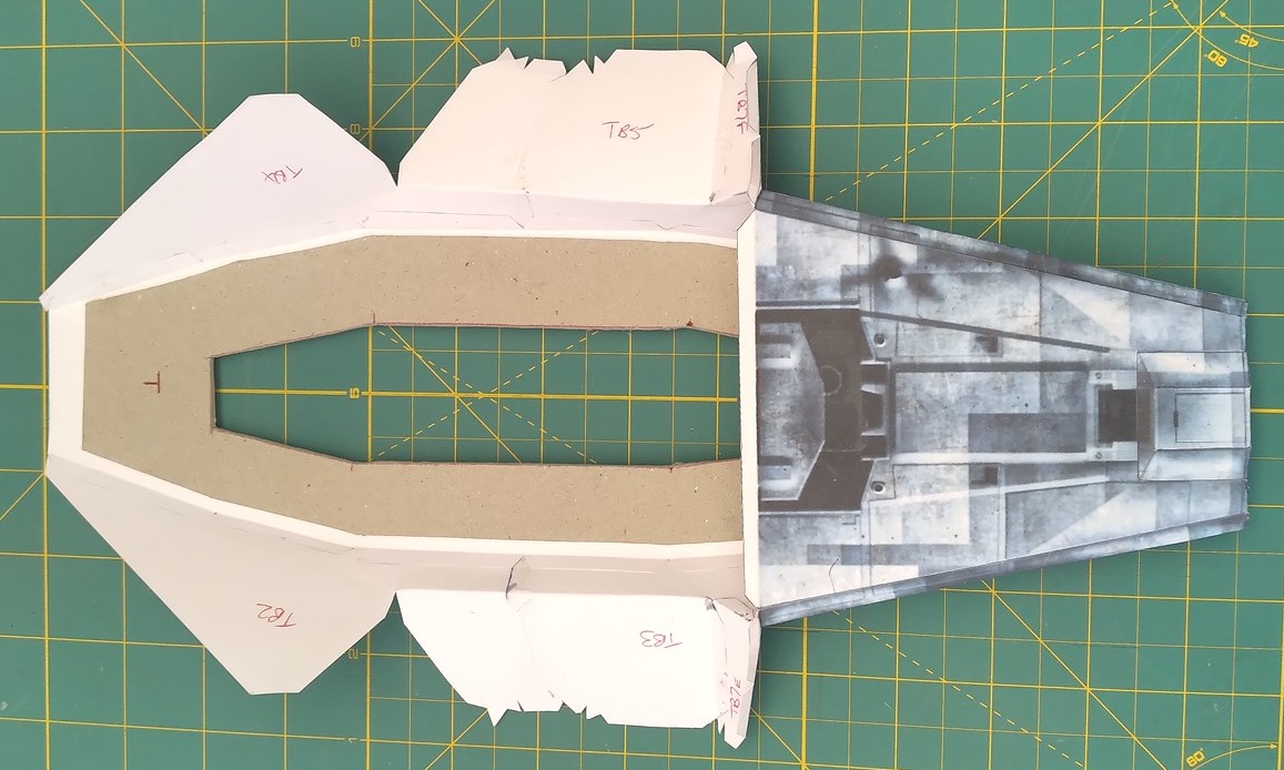

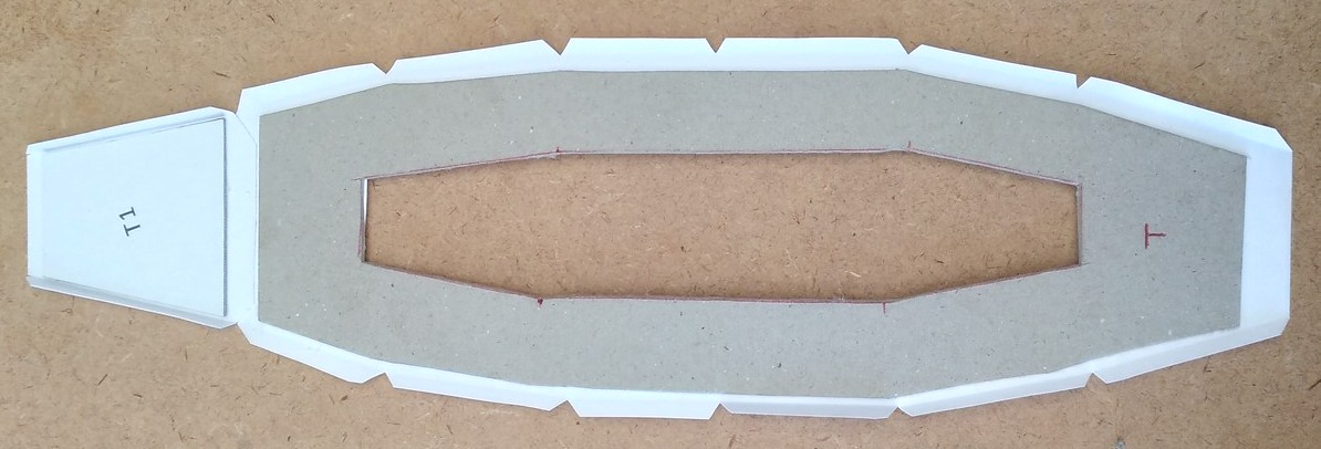

Attached T to T1 and then glue on the card stiffeners.

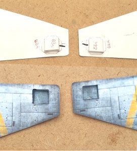

Join parts TB2 to TB3 and TB4 to TB5.
Add card stiffeners to these assemblies.

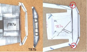

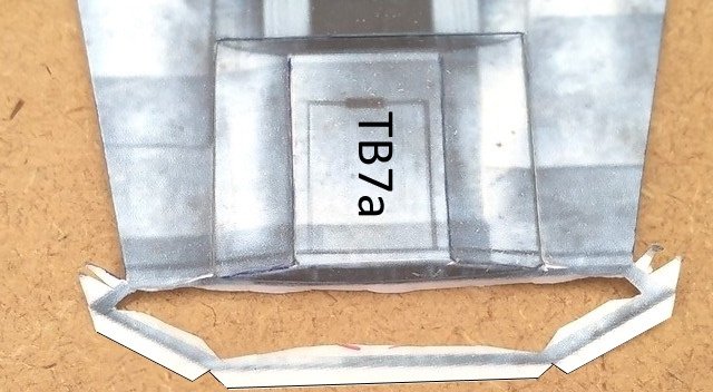

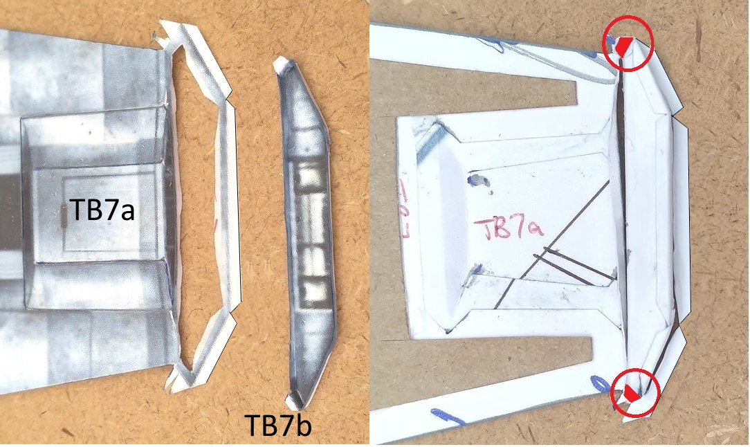

Construct part TB7a and attach to part TB7.
Construct part TB7b as shown.
Now, attach TB7b to part TB7 by initially gluing the tabs as shown in RED.
Wait until completely dry and then glue the rest of the tabs around the underneath of TB7b.

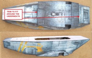

Attach TB7e to TB3 and then attach TB7.
Repeat for TB7f, TB5 & TB7.
Now attach this assembly to T1.
When dry, continue to attach this assembly to the base T, one tab at a time.

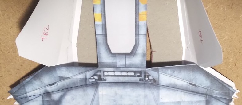

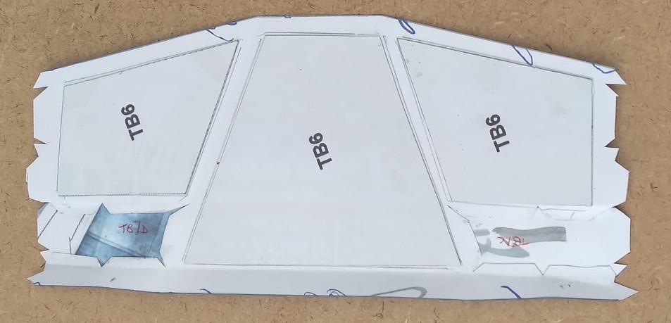

Attach pieces TB7c & TB7d to TB6 (Note the raised edges).
Attach card stiffeners to TB6 and then glue TB6 to TB7.
Glue TB6a to TB6 and when dry attach to TB2 & TB4.

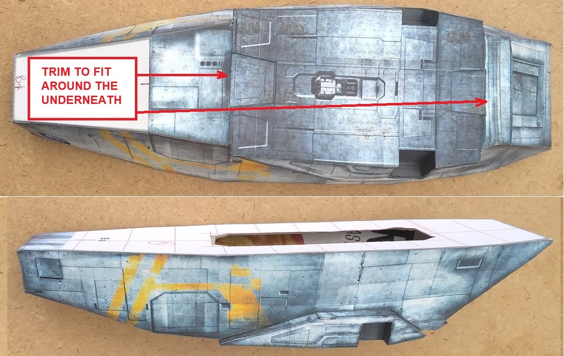

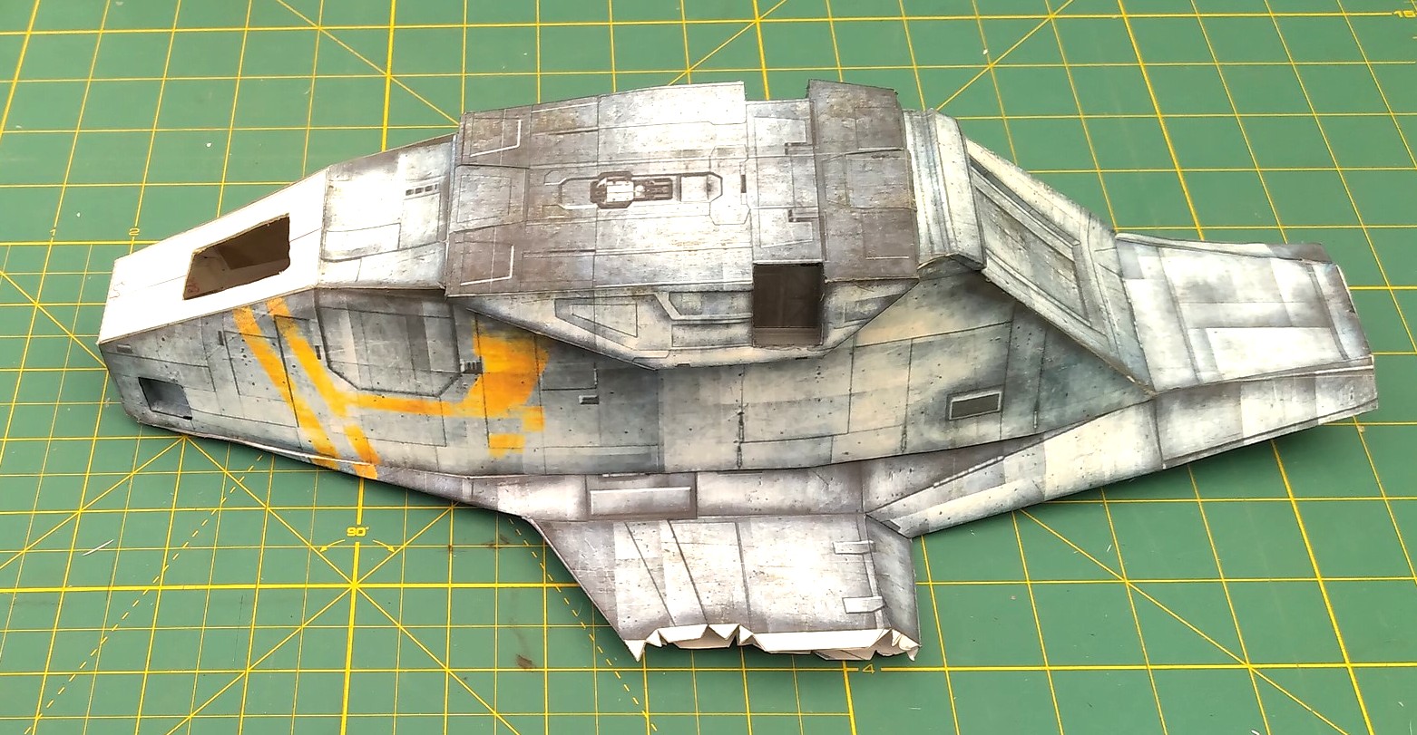

This completes module 2.

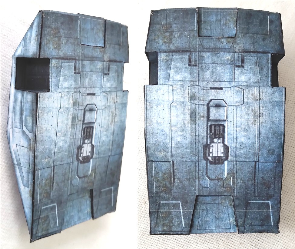

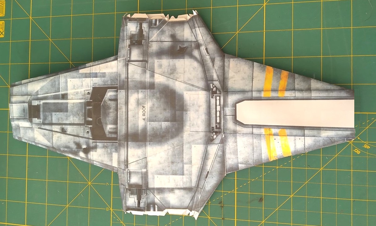

When dry, the two modules were joined together.
