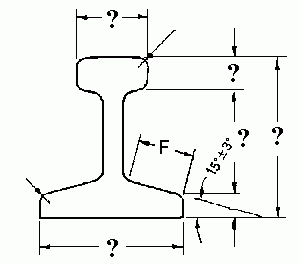

I am new on this forum and also new in modeling... I was searching internet for modeling informations and i decided to make my own HO model. Also i decided that i will create rails by myself (i have some people that profesionaly work with metal...).
I drow picture of the one rail ,so please could anyone edit this picture with dimensions of its parts.(high, widht eventualy lenght...). I found few days ago similar picture on the internet but now i can't finde it. :(

the measurements change from one rail size to another. What size are you trying to make?
Weightin pounds/yard: height in inches
72: 4-3/4"
85: 5-3/16"
90: 5-17/64"
100: 6"
112: 6-5/8"
115: 6-5/8"
130:
150:

But i still don't understand thoes mesures. what are all those numbers , specialy first (like 72:...?)
And i want to make model in HO scale (if this was your question about what size of railroad do i want to make)
The numbers (like 72) refer to pounds per yard, a common unit of rail measurement. The number after the colon (like 4-3/4") is the height (from top to bottom) of the height of the rail in inches, based on its weight. All of these are real-world measurements.
Not all railroad rail is the same size, or the same shape--older railroads used lighter rail, while modern rail is generally heavier. The shape of rail could vary, based on when and where the railroad ran.
