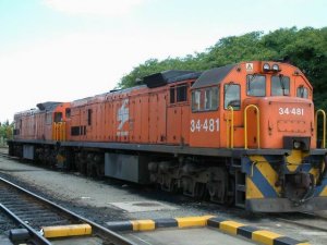

I've got one of the Frateschi locos, but I'm not too impressed with it - for a start, it's more like 1/76th scale, instead of 1/87, plus it's a U20C, which in South Africa was a class 33, and looked completely different (here's one http://www.locopage.net/sa33514voorbay.jpg) - the GE version of the class 34 was a U26C.
There are a few of our class 35s (EMD GT18MC) out your way now - I can't remember which operator they went to, but they look like a shorter version of the EMD 34.
