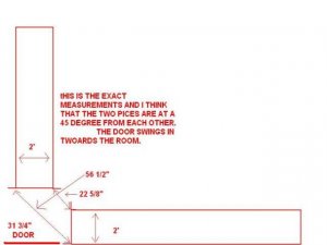

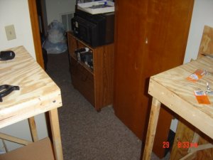

hey everyone, would anyone have any ideas on how would be the best way to go about building this lift/swing gate? whats really messin me up is that the two ends of the bench work are off set to each other, and im really not that smart when it comes to carpentry work, so any ideas or suggestions would be appreciated. thanks everyone!:confused:
How about a drawing that's as accurate as possible? The idea being that your mainline will have to approach the gap from the rear of either side. You may have to mitre the ends somewhat as well.
hello Shaygetz, here is a rough drawing of the benchwork and where i need to put a swing gate. the measurements are pretty much exact, but sorry about the sloppiness.:oops: thanks guys, this meens a lot to me!:wave:

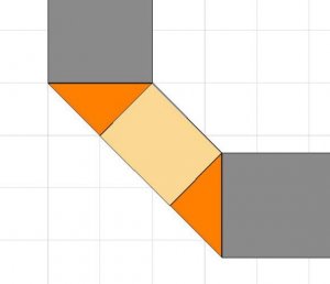

Hi Steve,
Looks like you were busy makin' yer bridge. I can see a few problems with your bridge the way you have made it. :confused:
The first thing I see is that you are hinging the bridge on a 45 degree angle. This will mean when the bridge is open it will stick out into the room.
Also I think it is on the large side. Once you get it covered with track and scenery, it's going to only weigh more, and could be un- wealdy and down right dangerous if it was to fall closed by accident.
Here is what I think you should do. Make 2 triangle extensions for the bench (orange on my plan) Then make your bridge square. This will make your tracks line up easier and the bridge wont be to heavy. When it opens, it will be out of the way.
Just what I think. :rolleyes:
TrainClown :wave:
