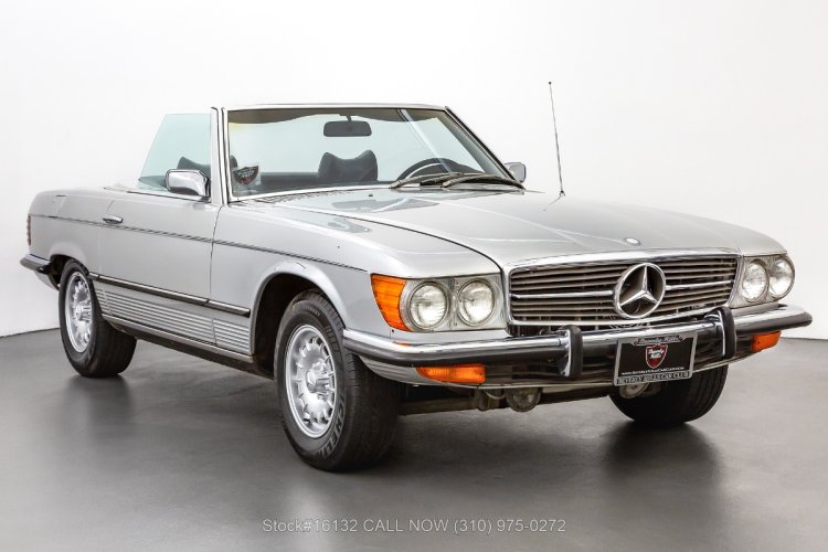

If you ever make it to the U.S., I have a 1973 1:1 scale Mercedes-Benz 450SL that is pretty far along. I have most of the repair parts, and all the tooling. I'm sure you could bang it out really quick. Needs paint, some rust work, I have the factory panels, and have done quite a few floors on these cars. I just imagine you could make mine so special!! I'd like it to look like this, but keep the original white lacquer finish and original red interior. It has the Magnesium wheels. Only 140K miles on it. I'm the 2nd owner. I can wholly understand the declination, though. :)
You're amusing! :lolsign:
