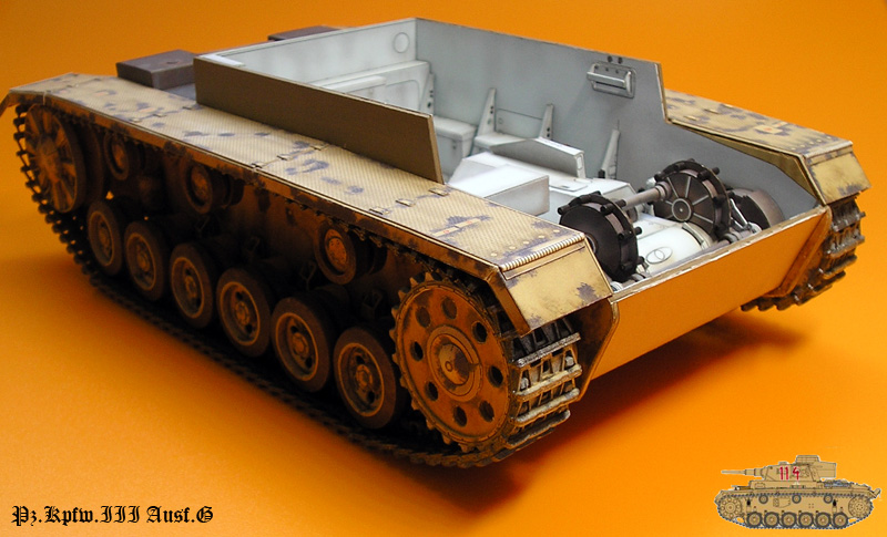

Pz.Kpfw.III Ausf.G (GPM 203)
Didn't give up :)

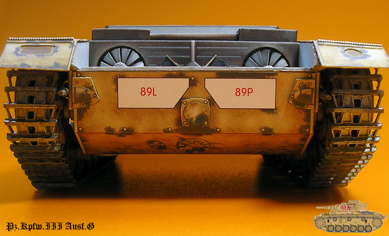

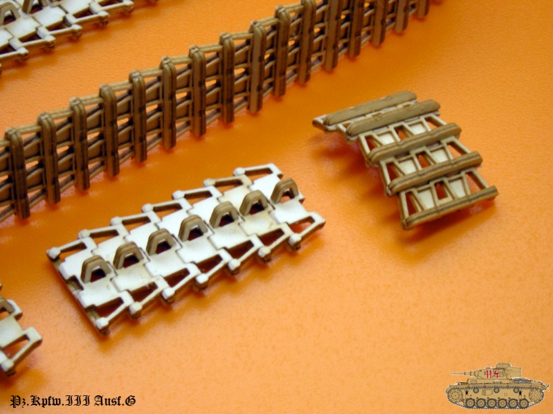

A little update

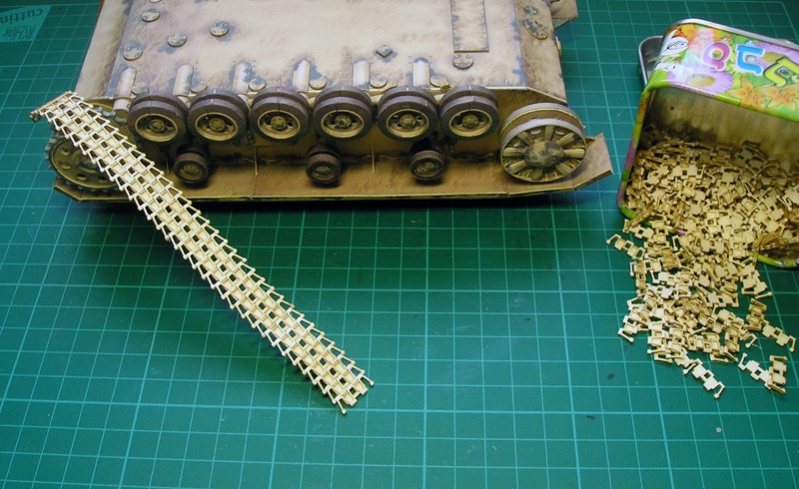

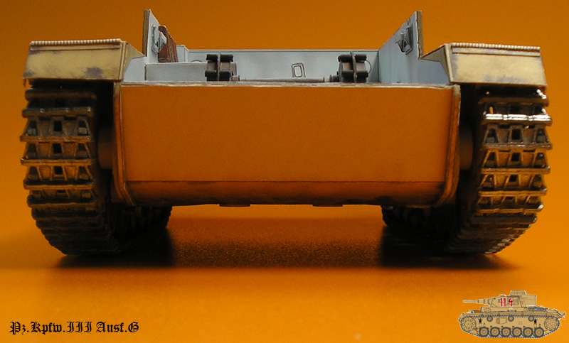

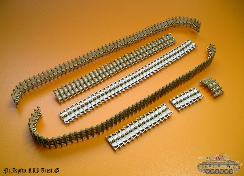

Tracks are done. I assembled them in chunks, for compfort join later on the wheels
Also made a spare strips to put them on front of the tank
I hope, untill the end of the week, to paint them with airbrush

Those tracks go well with the rest of this perfect model, perfect tracks, perfect model. Wow!! What a thing to accomplish!! I'm very happy for you :)
Thanks :)

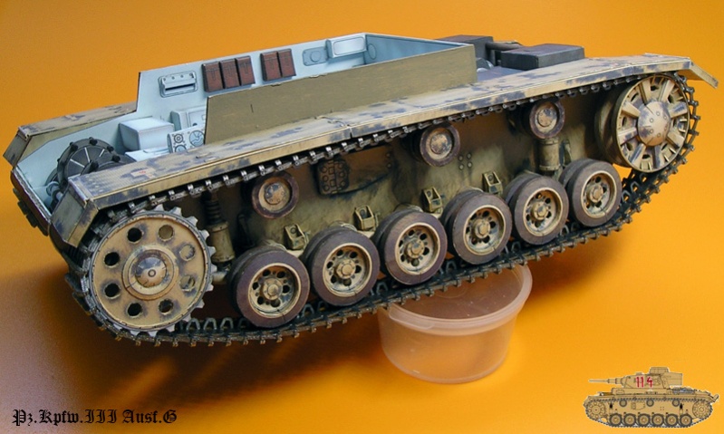

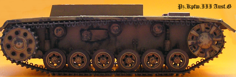

Traks are painted with airbrush. Color - Gun metal (Tamiya)
The mounting went well and now the tank have "shoes" :D

That has to be as near perfect as I have ever seen. The one photo that has two blank spaces on it looks like someone photoshopped those blanks spots onto a real tank chassis. Masterful work. Will you continue to build models? What does one do when they have reached a perfect state of their endeavor? I wonder what else you do perfectly? :)

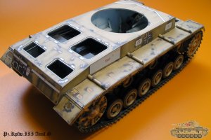

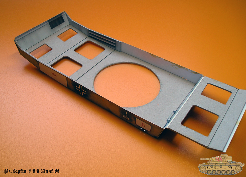

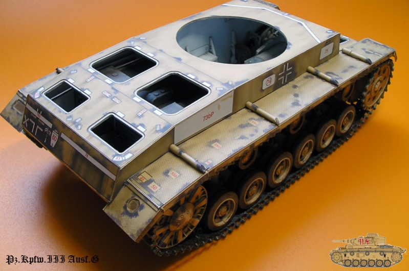

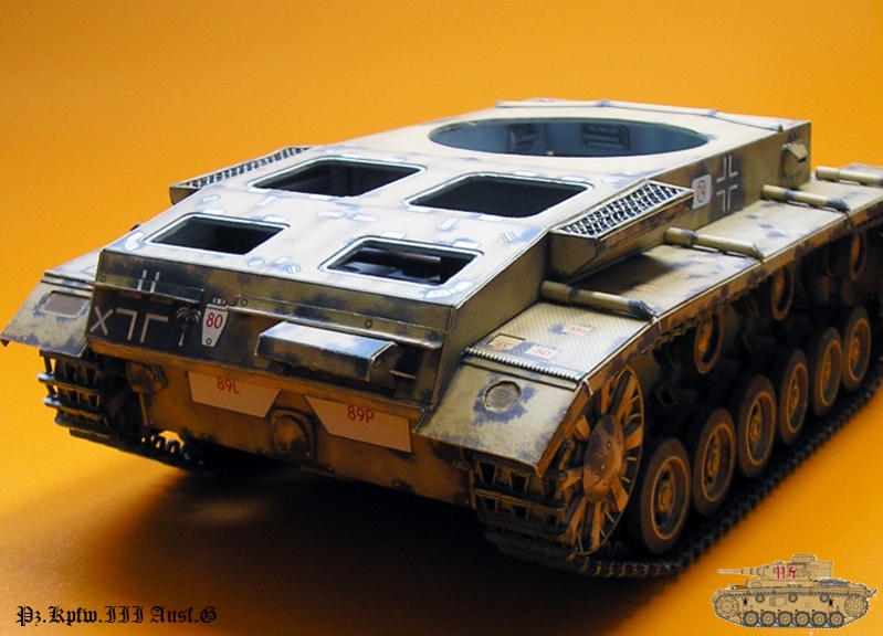

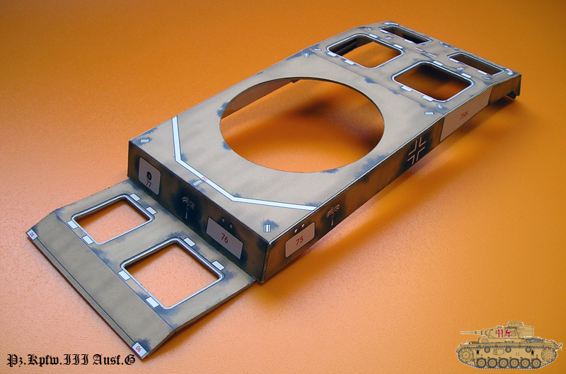

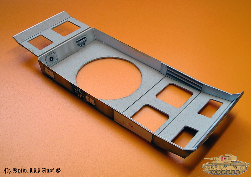

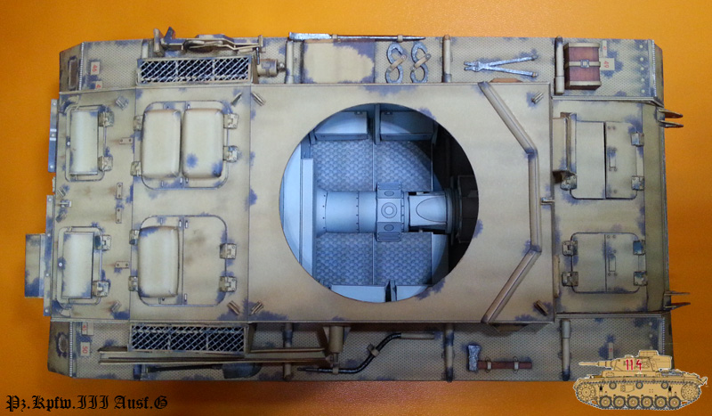

Finished the upper part of a body. As designer meant, I did it removable.
Inside I glued supporters and parts of inner hull. I made corrections to the front, by narrowing front part to match the width it inserts to. (removed about 1 mm from each side)
Also, at back I discovered a little gap between upper and lower parts. So I made a little two-side strip, to cover it.
Beside this, two parts connect perfectly and stay in place. Later, front towing hooks will work as locks.

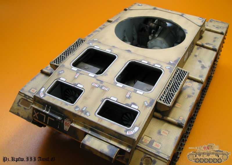

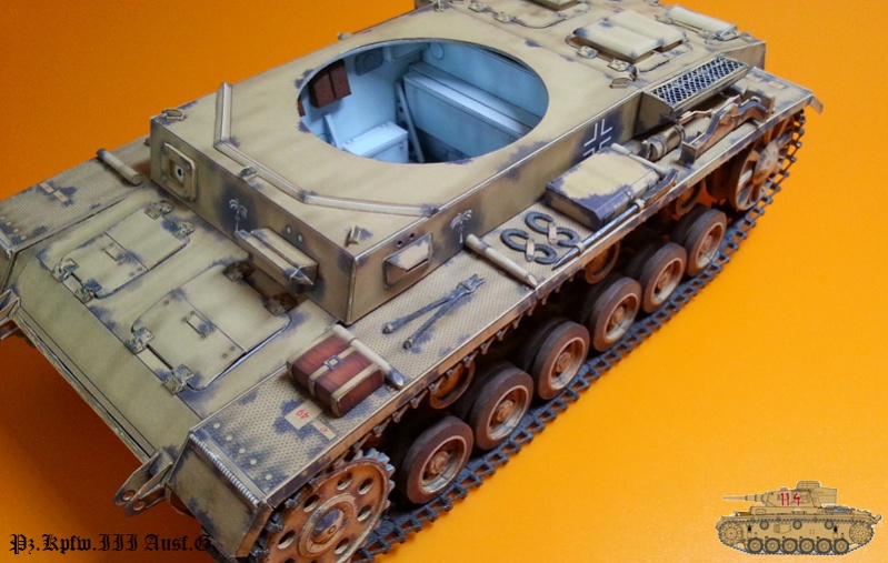

A little update

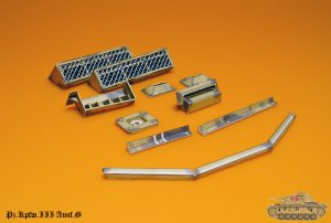

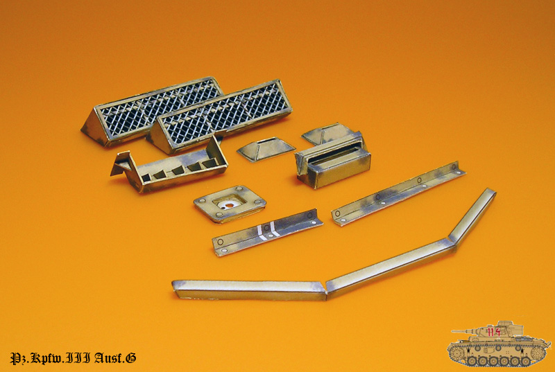

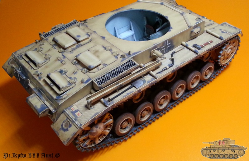

Made some parts: air takes, visors, gun plate and staff.
Painted grid on air takes was replaced with emulation from antimosquitoes grid
Everything glued in placed

Looks like you are approaching the home stretch. This is a beautiful model, excellently put together. :)

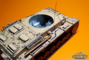

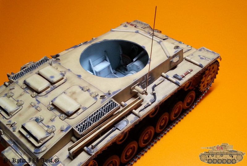

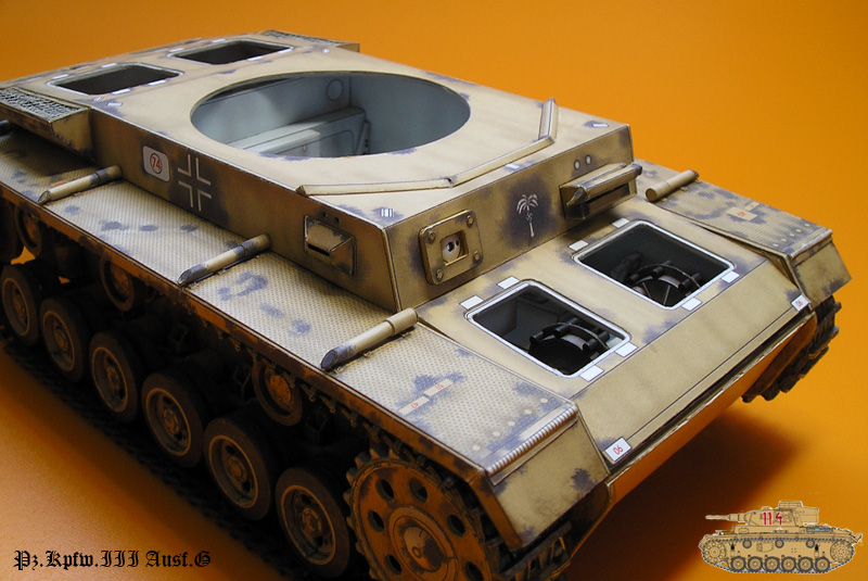

A little progress with the model
Made all the doors to hatches and attached them on moving axes
Also made some instrument to put on shelfs
The antenna can be raised up and down (not included in the kit ;) )

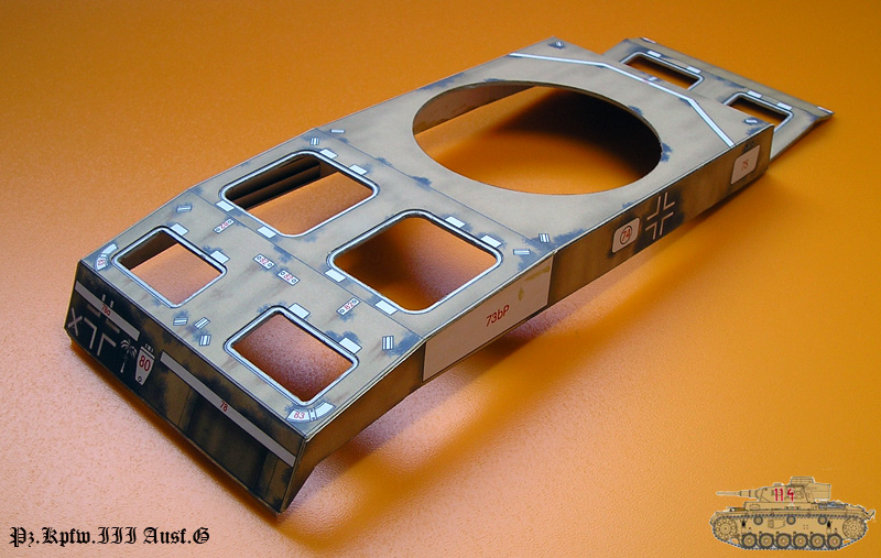

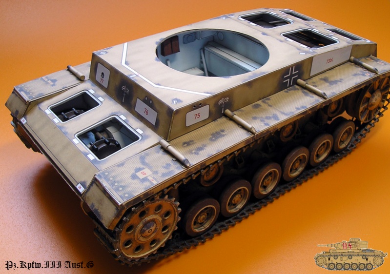

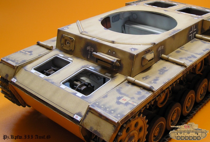

Meanwhile I assembled front armor plates
I advise to measure well and check if plates enter their place by width
I was in need to cut about 1 mm from each side and to adjust skins accordingly
Also, now upper removable part can be locked in front - from one side by base of tow hook, from the other by horizontal plate
