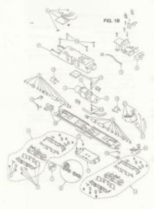

If the one schematic isn't clear enough e-mail me and I'll get a good copy to you.:wave:
