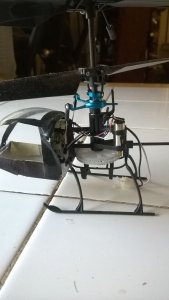

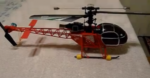

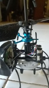

Anyway, here's some pics of the bird. :)

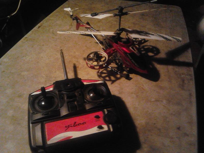

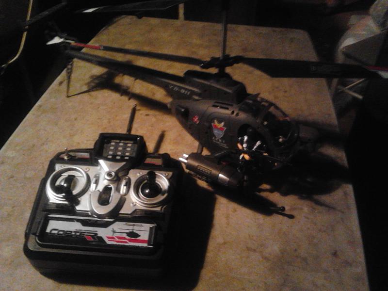

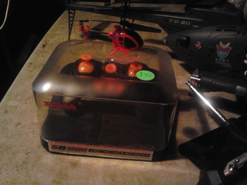

That looks like a very nice copter! Hope it flies perfect for you. I have not tried a single blade copter. I have been trying to fly co-axle blade versions myself. I heard they have a more stable flight, but they have problems outside with a little breeze. I have three sizes. Small one about four inches long, but flies great. Medium about 14 inches that I flew outside, which had the problem with wind. It has a fan on each side for fast side to side action. The last one is about 26 inches and has action figures. One is the pilot and the other sits on the passenger side with a m-16 rifle. I have not tried it yet due to bad weather. Good luck, and have fun zathros!
I just took some pictures of them so you could see what they look like. I have the most fun with the littlest one because I can fly it indoors. Again I hope you have a lot of fun with your copter!
You need one of those super still days, and a big wide open field, if you plant to get up to speed. The single rotor is a bit harder to fly, but probably only 10% harder, and that's only at first. It's the ones that also have a collective control that get interesting. there you set the throttle speed, and change the pitch to climb, and the cyclic to steer. This gives you and incredibly controllable helicopter though, and they can auto rotate from high altitude with no throttle, and land safely. They're expensive though. On one of my co-axials, I added the aluminum optional squash plate, and that made the copter so stable, as the squash bar is so rigid, the controls input it less, so it doesn't get out of shape. I am added crazy glue, the gel kind, behind the square battery plastic box, as they are not secured well, and I fried the board out of one of my copters because the header pin on that battery shorted on the inside, and most of these circuit boards aren't "diode" protected. The new circuit board was $24 bucks, but came complete with the two cyclic motors attached, and I id not want to lose the copter. I have taken the body off and made a bubble windshield. It kind of looks like the "M.A.S.H. copter. It took of a bit of weight, but I ant to put a Lego dude (maybe I'll make a paper one!!). I spent about 5 minutes doing this, which is why it is so crude. I plan to make a nicer one. I made the copter fly better though, not sure why? Setting it up again, a new board, and new squaash plate took some time,, but I was really able to dial t in and it flies superb. You can set it to a hover and if no one blows on it, it will stay still till the battery runs down, and it just goes straight down.in there, and run two batteries in parallel, so we'll see how I blow up this one! The blue piece is the new squash plate. This would fit on my single rotor. All these copters are coming from one company in China, and that's fine by me, because if spares are available cheap, and you can upgrade them, it makes them fun, as you can tinker with them. :)

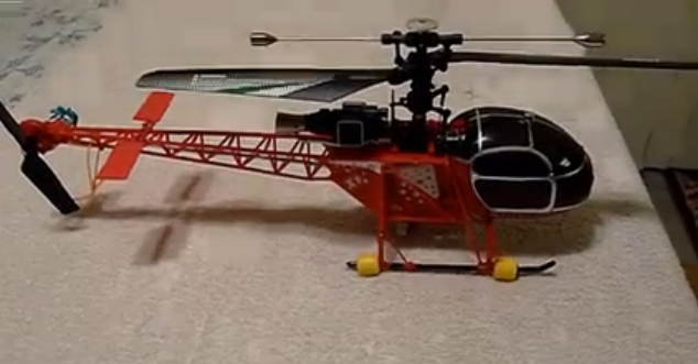

She does look like a MASH copter or maybe a LAMA copter (see pic). Did you have any problems with weight distribution? If I tried to modify one I would worry about knocking it out of balance. You know a lot about a lot of things, which I believe is great because people should never stop learning something new. I heard that if I put a bigger tail rotor motor and blade on my outside copters that it will change its angle of attack to where I can fight some of the wind. I could put a bigger blade on the tail, but it would burn up the tail rotor motor. Are you going to post pics of the copter after you modify it to look like a Bell Cobra copter?
