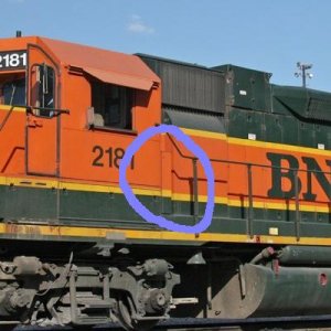

I also have 3 pieces i dont know where they go...i got a picture of them...

ECAFB 890228
It doesnt show where it goes, its inbetween the frame (bottom) and body (cover; top)
There is no arrow to show ehere it goes

from front to back, the big piece seems to be in the middle somewhere according to this picture lol
Unfortunately theres not a lot of detail concerning assembly in the two photo's. I'll do some more researching on the Atlas website.There must be someone out there in cyberland who has experience with this loco. It's a really common model.
Is the large piece in the upper right corner of your photo the air filter compartment that goes on the long hood, behind the firemans side of the cab? Which railroad is your model?
Heya Prodigy2K7,
The piece you circled near the top of the photo is the electrical cabinet air filter box (ECAFB) I think. If that's what it was, it goes behind the cab on the walkway on the fireman's side. Look at the photo I enclosed below (I circled the ECAFB).
The two black pieces are engine compartment vents. I don't think Bunsuf used those on their GP38s so you can leave them off.
As far as the plow goes, Atlas sometimes doesn't take into account the paint will make mounting holes smaller, which might be why the plow didn't fit. You might have to enlarge the mounting holes a bit for the plow to pop on.
Hope this helps, and I hope you enjoy your new Atlas engine! :thumb:

Yeah I think the ECAFB just gets glued to the shell via the posts that's on the box-- It's supposed to sit away from the body. That's why there are no mounting holes for it. In the future when you feel more confident, you can just put a spot of super glue on the standoffs on the ECAFB, and position it in place.
