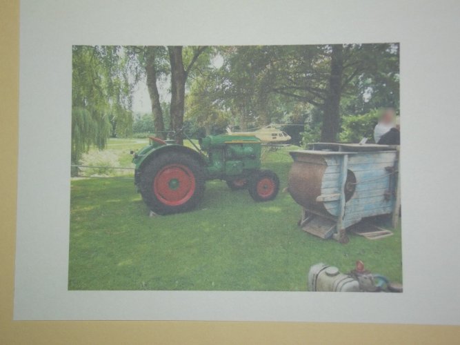

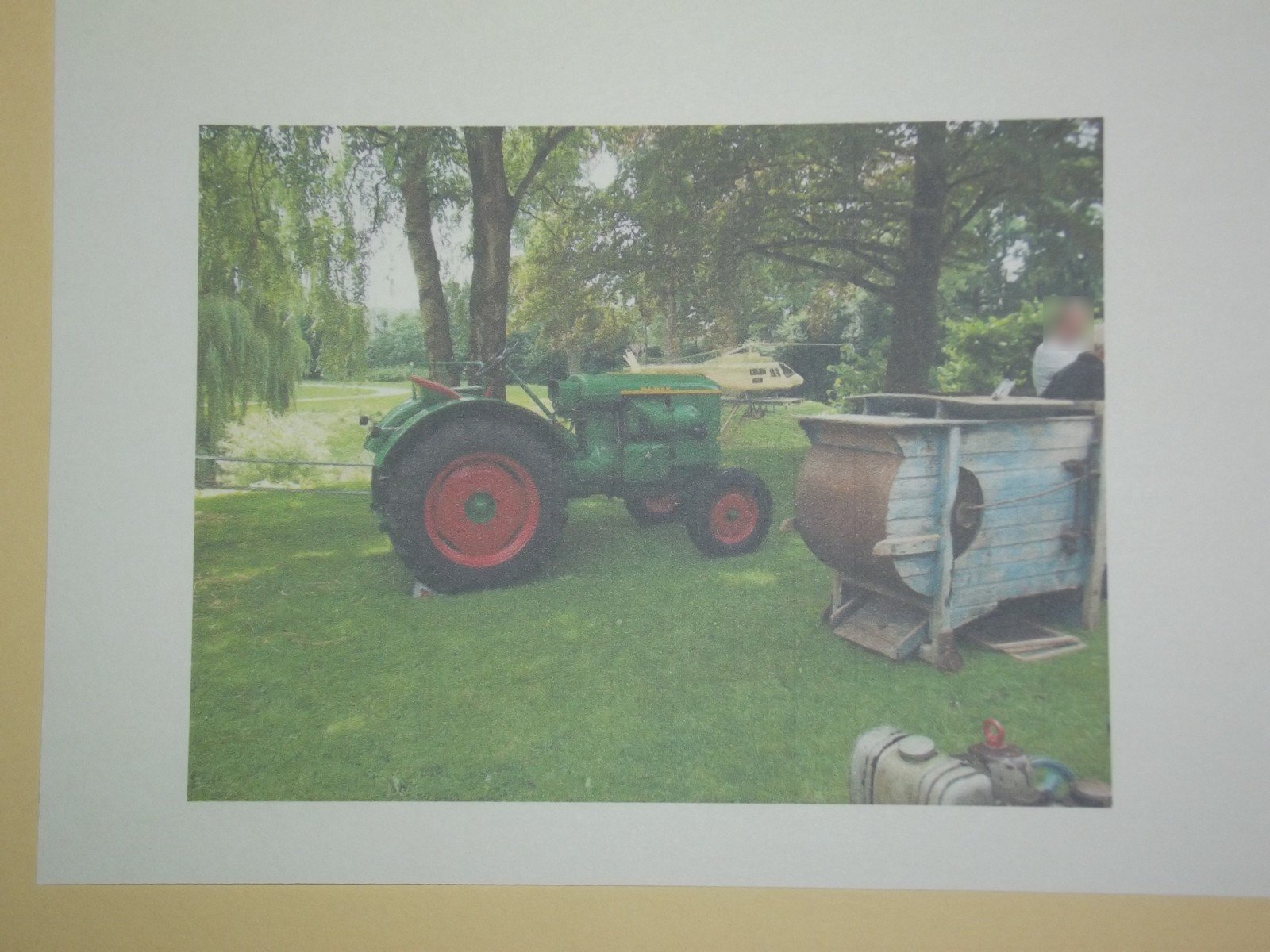

I once "inherited" a Canon printer. No idea what the cause was but it didn't print black, it would print grey instead. At first I thought it was defective but after some research on I found several different models - with exactly the same printing results. Seeing so many grey prints made me think this was the regular way a Canon prints. So I put it up on eBay, it got sold and the buyer was very happy. Strange things happen. :drinksmile:

This is a test print made with the Canon I mentioned above. As you can see, it is very - "light" on black. :noteeth:
