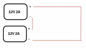

If I have a power supply setup as shown here - 2, 12V 2A power supplies in series powering a bus around my layout to feed DC needs... Do I have 2amps or 4amps?

your drawing will give you 24V you need to put the the power supplies in parallel you have them in series.as far as a cheep high amp power supply look to a battery charger:) other than try ebay i saw a 40 amp 12V surplus one at buy it now for 25$ a while back.
Jim is right on both points. Your series hookup will give you 24 volts at 2 amps. If you want 12 volts at 4 amps you have to parallel them...but...you've got to be really careful because if the voltages don't match exactly, one will attempt to carry the load and the other will just coast adding to the load rather than supplying current to it.
And you can use a battery charger to supply the current you need, but you might want to filter it a bit because they are fairly nasty and "dirty". Batteries don't care about unfiltered DC for charging, tortise machines and other electronics probably do.

jim currie said:
your right Don i should have mentioned that a large filter cap. is needed on the charger out puts as most of them are only half wave rectifiers.
That's true, and of course, the higher the current drain, the bigger the filter capacitor you need. I had several lab power supplies to do electronic testing with, but needed a bigger supply for testing light display systems. I got my battery charger out and put a 22,000 mfd cap across the output before it would give me clean DC at around 10 amps. Now that's a physically large cap and you won't find something like that at Radio Shack.
As suggested, using several smaller supplies might be the best answer.
Thanks all. I've since been educated that my calculations are off. When wired in series you don't sum up the amperage as I did. That means my amperage needs are far less than I thought (about 2 amps to run the whole schmear), which decomplicates power notably. I found a nice little adjustable voltage 2-amp power supply for $20, and will probably pick up two and divvy up the layout into two "accessory power" districts.
