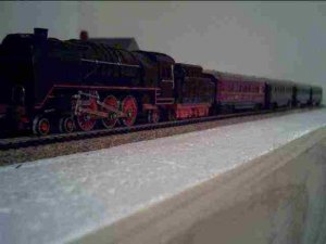

Some time back I was given a Marklin train, a model of a Danish Railways Class 1 4-6-2 with several tinplate freight and passenger cars. I'm feeling pretty safe in assuming that it was made around 1950-54. I was in the process of cleaning it when I remembered that Germany uses 220 volt electric. They also run on their trains on AC, not DC. What I need to know is, can they be run off of a Lionel transformer since Lionel also runs on AC? Is there any way to "step down" a Marklin transformer to run on 110 volt? The set came with 3 original transformers, 2 appear to be just this side of pristine, 1 appears to have fallen victim to some modifying already. Any help is greatly appreciated.

Thanks for the information. I'm starting to redesign the Christmas layout for next year to include a separate loop for the Marklin and I want to make sure it runs. I'll be running it at train shows too, if at all possible. You've seen it in the "Your Oldest Loco" thread in the HO forum, in fact, you identified the "DNR" for me...:thumb:
