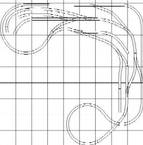

Attached is a rough drawing of my intended layout each square is 1 foot. Thanks for any clearification you can provide before I make this investment.
Regards,
Gosh... what a crappy picture this is :( but you get the idea.

One last note about your track plan. It appears you have reverse loops at each turnback curve. Gap both rails at each end of both turnback curves, at least a train length long. connect the rails to the output of a reversing module, an extra I didn't mention above. The input of the module gets connected to the rail output of the DCC booster, or bus wire. This allows those crossovers to not be reverse blocks themselves, in other words the north rail of all trackage will be one polarity, the south rail the other. This is a bit different than what DC'ers are used to. I, or someone else, can explain this further if needed.You may want to read the Big book of DCC or similar material, it will help clear things up for you.
