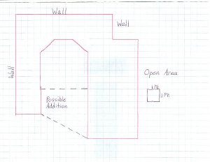

Hi. I have been reading this forum for over a year, and I have finally built my benchwork in my available space. It is an "L" shaped layout, with a 4x8 plywood table at one end, which forms a penninsula that is reachable from both sides. Each section of the "L" is 8 ft long and 2ft wide.
I am modeling HO scale. It will be late steam/early diesel era, set in eastern Ohio. The primary RR will be Pennsylvania. It is not a proto-type. I just want something that is fun to run. I want it to be both DC and DCC. I would like some continuous running along with some switching.
I want a coal mine somewhere on the layout, along with a tunnel and a bridge. Other than that, I really have no idea. The layout is a plywood base, with 2 inch foam on top of that. I will be the primary controler, but eventually my 1 yr old son will as well. Any help would be greatly appreciated. Thanks for reading!
Can you draw up a sketch of what the benchwork looks like? Even something in MS Paint (save as a jpg) will do.

I have tried to post a drawing of my benchwork, but the file is too large, and will not post. I am not very computer savy, so I do not know how to resize the image. I can email it to anybody who is interested. Any and all help is greatly appreciated.
As to what I want to run, I just want to run mainly coal trains and some freight trains as well. I do have a few passenger cars as well. Like I said before, I am not all that concerned about true prototypical railroads. However, I do not want some kiddie looking layout either. I guess I would like it to look as realistic as possible, but still be easy to run.
By the way, I have enclosed the open end of my benchwork, so it now looks similar to a big "O" shape. It is now a duckunder, and I have no problem with that. Again, if anybody would be willing to look at it and give me some help with the layout design, please post your email address, and I wil email you the drawing of the benchwork. Thanks!

Benchwork Drawing
Here is a drawing of my benchwork. I have added the possible addition section. A big thanks goes to Nazgul for resizing the picture for me!

It could be tempting to add that additional section to get more realestate for your railroad, but then you would have a fairly wide duckunder. I would suggest a relatively narrow draw or swing bridge to cross that opening either one or two tracks wide. That would give you a continuous run without needing a turnback loop allowing for a larger minimum radius, but much easier access to the operator's pit.
From the look of that diagram, it appears that you're going to have a loop (for continuous running) on the larger table section, with a branch line running out to the left? It looks like you have made sure that no point is farther than about 30" from the edge of the table--smart move.

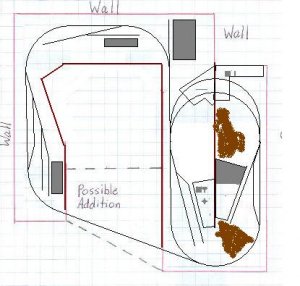

Let me give it some thought--there are some neat tricks to do coal mining railroads that will allow you to pull full coal loads out of the mine and put them inside of the powerplant at the other end of the line, then pull empties out of the powerplant and carry them back to the mine (basically, by having a tunnel between the two.) The branch line could be a line to a nearby city with lots of switching, or a division-point yard. Hm.
Jetrock, I like those ideas you have. I would like to see what type of a track plan that you could come up with. (Whenever you get the time):-D Again, thanks for any and all ideas. Like I said before, I am new to this, and I have never built my own layout before. I definitely want to have my track plan ready BEFORE I start laying any track. Thanks!
Something like this. Scale isn't exact (I did it in mspaint) but it should work out using 18-22" radius curves and #4 switches.
The 4x8 loop on the right features a scenic divider down the middle. Double-tracking the northward loop gives you in & out tracks for traffic going through the mine/powerplant. The portion on the right side of the divider is the mine, in a more mountainous area. Coal trains start from the mine, passing through the industrial trackage and around the curve--this would be a good place for a mountainous cut, although a tunnel would be possible (but hard to justify unless it's a big view-blocking hill.) The train comes out of the cut into a more industrial area with more switching trackage, and ends up at the powerplant, where the coal can be dropped off. Trains, including some of the coal and the cars picked up at the industrial sites, can continue to the left through more territory--personally my tastes lean towards lots of peddler switching, but you could certainly get rid of some of the switching areas if you prefer more mainline running. Things end up at the division point yard/interchange area on the left--here trains can be broken up, with outbound traffic left on an interchange track. The optional connector can be a very long bridge on a swing-out (to avoid duck-under-itis of the headbone.) Note that this return across the bridge makes a reverse loop, and it will have to be wired as such, but it provides an easy way to get your locomotives back to the starting point at the coal mine to begin the whole process--and your coal train (with full coal cars) will be sitting in the coal mine waiting to be extracted again!
Hmmm...on second thought, the two switching areas on the 4x8 section (to the right) should be reversed, so there is a runaround to let you spot the coal hoppers into the powerplant spurs.
You've really pretty much hobbled yourself by building your benchwork before having a track plan.
It looks to me like you have an 11' x 12' area with a notch out of the upper right corner. You could have had a water-wings style layout that would permit larger-radius curves, and areas for switching and scenery.
The benchwork you have now really limits you to the sort of plan that Jetrock has drawn you. How attached are you to your benchwork? ;)

Unfortunately, I am stuck with the benchwork that I currently have. This is the only space that I CURRENTLY have, although I should be able to expand sometime in the future off of the 4 x 8 table, near the notched area.
