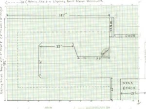

Time to start planning my new layout in On30.
I am posting my room and existing benchworkas a Jumping off point.
While i can change the benchwork,it would be nice to be able to use it for several reasons(not the least of which is the amount of work it will save)
I have a shelf above the benchwork which has Lighting installed and is lacking only the Fascia to be complete.
This is also about as much square footage as I can use in a practical sense.I could add a drop leaf to complete a Loop if it were advantageous.

Heres the room layout and benchwork dimensions for anyone that want 's to take a crack at helping me develop a plan.I know how much some of ya'll like the challenge trackplanning presents.:)
I'm in the beginning stages here and am open to any and all suggestions and will look at anything anybody wants to submit here.

Lets try that room layout again

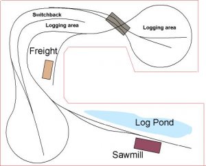

I like the switchback as this will add nicely to operating. I am presuming that will be quite the grade from the switchback to the logging area. You even have room for a mine if you wish. Does the track that goes to the sawmill extend to an imaginary main line interchange so finished lumber can be shipped?
Robin, this is as sent by Paul. Ive been looking it over and would like to see a couple of things happen here.
Now, I have an area( if you look at my initial room plan) past the log pond that I can extend the benchwork aroun 4.5 feet.This opens up a couple of options for that area.

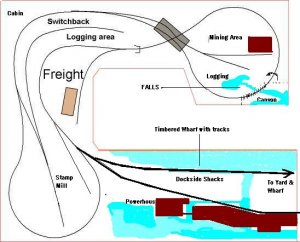

Heres a bit of scribbling ive done to give an idea where i'm headed.
Comments and suggestions welcome!!
Please, i'm out of my element here!!! Going From N 1950's to Narrow gauge large scale 1900's Logging/mining is like serious culture shock LOL!!! :D :D :D

Still Working :wave:
All of this is rough in of course and needs to be Drawn to exact scale on Graph Paper.Sure wish i was good at 3 dimensional drawing.

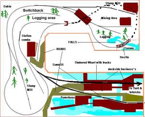

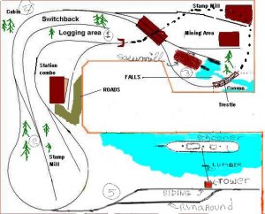

Here's what I'm thinking, Cut logs are loaded at the logging area (1), taken by switchback down(2) to saw mill (3).
Cut lumber is loaded on flats at the saw mill, switchback up through "cabin" (4) to tower siding (5). cut lumber is transfered by span wire from flat cars to anchored schooner.
You could have one loco take the log loads down to the mill, and return to the logging area, and a different loco take the cut lumber from the mill up to the tower for transfer.
If I had the room, I'd be building this right now. Of course, you have to understand, I like sailing ships, specially schooners.
Pete

Its a cool idea for sure.But it means i need to go with a much smaller mill complex than i had in mind. I really want the sawmill complex to be fairly massive, enough to justify a railroad.Also, while I would have liked to add a stamp mill, i had a friend point out that even a small stamp mill was huge.He suggested just bringing ore to the wharf and loading into barges.Now, I do have an area behind the sawmill complex like i said. I am going to extend the wharf to this area I believe.I could get a schooner in there and load like that.It is a cool Idea. the area i have has 5' 3" and then of course another 3' or so of return along the L shaped work bench. This gives me enough room to have a schooner set out a bit.I could have a stockpiled lumber area near the RR yard and the tower and rigging platform.
This isnt going to be an all logging line.It will also deal with a Copper mine.
I do like the idea and will try to incorporate it into the area where my workbench is.It will be the last area to be completed for obvious reasons :)
What I drew was only to clarify my comments, and not to any proportions. Bigger, smaller, rearranged, not used?, that's your choice. The lumber ship option was a Pacific Northwest thing, I have no idea if it was used anywhere else....but then, this is On30, and fair game for freelancing.

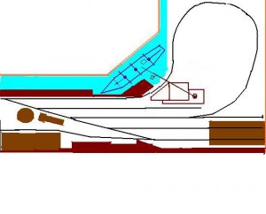

I like the Idea!! In fact ,I drew out the workbench area in preliminary form and included it.This isnt likely exact on tracklayout etc but it gives an idea what i would like to do :)
At the very least it shows the extra area that I have refered to that isnt shown on the main Benchwork.
I'm not even sure I have room to pull off the retun loop.Threw it in there anyways :D
