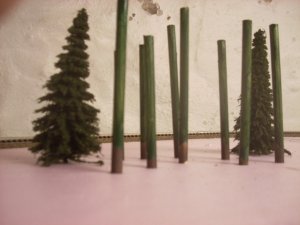

Here is what my dowel project has came up like so far, just need the foliage. Any ideas for what to use?​
