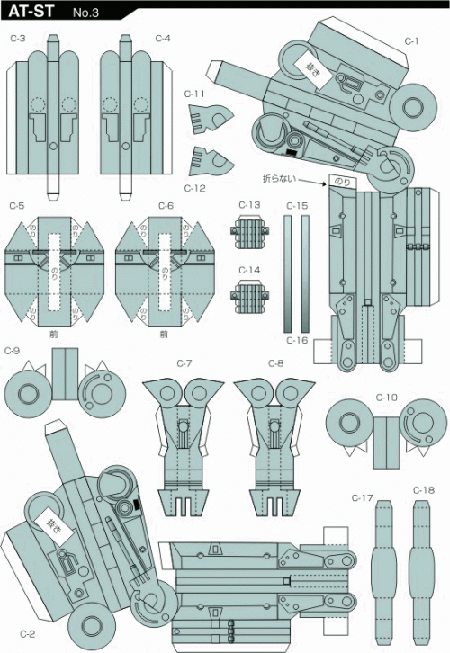

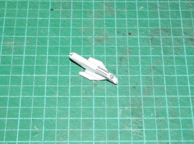

Christmas is coming and with it the need to pick a new subject for my Star Wars friend. My original plan was to make Shunichi Makino's A-Wing. However, I have no idea how to tackle the canopy glass. The experience with the Aston Martin showed that the most flexible sheet I have at hand would not be useful for that. So I postponed the idea till I have found a practicable solution. As a result a different model must be made. My choice fell on Shunichi's AT-ST:
It looks good, proportions are nice, the detail is crisp and is pretty easy to make. A few things must be changed of course, e. g. the view ports must be opened. That mod alone makes a HUGE difference.
However, when I studied the plans I found a few other things which might benefit from a small tweak. The feet stand out in a very strange way. I wanted to change that and started looking for other AT-ST models to see how other creators dealt with them.

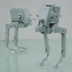

Much to my surprise the AT-ST is pretty popular with papercrafters. There are several different versions by different creators in various sizes and with varying levels of detail.
Shunichi's model is one of the oldest ones available. It is 20 years old and unfortunately it shows. I would have liked to see him revisit this old war daggit but, ah well.

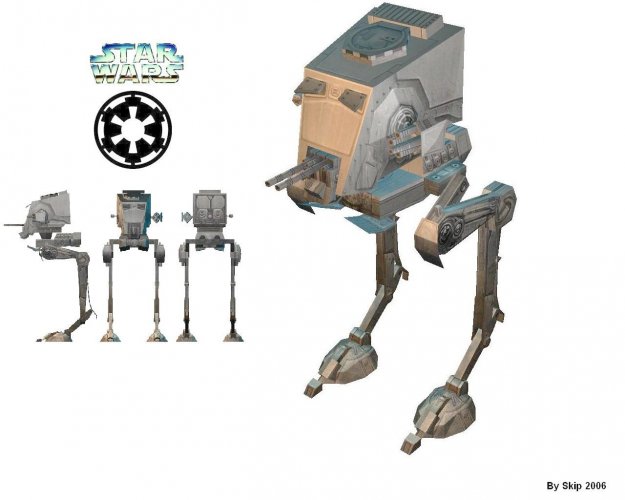

The next model was made by skip in 2006:
If you look closely you can see that the feet of this model look much nicer. This spawned the idea to combine the two to get a more authentic one. However, there are even more AT-STs out there.

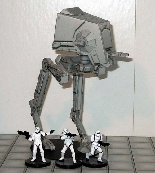

This is a very nice model for gaming made by momirfarooq. The feet of this one are even nicer but other parts are fairly simplistic.

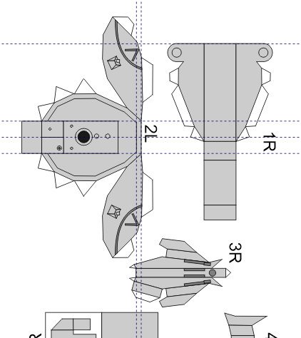

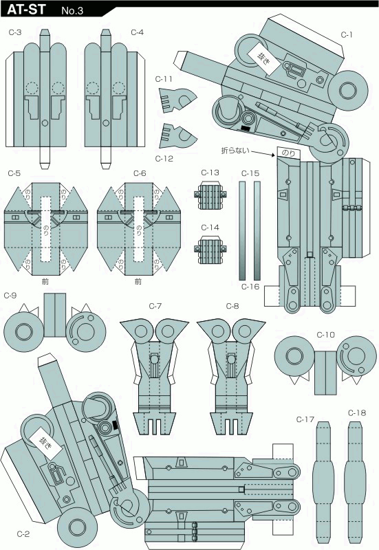

So I went ahead and imported the PDF into Corel. Everything opened just fine. :)
The first thing I did was to change the colour of all parts. The model comes with a blueish-greenish tint. I switched everything to 20% black (= light grey).
Some of you may certainly wonder why I did not use UHU02's model and simply build that one. The answer is simple: It is way too complex to make in the short time frame I have available. In addition, UHU's version is the AT-ST from "Empire Strikes Back". I am going for the "Return of the Jedi" version. Both models share the same characteristics but their proportions are completely different. I will however port over UHU's cockpit interior. This is well hidden inside the vehicle, so it won't matter much if it is distorted a bit. ;)

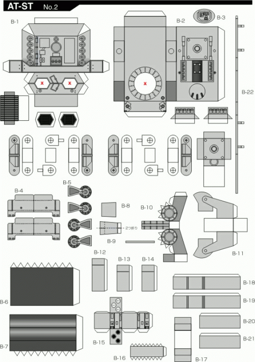

This build revealed several of the model's original shortcomings. Something I would never have guessed and for a short moment I questioned my choice to have chosen Shunichi's model. However, it is the only model I know of that is already vectorised and can be tweaked in an elegant way. With growing doubts in my mind I swang into action.

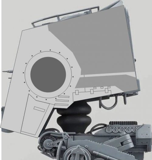

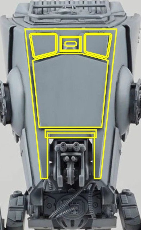

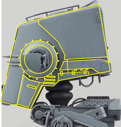

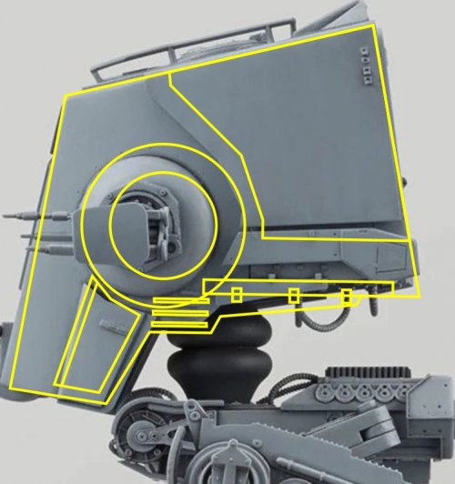

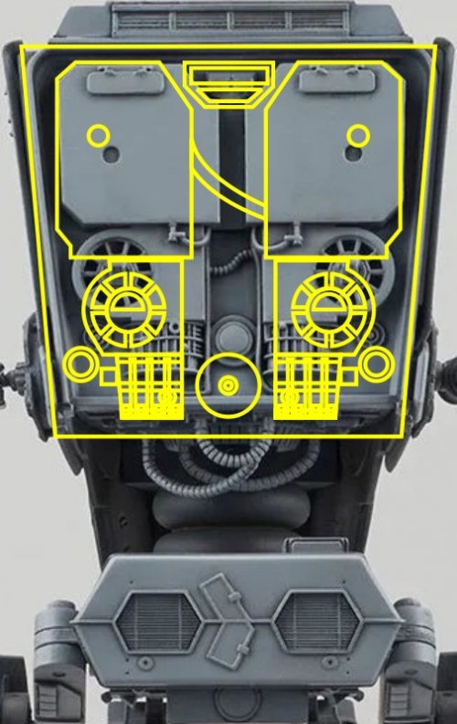

There are several great shots of the Bandai model all over the web. Among them are straight-on views of all sides. This proved invaluable because I was able to use them as a template to redraw the lines and refine the overall shape of the parts without having to build up a 3D model from scratch. And this is where it became blatantly obvious that Shunichi's model was not as perfect as I initially thought it to be!
The yellow lines show the unaltered template layed over a picture of the Bandai model. Whereas the front view does not look too bad
the side view and especially
the rear view show how off the proportions are.
A few hours later the template looked like this:
With colour:
All changes at once:
I was really shocked to see such a big difference. And this was just the beginning! :)

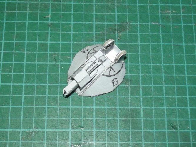

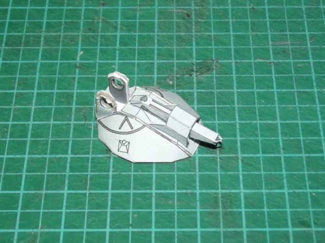

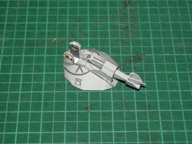

The mouth gun was slimmed down to compensate for the revised head shape. The cheek guns are still a WIP.

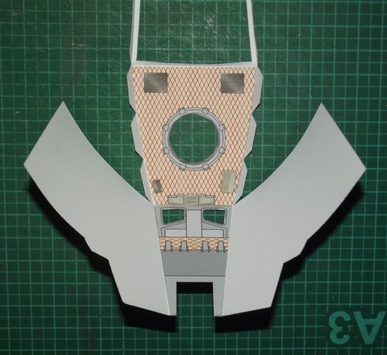

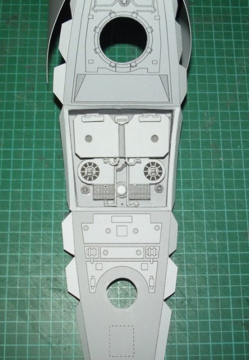

The back of the head is one of the areas which needed improvement. It was recessed and received a series of laminated parts:
All components were laminted to 1mm card.
Basically there is no need to conceal the edges if you use grey card. Most of them won't be visible on the finished part (unless you look at it closely, of course ;) ).

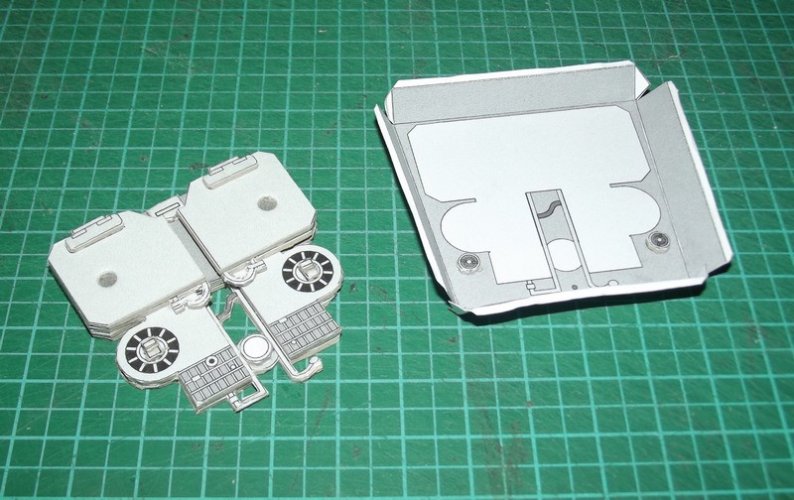

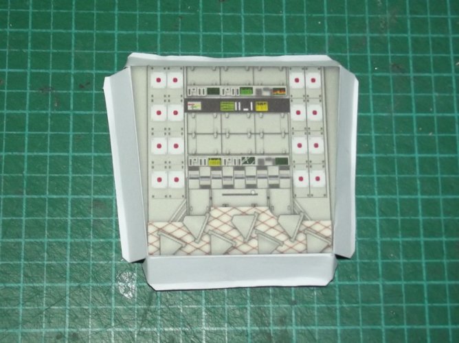

The back side of the cockpit interior from UHU02's kit was glued to the reverse side of the back of the head. I resized and stretched the image to make it fit.
The back was installed.

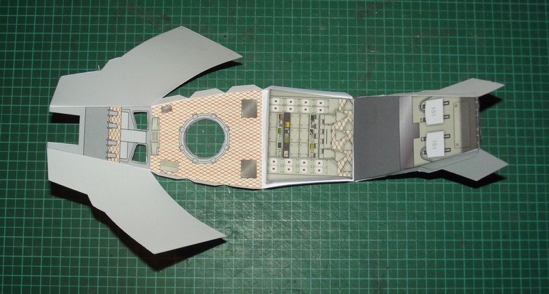

The front and top of the interior were glued to the inside of the head. This is a combination of rebuild and re-use of UHU02's walker interior. The hatch ring was copied from the top of Shunichi's head. As you can see it is a bit bigger than the hole. I painted the white area grey and resized the ring on the final plans to make it fit. You will never see anything of the fix on the finished model. ;)
The neck tube was installed. Here I followed a technique I learned from Julius Perdana. The tube is pushed through the hole and the tabs are glued to the inside of the head. A view from the outside:
Another part from UHU02's AT-ST was laminated to the floor of the interior. It conceals the hole for the neck tube and its flaps. The graphics might be changed because I think the seat positions are too close to the front. We'll get back to it later.
The head remains in this open state for the time being. I need it as a mockup to check the size and position of the other parts of the model.

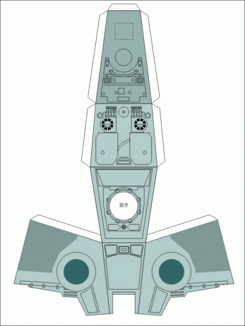

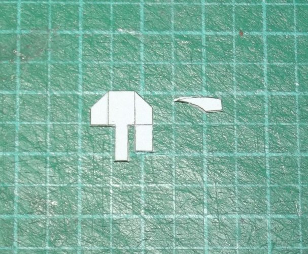

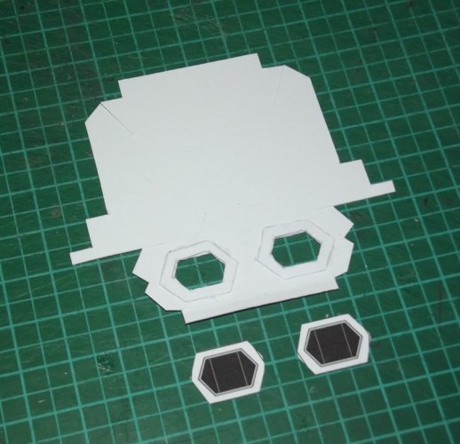

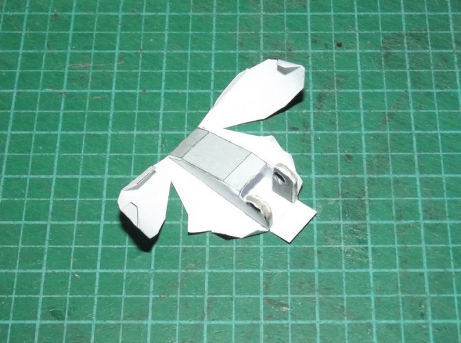

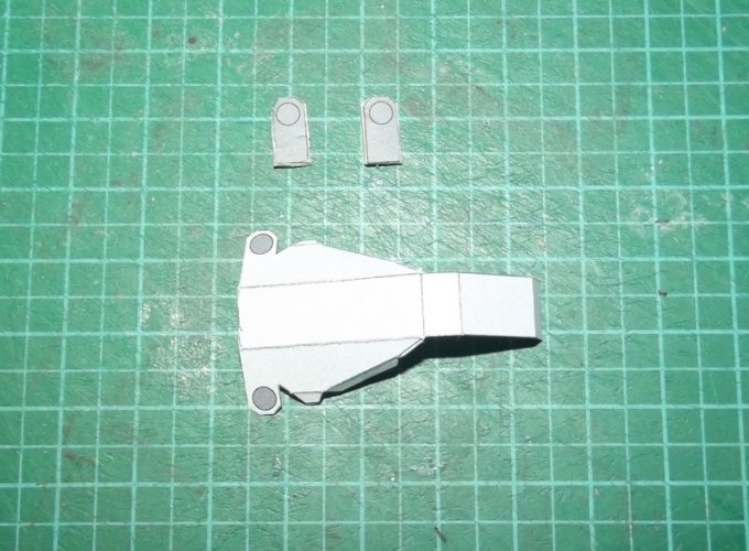

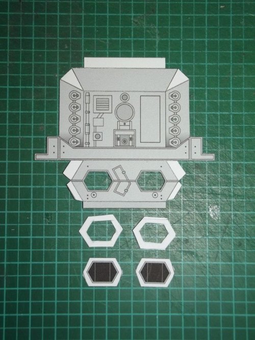

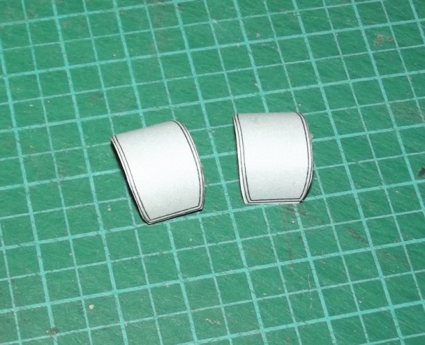

The "eye lids" are made of three basic parts:
Due to a logic error (I mirrored already mirrored parts :hammerhead:) I had more parts for one lid and too few parts for the other. I put them to good use and used them for laminations. In the end I found these extra parts necessary for the overall look so the final plans will have twice the amount of lid parts. Sorry, no picture of the finished eyes yet because I'll need to print the missing parts for the other lid. ;)

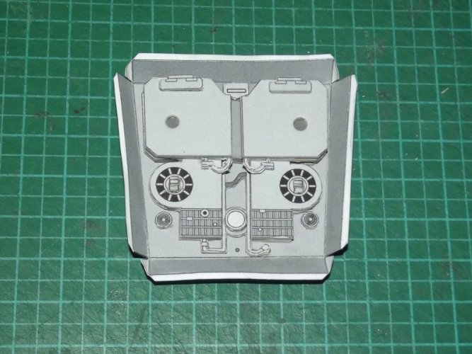

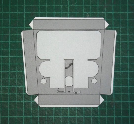

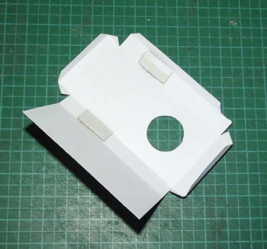

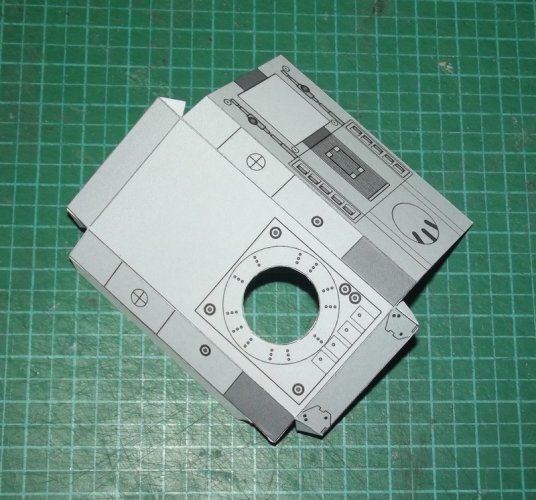

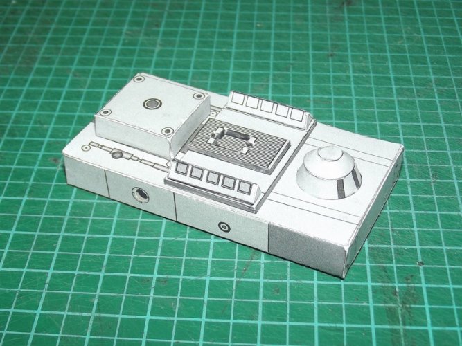

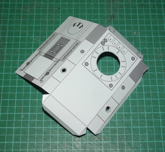

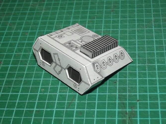

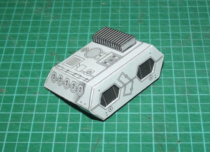

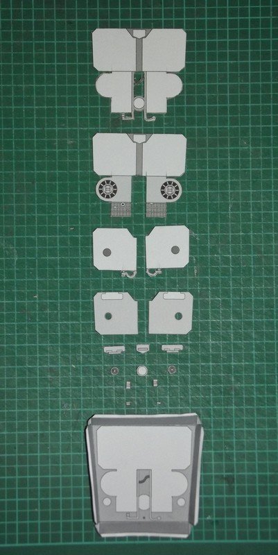

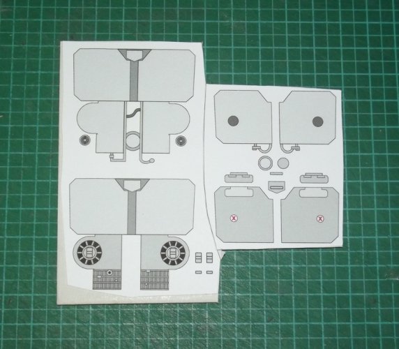

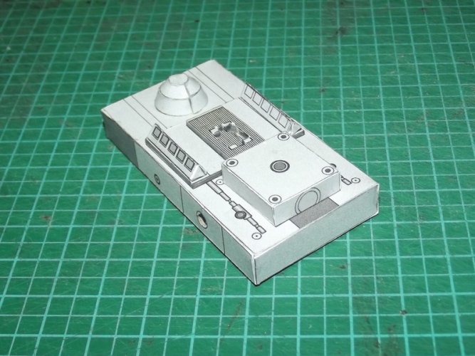

Next we have the engine box. It is what it is, a simple box with some deco parts on it. I changed the original assembly to simplify it and to get a fully closed box. On the original version several areas were left open and you could look inside the model.

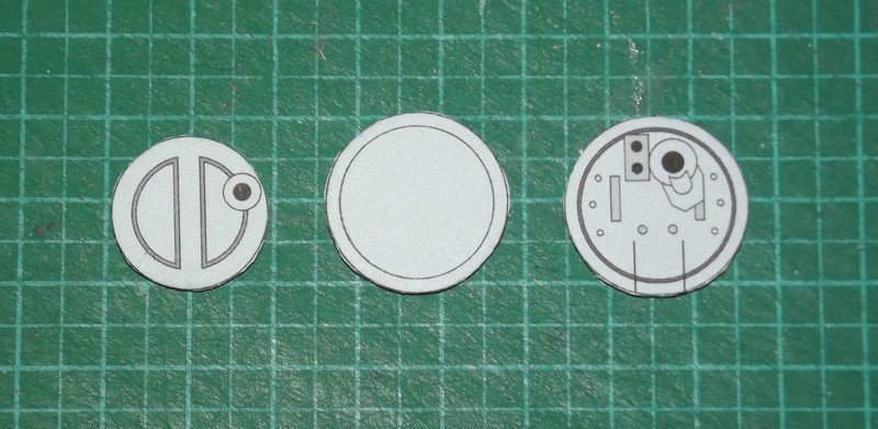

I marked the positions of the hip joints with a circle. The joints will be movable so you have to use some pegs made of wooden rods or wire. The size of the hole you will have to punch through the parts depends on the size of the rods you are going to use. For this reason the circle is just meant to act as a guide. It is important to hit the center of the hole, so I added a cross to make this task easier for you.
The back side of the future holes are reinforced with card.
I used a holepunch to create the holes which worked just fine. :)
Laminations for @Rhaven Blaack : ;)

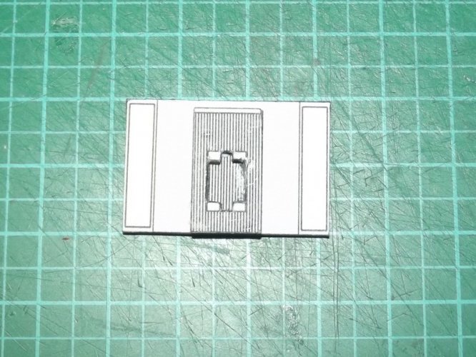

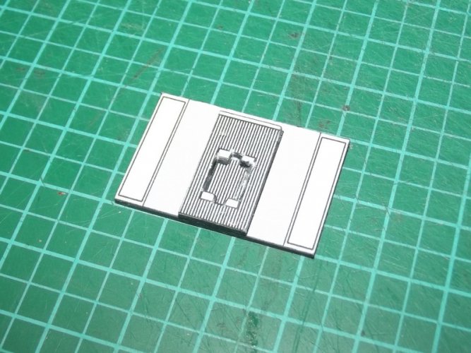

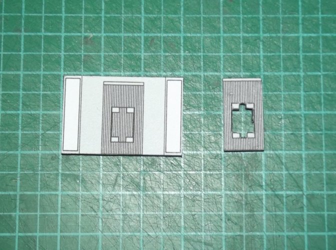

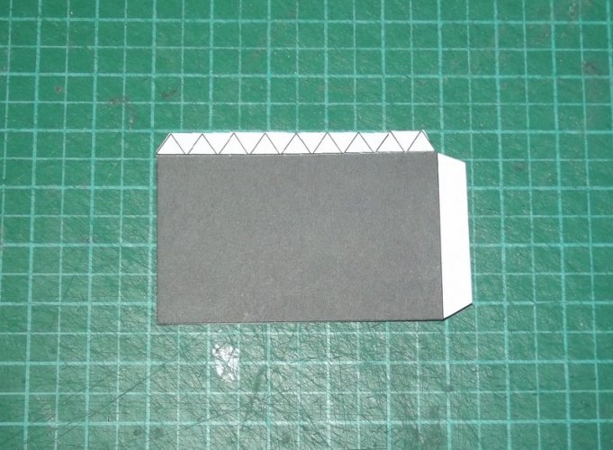

The box gets a cover:
The "exhaust ports" or vents are recessed.
As it turned out the cover does not fit well over the box so one of the parts needs to be adjusted.

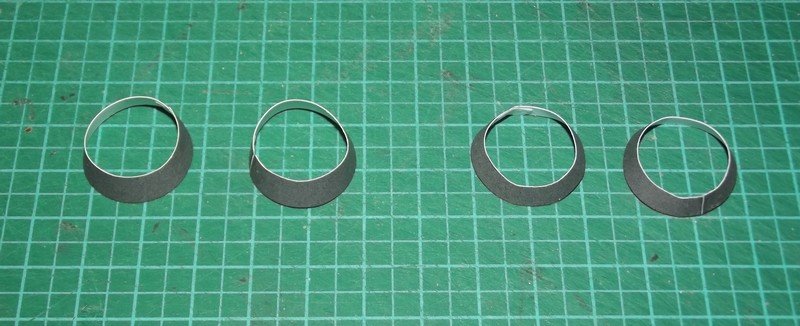

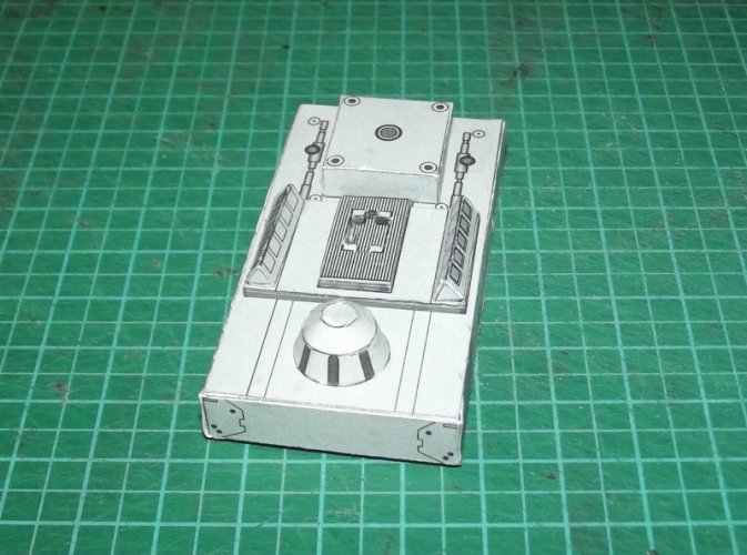

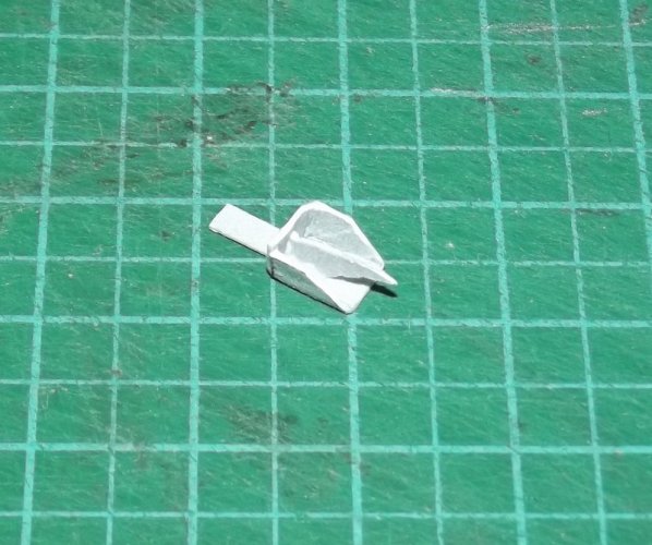

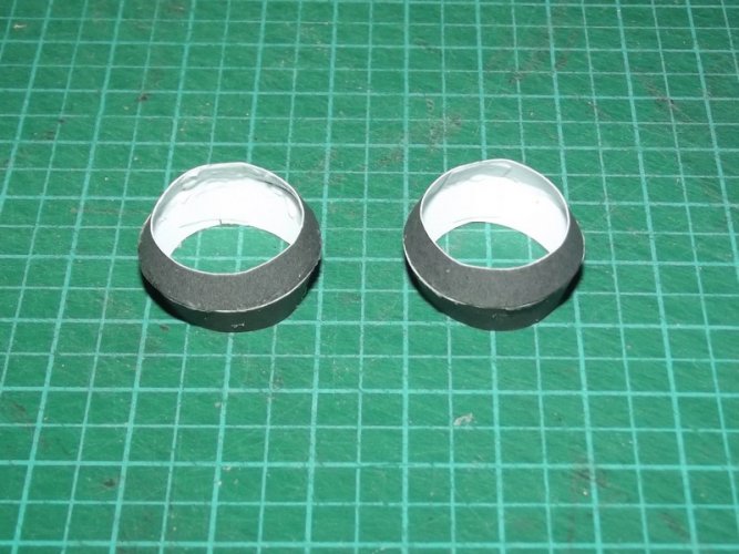

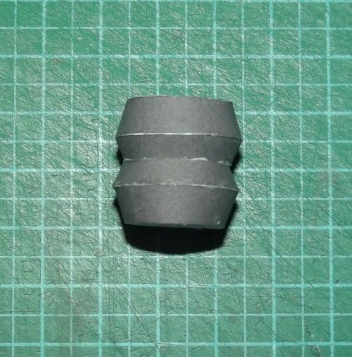

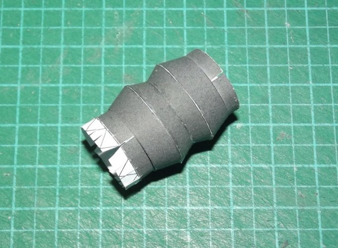

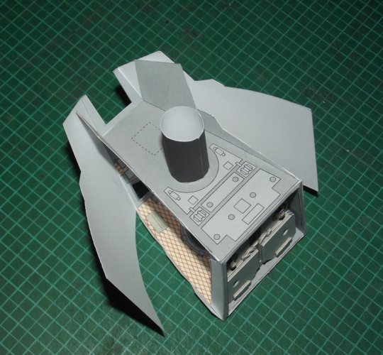

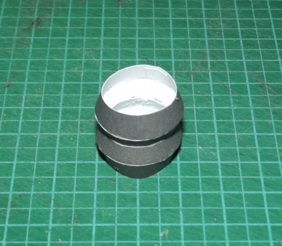

The neck is a simple tube which is pushed through the hole in the engine box and glued to its bottom. The original filming miniature features two cup-like shapes which are stacked on top of each other with the top cup being flipped so that the short ends of them meet in the middle of the neck. I replicated this with a gradient on the tube, however, as this project progressed, I tried to fully flesh this out in 3D.
So I made some easy cups in SketchUp and unfolded them into this:
This was pushed over the neck tube:

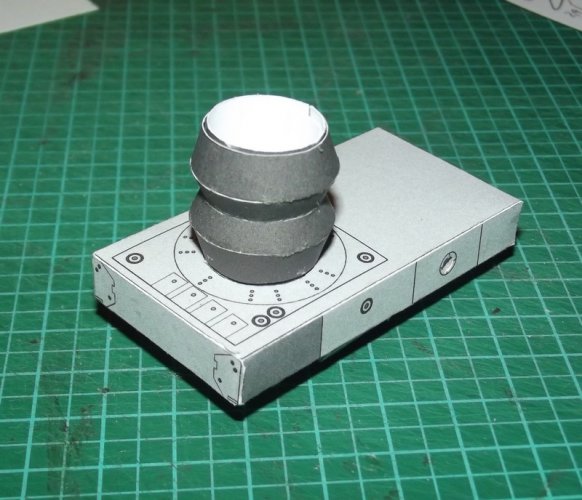

The neck tube is inserted into the engine box:

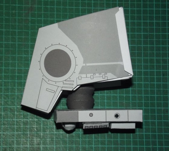

and the tube protruding from the bottom of the head is pushed inside the engine box tube:
Everything fits nicely and the head rotates! :)
I decided to keep the neck tube on the engine box to give the head tube a smooth surface for rotation. If I had skipped it the tube might get locked up inside the double cups. In addition the tube inside the cups gives them more stability.

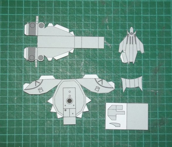

Now come some picture of single components I finished to "get them out of the way":

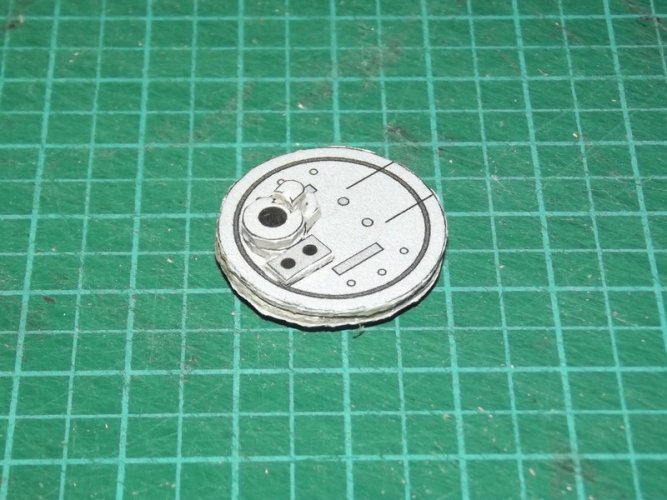

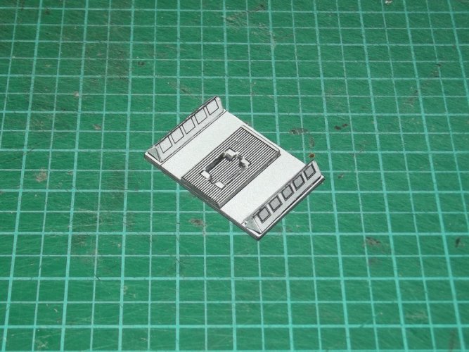

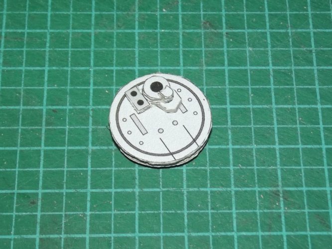

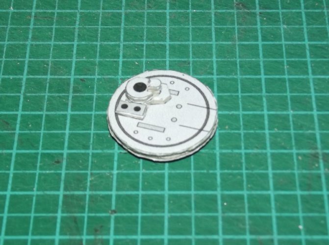

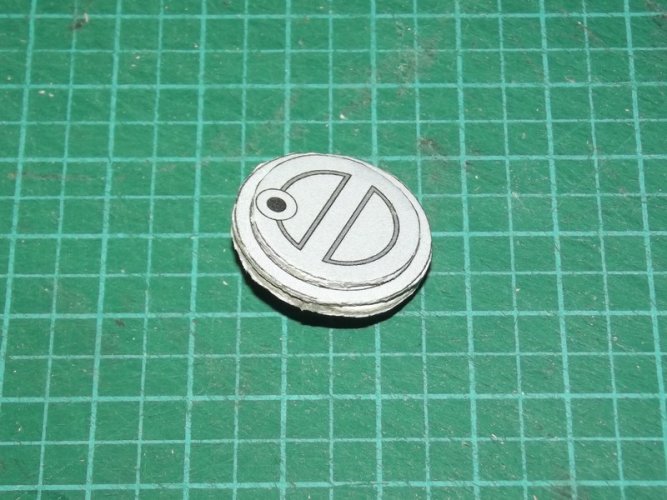

The top hatch:

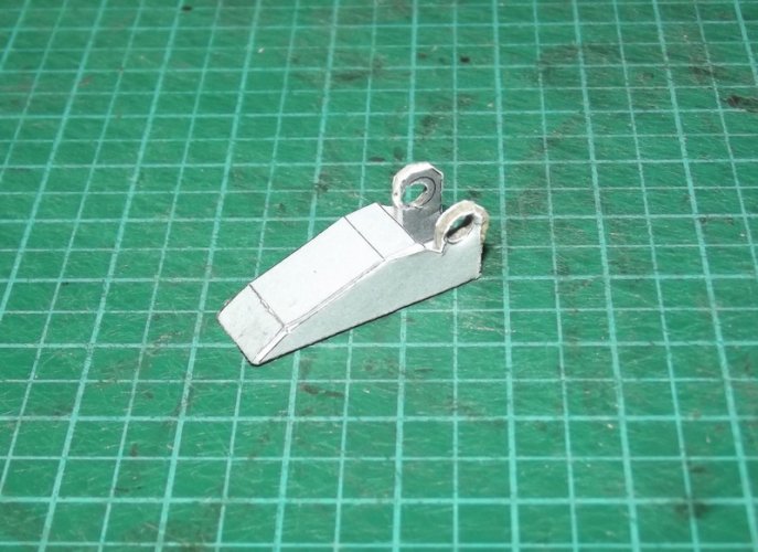

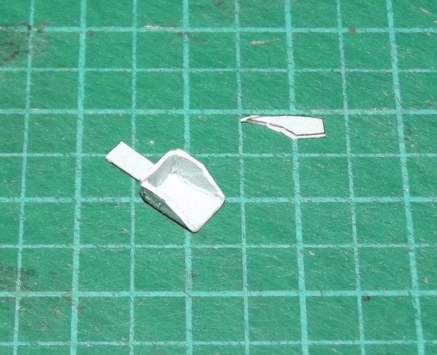

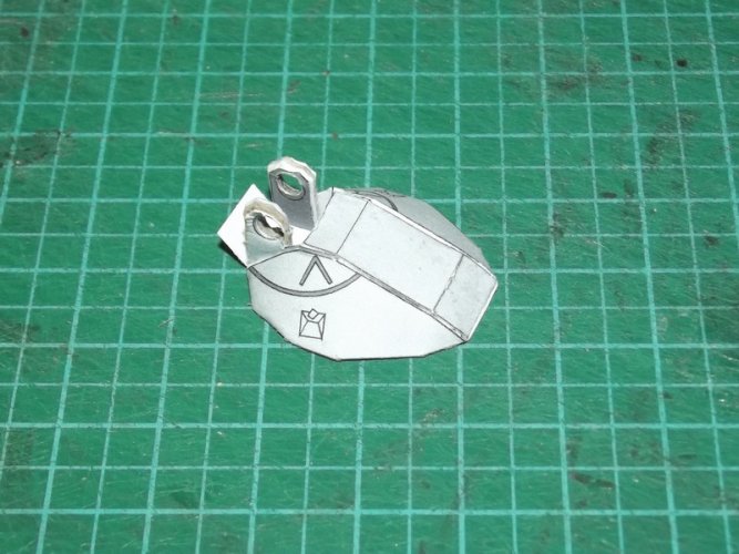

The "knee pads":

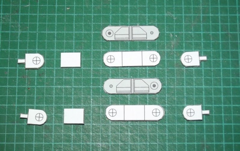

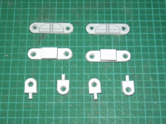

And the hip joints:
More on them later. :)

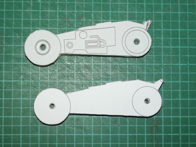

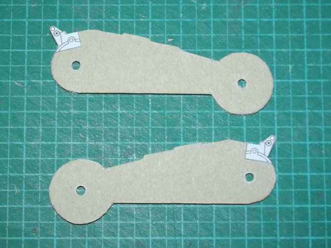

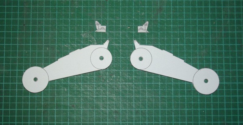

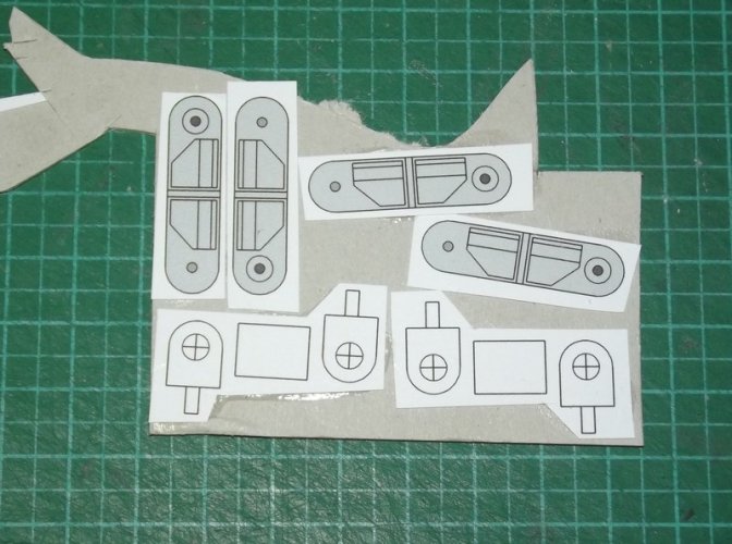

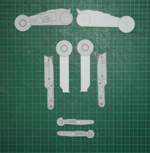

The new legs are fully articulated and posable. Each leg consists of three basic parts which are laminated to card:
The small texture bit is laminated to the back to prevent the plain card from being seen later:
Do not worry about the plain look of the upper leg. It will be covered by a separate piece which will make any trace of the joint pin invisible. :)
Three pieces are used to make the middle legs. I'll show you a picture later. The lower legs are complete. ;)

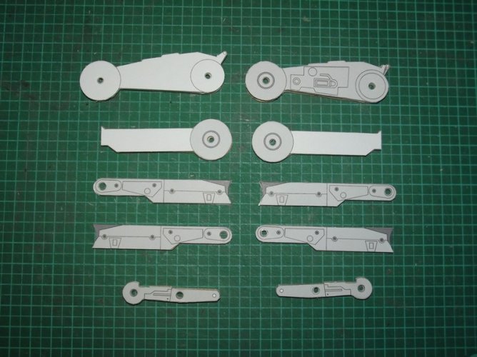

One of the most obvious changes are the feet. I used the ones from momirfarroq's kit and traced the parts in Corel.
I had no idea how the parts would interact and made a quick and dirty test:
Some unnecessary parts were cut off. As you can see I designed a more accurate fence cutter (middle toe).
The inner beams were laminated to card, glued to the back and punched:
At this point things went really well:
I was amazed to see that my traced parts fit so well together.
This foot is a massive improvement over the one that comes with Shunichi's kit. However, it has one major flaw: The toes do not touch the ground.
That must be changed. Now that I knew how the parts go together it was very easy to line them up in 2D to produce a more authentic look:
I'm now figuring out a new shape of the toe section and will keep you posted on my progress. Stay tuned! :)
