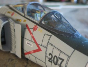

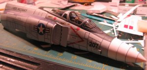

Glass in place

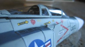

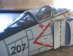

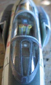

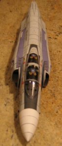

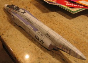

Jiim and Rick, I did a post on vacuforming a ways back, I do like the idea of doing one on the box itself and more importantly the frame/holding thing that holds the plastic to melt and form. Anyways, finally finished the glass pieces. They are in place, I think I did it right but GPMs cockpit parts, and the canopy parts clashed a bit on fitting to the fuselage. The rearview mirrors and some of the frames had to be HEAVILY trimmed to fit over the various panels and such. Now a break, some Earl Grey, and on to other parts of the aircraft.....

Excellent, Ted, excellent!:)
I found the vacuform thread, and enjoyed reading it...again...I thought it sounded familiar...tell you what, life is an adventure when you start losing your memory as you get older.:grin:
If you decide to update the thread with more details about building Le Machine, I for one would love it.

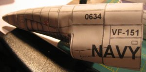

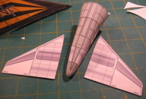

The last few days work

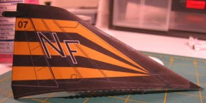

Having finished the front fuselage section, I decided to do the back end next for a change. The tail section is a little strangely shaped, it has to incorporate the transition from the twin engine exhausts to a roughly rectangular end piece. It went together nicely with only a few "redo-overs" at the tail hook section. The fin went together no problems, as did the stabilators. I debated about the metallized tail sections, either making them actually metallic, by masking and spraying a light dusting of silver spray, or just relying on the metallic like paint job from the paintshop pro repaint. I chose option B this time, maybe the Airforce E model or the IAF version will get option A. That's it for tonight......

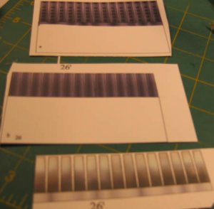

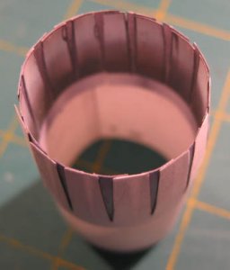

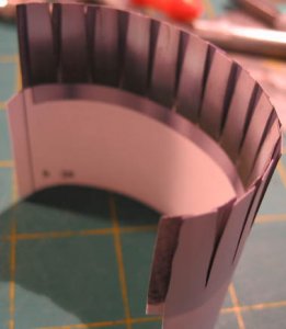

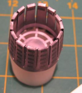

Jasco, thanks, Well I'm not a paper purist, if a part can be made of paper and it looks as good or better than anything else, I'll use it, Including the plastic for canopies! The little progress so far, the exhaust nozzles were a bit of a puzzle, but it was finally solved. The nozzles are made up from 3 differant rings of "fingers". What I figured was to cut out and glue 26 and 26 b as shown. Thier must be a little overlap as 26 a will be glued to the outside then have the little ends folded over and into the interior of the nozzle, best to see the pics.

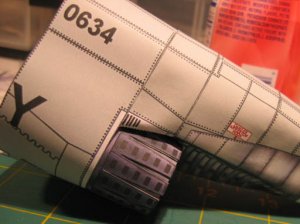

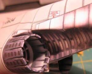

Last pics of the day. the exhaust dry fitted to the aft fuselage section, getting along.....

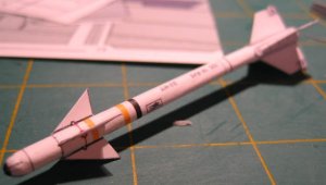

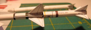

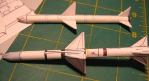

John, thanks for the encouragement. In answer to one of your earlier questions, I guess the model will be @21" long. Anyways, late last night, I was toying with the aircrafts armament. I've never been a fan of the stock weaponry given most card aircraft and decided to design my own. The GPMs Aim 7 Sparrow was rather basic and alittle short. Thier Aim 9 sidewinder didn't even make it to the build stage. After a little web surfing for details I completely designed new missiles for the Phantom. I came up with the Aim7E and Aim 9B missiles shown here. Sometimes you just have to do things yourself....The 1st pic shows the kits Sparrow and then the new missile. The other pics show the 9B Sidewinder.

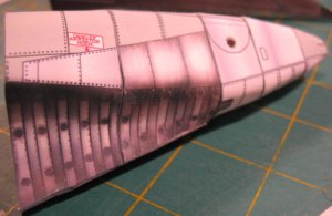

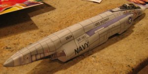

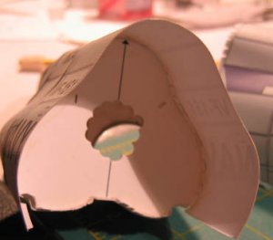

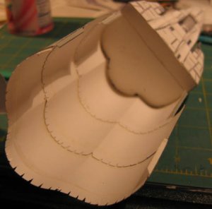

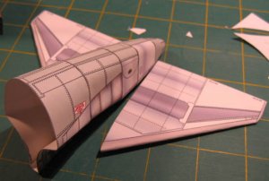

Well, side steps aside work finally resumed on the fuselage. I had decided to make it from both ends so that I could fit in the bulkheads to reduce that framework look that such models can get. It was working reasonably well untill it came time to join the halves. After much forcing, yelling, praying and swearing the halves finally went together. The first series of pics are the 2 halves being built from the ends. The underside shot shows the long run of fuselage parts fit together Ala "PModel" style with minimun bulkheads. It does make for a much smoother run. I'll fit the bulkheads later to gently beef up the wing mounting parts, but I may just leave them out. One pic shows the rough cut finger hole that was neccessary to move the after engine mount bulkhead to fit properly. I left the nozzles out in the pics.

These pics and one of the last shows an ooopps to the after fuselage trying to bend paper in the wrong directions. I managed to salvage the sections but I'll just show the "good side" when she is finished. The other pic shows the fwd underside sans bulkheads.

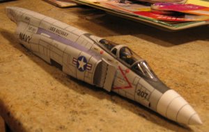

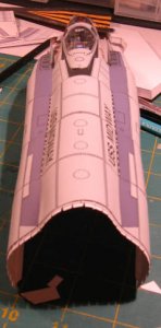

After letting the parts dry and watching some Invader Zim on Nick cable with the kids I decided to "Fuse" the halves together. "Oh come on your just gluing the pieces" " Yes Earth specimen but behold our advanced technology", "right it's just glue". After some fiddling and bending and holding etc, They finally held in a reasonably good manner.

The last fused fuselage pic, then a nightcap and more tommorow.....
