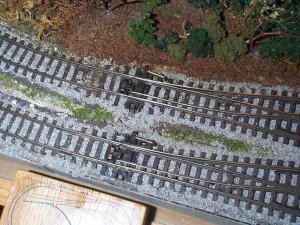

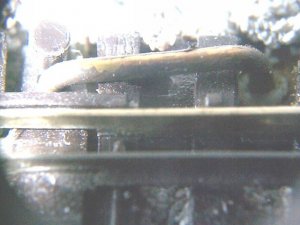

Photos below show one way to make a linkage using 5/64" brass rod through a 3/32" styrene tube bushing (evergreen scale models #423). The rod fits snugly enough in the bushing to rotate without wiggling sideways, use a little loco gear grease for long term smooth action. The hole for the styrene tubing is round 7/64" diameter (3/32" is too snug on the styrene and pinches the brass from turning easily).
The throwbar hole should be 'ovaled' slightly as the rod swings in a slight arc and you don't want to push the throwbar sideways because of rod tension (parallel to the rails).

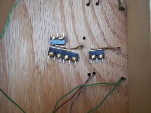

The microswitches are 2 amp low force (25 grams) from Digikey. Only one is needed to power the frog, but 3 can be used for other functions such as reverse power routing.
The beauty of this method is that it can be added AFTER the turnout and ballast is installed (ie, i goofed) since the hole is round and to the side rather than a slot directly under the turnout. Or a micrswitch can be hidden inside a structure and linked to the top of the table - many ways.
The problems are if any dirt or glue gets into the styrene bushing it binds the rod. Also over time the Peco turnout springs loose some of their tension and have a hard time holding against the multi- microswitch pressure even at 25 grams each. Next i want to try small ceramic magnets glued to the rod to help latch the points in either position. Or use fast relays.

The microswitches. A later method that makes them easier to adjust independently is a 'T' rod soldered to the rod protruding from the styrene bushing, with a heat sink (pliers with handles rubber-banded) clamped to the rod to prevent melting the styrene. This lets switches mount at both ends of the 'T'. Also removed one of the mounting screws to let the switch pivot on one screw for adjustment, then locked the switch with a screw and washer on the outside end of the switches.
No magnets shown, but you can imagine one glued to the rod and snagging onto either other magnets ar steel screws driven into the wood. Lots of room for experimentation.
