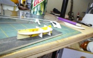

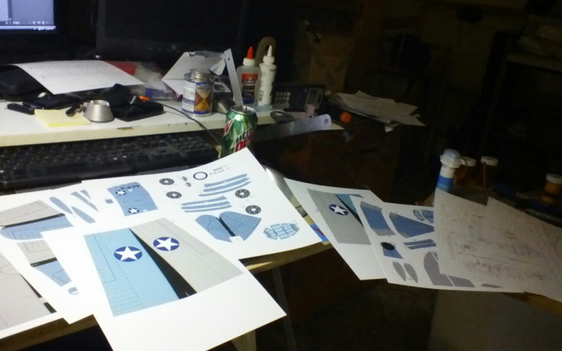

I am all ready started with some pic they look a litile weard I am trying to show them how the boxes are used

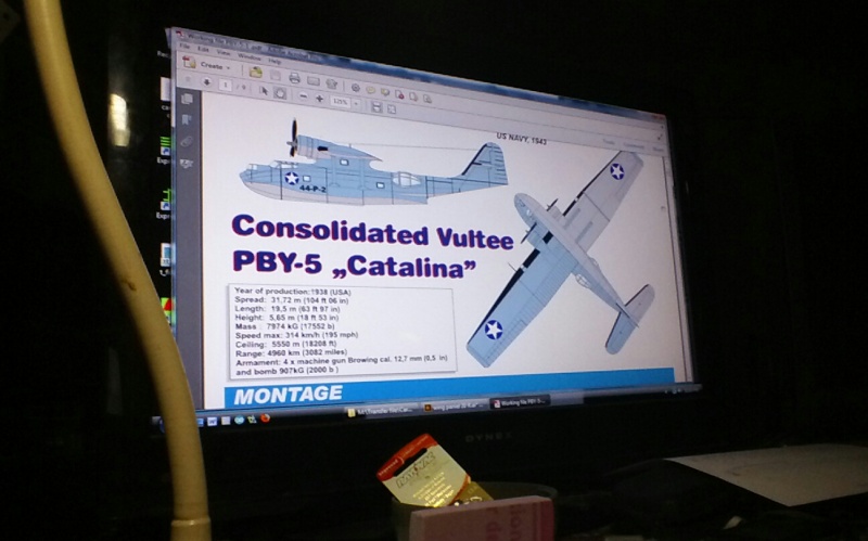

this is a 1:50 Marek model down loaded from the emodels site

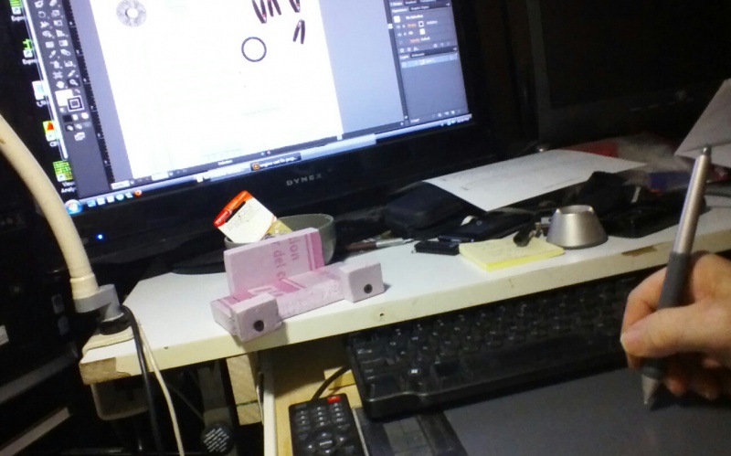

I like to print things that need to be bubbled on 20lbs paper so if aloud I move them to a new page after loading into adobe Illustrator then you can use the print capabilities of adobe also

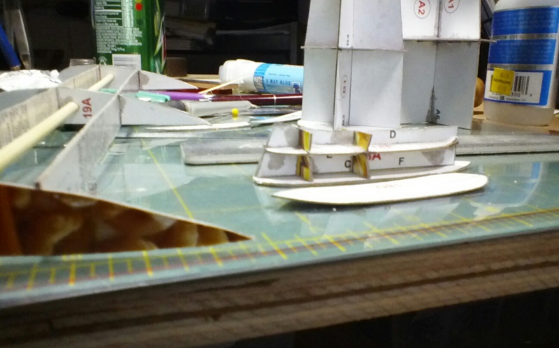

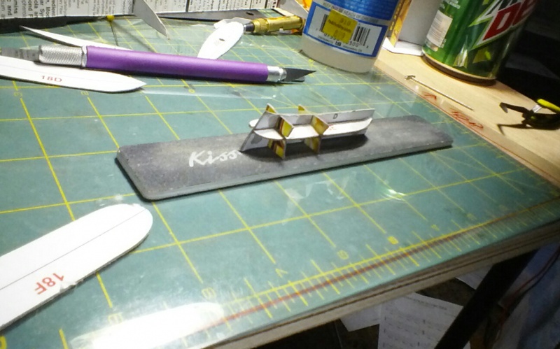

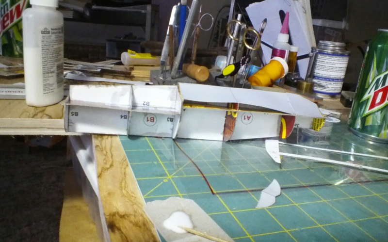

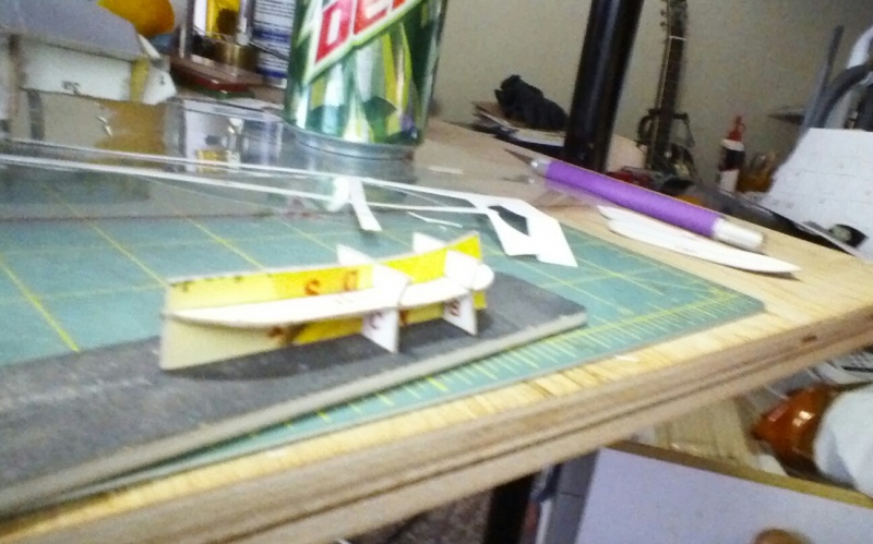

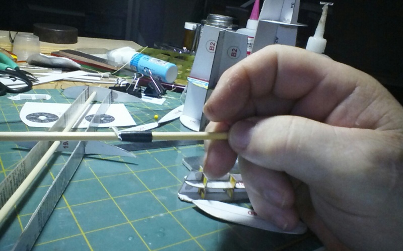

I am building the frame work in what looks to be the sections that would shaping or skinning I guess you guys say panels when I work on the planes we said skins
in the pics are some of the sub frames you can see that I am using skewers

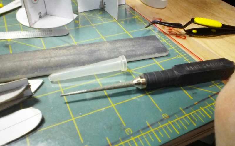

these are the larger ones. I use a Japaneses paper punch and I fount you can hold just the 2mm one in your hand it is easy to push and turn the skewer thought it sharp end first,in pic found my daughter nail sander foam middle fine on one side and a little courser on the other It works grate to flatten or shape and even up. The little thing is a bead ream meant for the center holes in glass beads very good on paper sharp enough to clean cut paper, also at michael s

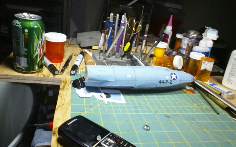

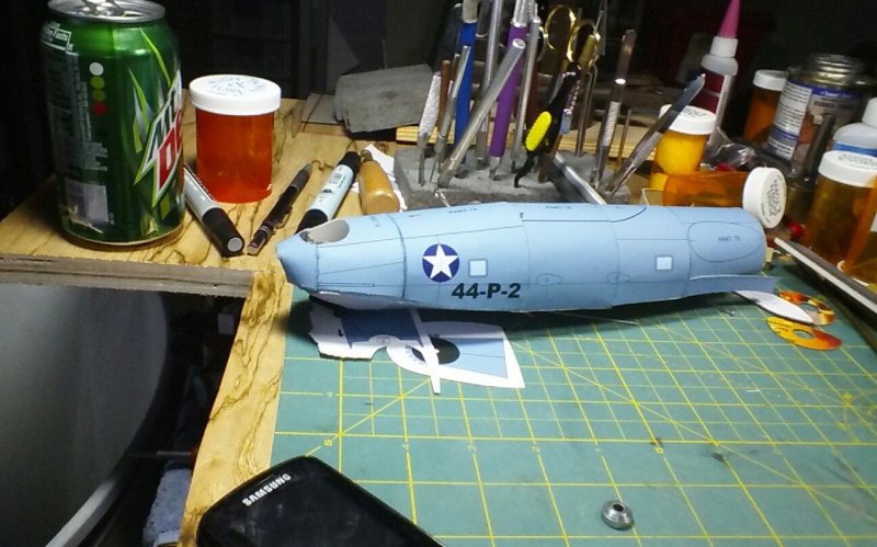

see in pics I have some of the hull skins panels on I did falter and got some glue on the surface
But the blunder the wing is mounted above the fuse with a cool looking coulmb it curves up in the front to fit the wing profile looking say right to left
from it should pointy in front and rounded in the rear
see pic I built the internal parts to be rounded in the front
there seems to be many parts not shown on the plane

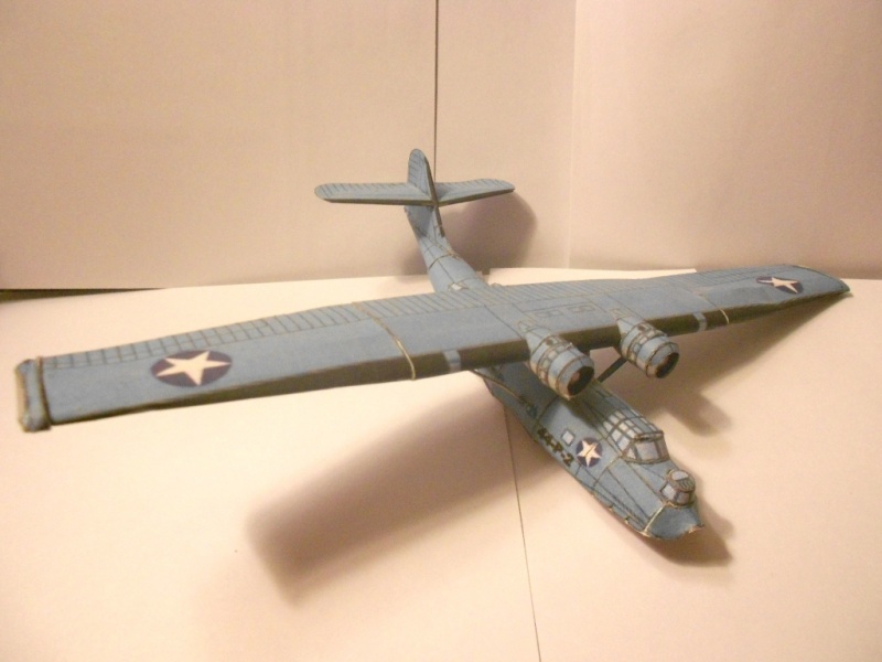

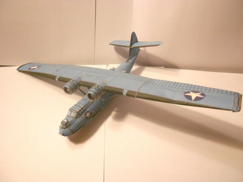

Nowhere near as good as yours will be, but here's a couple of pictures of the one I built 11 years ago. All I had were thumbnails from the site it was being sold on back then. No idea then how to translate the site, or buy the model. As soon as Dewayne Barnett made it available, I bought one.
This one used card for the frame, and regular copy paper for the skin, and it shows. Never did finish the fine details.

well here we are with total profe that I am unable to build any more
I think I am at the round file
I have many prismacolors but they bled badly
I have a full set of water colors pencils but cant it on the edge of the paper
order of assembly was off I did hull frist but hull goes over the hull plating
The worst transgression in the fight to get skins under hull I forget how to work with clean hands and....glue every
If I could figure out how to use watercolor pencils I would give it a second go

Looking good, Mac. Sorry if I wasn't clear before, mine is the same kit. I just built it from slightly enlarged thumbnail pictures. The smaller bits were almost too fuzzy to use, that and my fat fingers are why it still isn't done yet.
Scott K.
I agree with Bhelliom, it looks pretty darn good to me. I use an inexpensive set of watercolors that I got at the craft store, or Walmart, I can't remember which. It has 36 different colors, and you can mix these within a hair of pretty much anything. I use a 10x0 brush that allows me to be very exact with the placement of my pigments.
Don't give up, if nothing else look at it as a practice model, but I think that it looks quite good.

I have been back about 3 weeks from a hospital stay and I would like to finish this Plane. I have built the simple wings with no ribs but this one is the devil.
I printer and tried-printed and tried- you get the Idea What is the sequence
when i glue the trailing edge I cant make it tight to the ribs or glue the inter ribs. When I try to glue to the bottom and pull the skin over the to the trailing does not line up and the panel is wrinkled same thing starting with the top panel

I would recommend the "sock" method. Glue the trailing edges together, or, tape them with a very light holding tape, the kind that is mean to be removed, then slip the assembly in there. You will start with the smallest wing rib, when it fits, the add the next wing rib. Eventually, you will have trimmed it to shape and it will fit snug, then you glue. Of course, shape the wing roughly to the shape you need, if you make sure the ribs and spar are strong, and it should fall into shape, (laminate the spares if you must, just remember that you may have to sand or cut any outer lamination a bit, not much, smaller as you work your way to the tip. If you find any to be too small, a strip of paper around the wing rib will bring it back to spec, and give a greater gluing area. Excessive glue will assure a strong wing. This is not an easy plane. The fuselage looks great by the way.

the BIG problem(in my mind) I can't .... is with the center section which is strait. I match up the trailing edge and glue this is after shaping first.
After sliding the rib spar ass amble the skin is not down tite to the ribs in the middle and there is no access to glue.
This is a long section maby if I use rubber cement and slide the ribe and spar assamble in before it is totally dry it will only open up to what it needs, hmmmm this mite work, This is grate if I keep talking to you guys with all the info and start my thinking I will have it. This mite work with out wrinkle the skin
I would keep the main spare where it should be. Start with the smallest, outer rib only, when that lines up, by either trimming, or adding onto the rib, then add the next rib, and continue the process till the whole unit slides in and fits. Then remove and add glue to each rib, and tops and bottom of main spar, and slide into sock/wing. It will hold, and you will have a nice fitting assembly that supports but does not give a "skeleton" effect. If you post a picture with the center section in relation to the wings, I can tell you how to do that, I suspect you will glue the main spars and skin afterwards.:)
