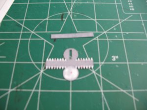

On the curved parts I have been cutting off the tabs, and creating my own, allowing a butt joint without edge gluing. I cut strips about .3 inch to use as tabs, and I cut to length.

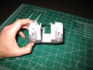

The only thing I had real problems with so far were parts 33 and 34. The gap was unacceptable. So knowing that these parts are bellows I cut strips at about .1", colored the strips various shades of grey and black, and wrapped 33. I did the wrap after attaching the 33 to 30/32 sub-assembly. I'll post pictures of the finished repair next post, after I fix the other side.

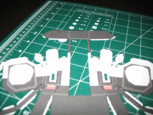

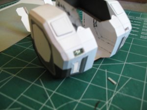

I also finished the shield. Did I mention that I am building this as part of the Snohomish County Sheriff's Office SWAT (or maybe SRT), my local agency. So, I am building without the Japanese scripting and I will add the SCSO markings later. I am waiting for some 4017 IC to arrive, so I am building around the spaces that I intend to place the circuit boards.
As designed the underside of parts 125 and 126 are visible. I don't like that look, so I printed a second set, built those part inside out, white showing; then I placed these on the inside of part 116 (the back of the shield). Unsightlyness covered.

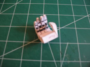

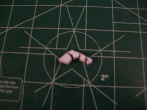

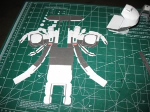

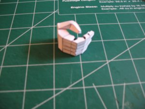

Update: I lied last update, I hadn't finished the shield. So I built the grey anima-y buttons. Then I built up the left lower arm finished. Both hands done as well. I copied another build, and articulated the fingers.
More of the hands:
There is another picture showing the finger articulation, alas I have a somewhat juvenile sense of humor so I didn't upload that shot (but one of my teenage sons laughed and laughed).

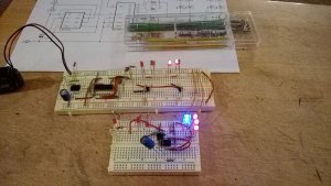

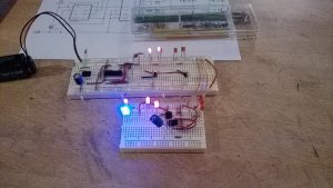

Well, I've been on hold for want of electronics proficiency. I have some gifted co-workers, who schooled me, so I have completed the two circuits that I need on breadboards, and will be transferring these to circuit boards which I will fit in the waist of my Ingram. The small board is a wig-wag. The wig-wag lights will be the hip and chest lights (I'm thinking of adding two blue chest lights). The large board is the shoulder light bar circuit, which flashes one side three time, then the other three times.

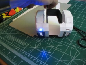

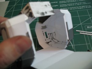

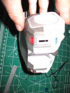

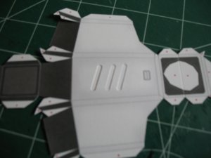

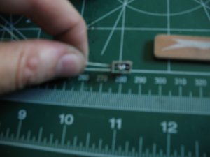

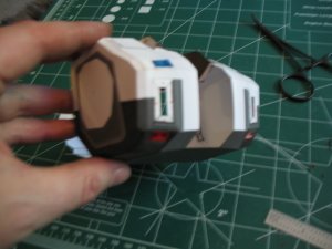

A small update: I have started moving the electronics from the breadboards to circuit boards, but I have yet to solder any connections. I have gotten some of the 0402 SMD LEDs soldered onto SMD mounts. I have also started the chest/cockpit. I opened up the part so that I can install some of the cockpit. If you build an Ingram, I would recommend removing all of the tabs (Except the 90 degree tabs) on part number 93, and making your own butt tabs. I created light boxes for the LEDs too keep light from bleeding through the back or sides of the mounts. I used red and blue colored sheets as lenses. I was able to install both the red and one of the blue chest lights. Tomorrow I hope to get three more Leds soldered... Sorry about the picture quality, my camera doesn't like close up.
