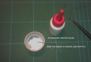

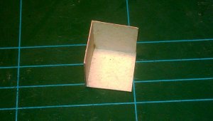

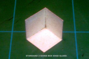

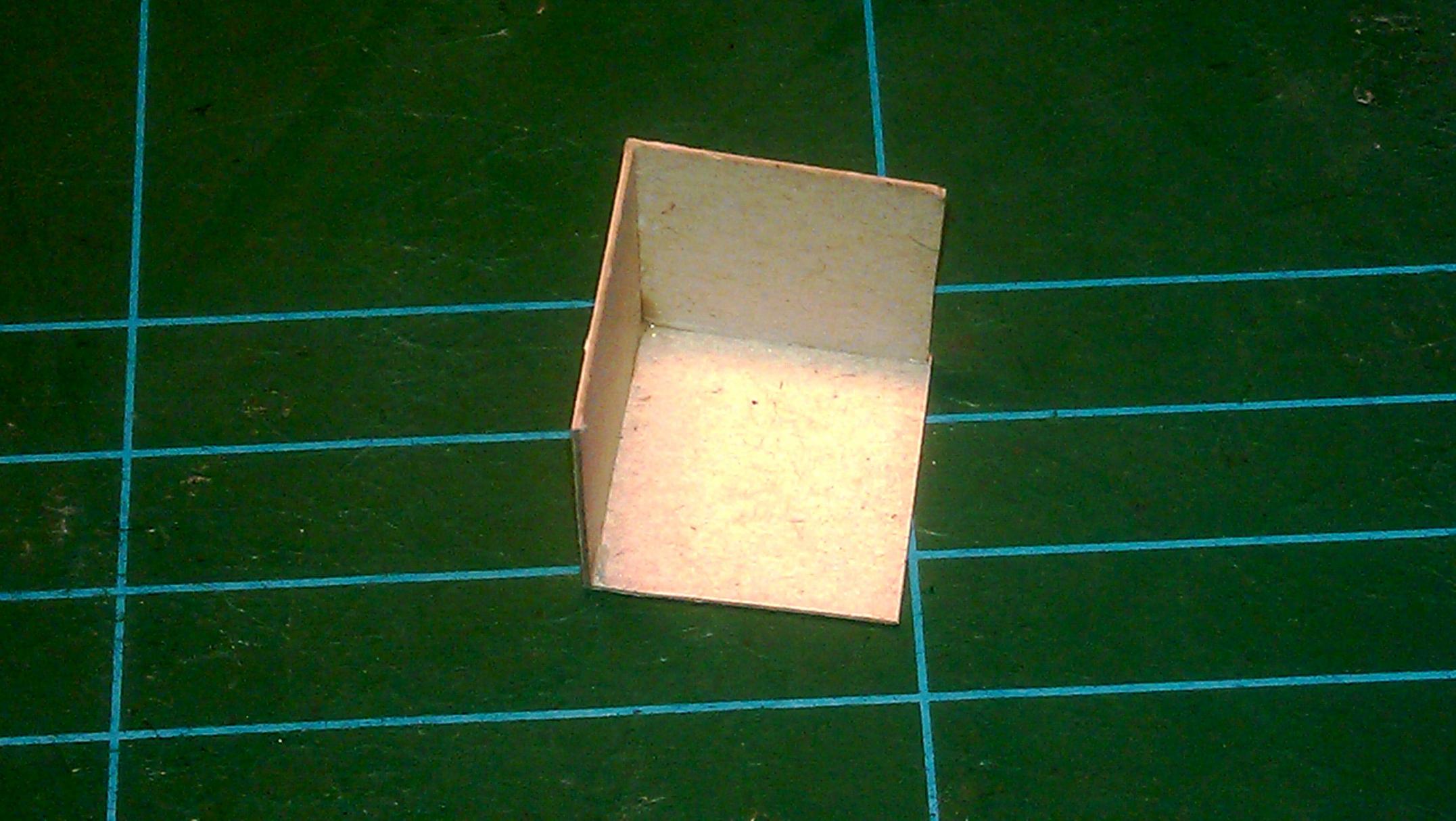

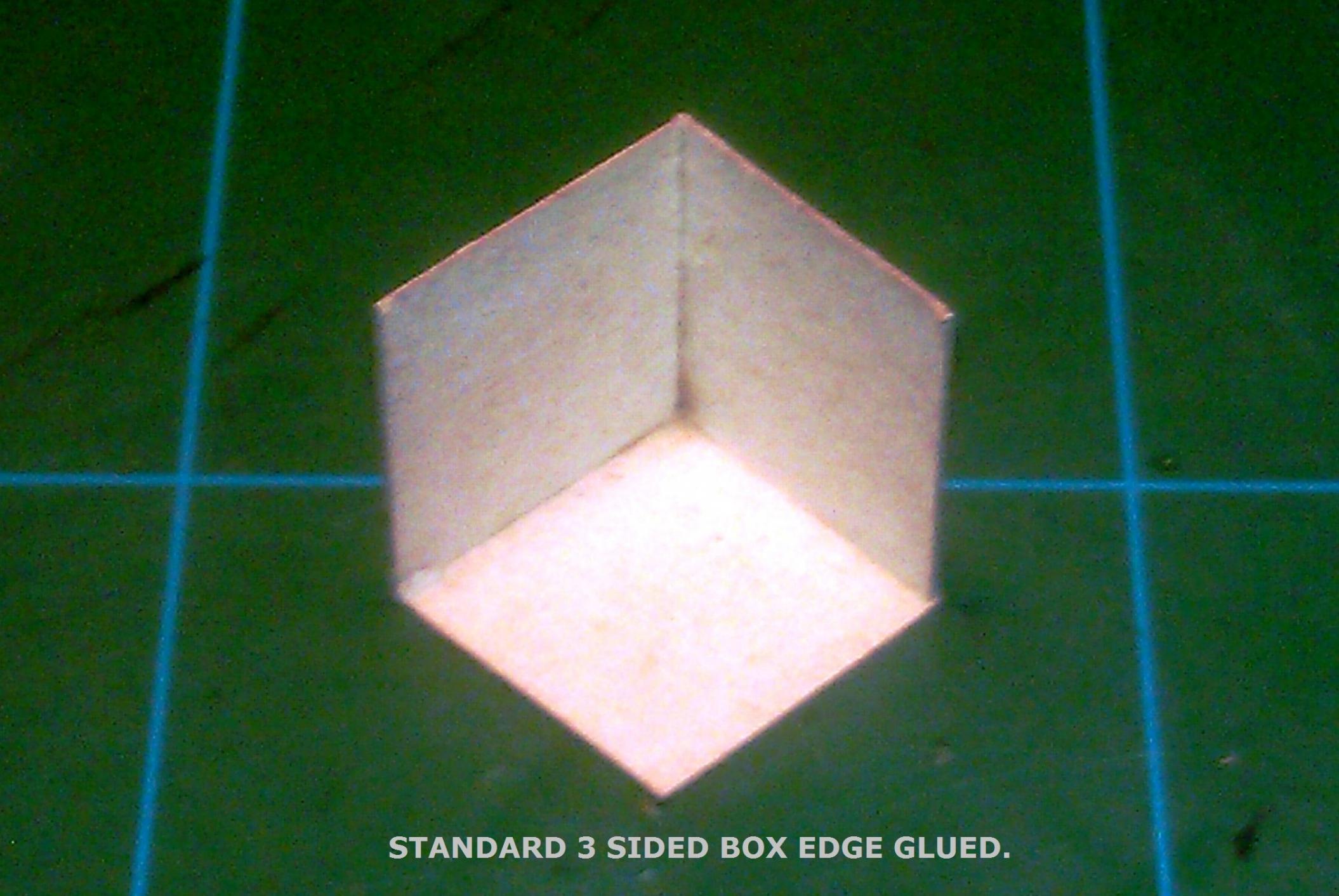

I have edge glue three panels together.

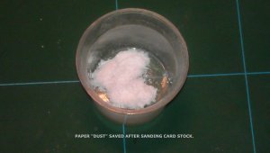

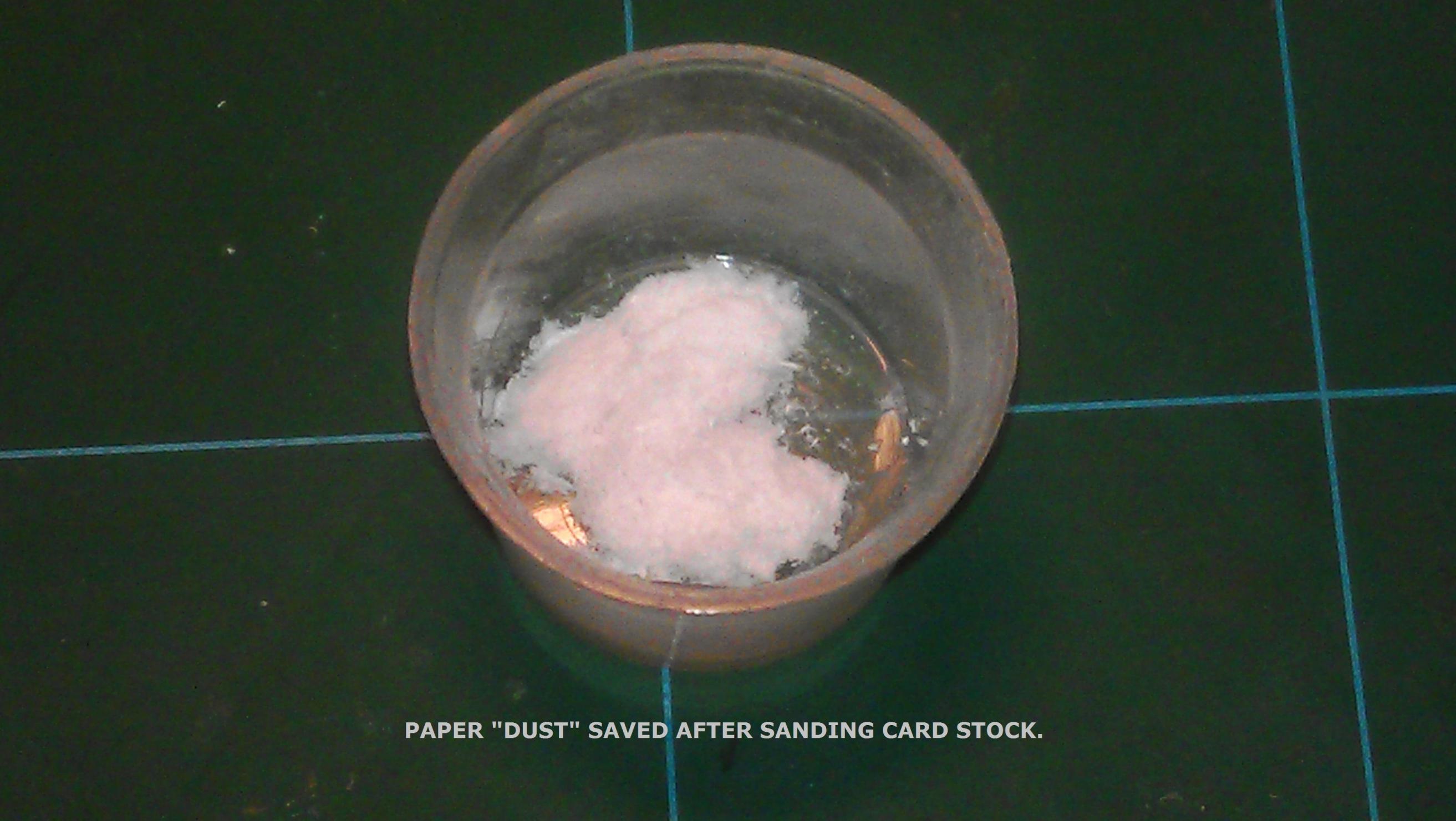

Portioned out some paper dust.

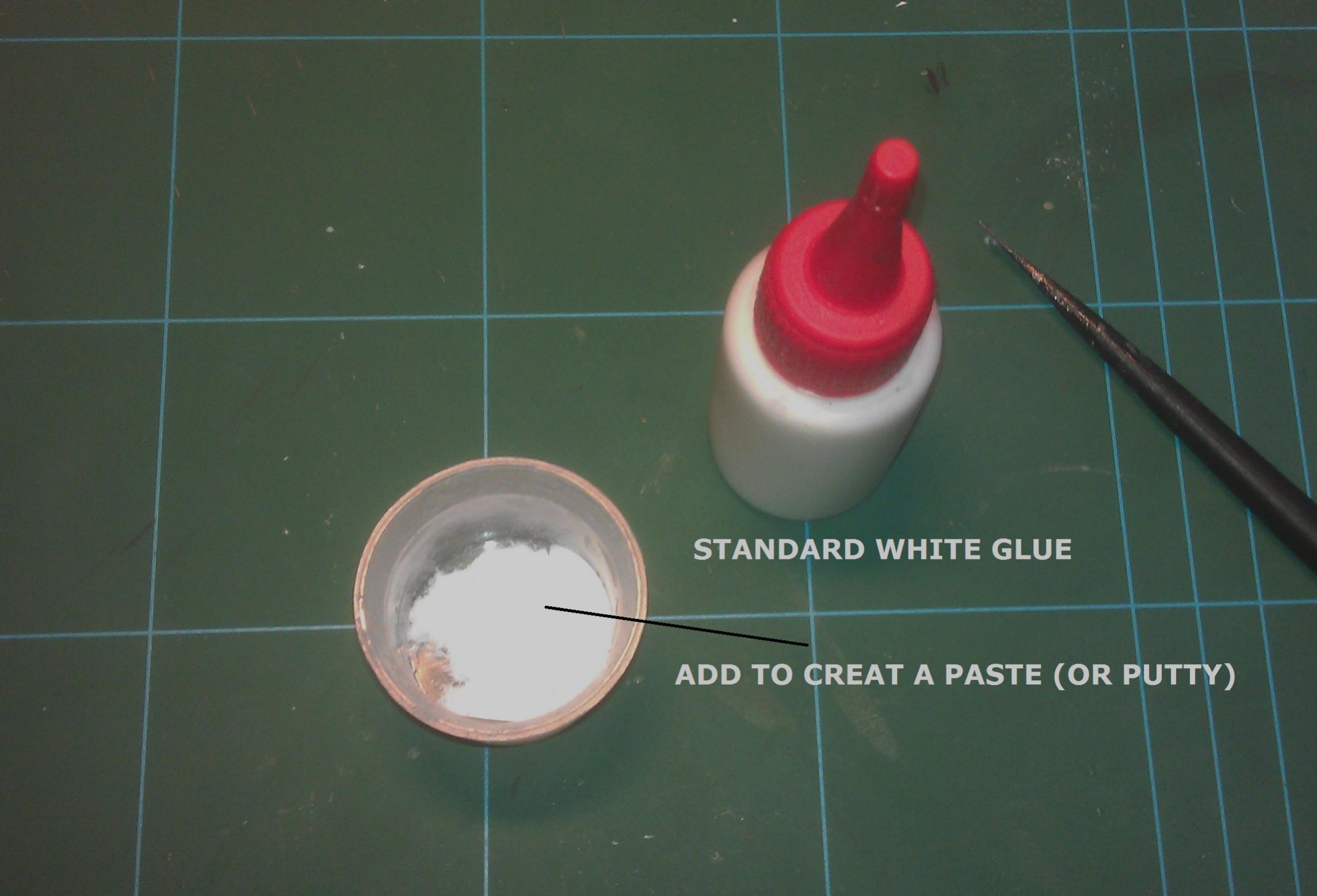

Added white glue (it is easier to work with for this technique).

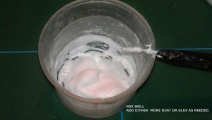

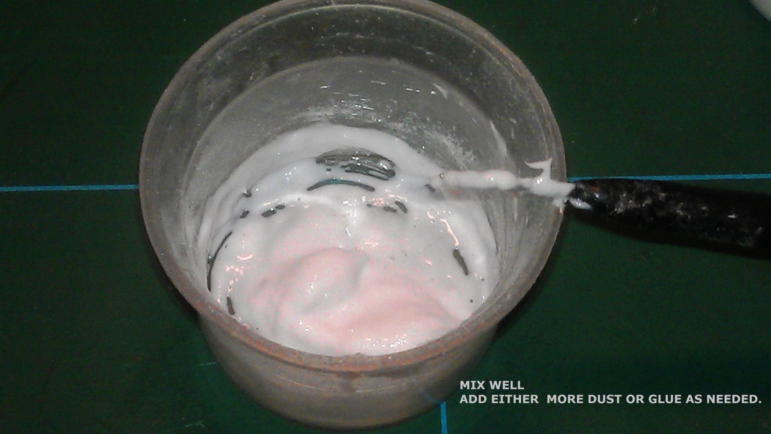

Mixed well (and added either more dust or more glue for the right thickness).

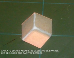

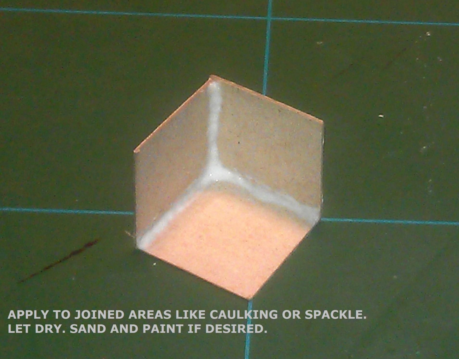

Applied to the joined areas (like caulking or Spackle). Let dry, and treat as needed.
