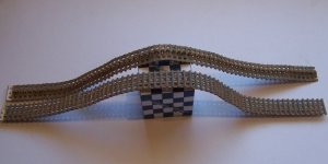

Just to wind up the thread and to prove that a complete set of tracks can be built with this method. Here's the track set for the WAK Panzer IF.
The camera picked out a couple of places that need to be touched up.
Regards,
Charlie

That's quite an impressive set of tracks, Charlie! This really shows how one can create a very impressive detail on an AFV model. Great job!
Thank you again for sharing this technique with us...I will be sure to try this one out!
Cheers!
Jim
Regards,
Charlie
It did????
They look fantastic, Charlie!
I need to go shopping again, to see if I can find some paper suited for this.
A great technique with equal results!8)
It never seems to fail that someone on this forum astounds me every single day!
These tracks are no exceptiion, Charlie! Take a bow!:wink:
Russell
Regards,
Charlie
Wow Charlie, your finished tracks are awesome. :D :D
Thanks for sharing your secret with us,
I really appreciate it very very much.
And I will try to incorporate your method into my next tank build. :D
