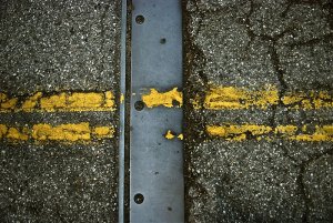

Once you have the stripes masked off, you could also try dabbing the paint on with a sponge, to suggest worn markings that have begun to peel away and need repainting, like these:
