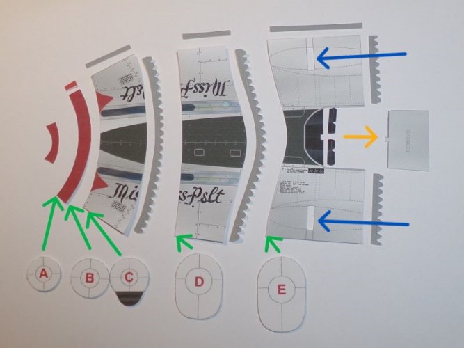

Assembling and connecting the fuselage sections is done using the supplied joiner strips. Internal formers are then inserted into the fuselage and positioned at the joints (see the green arrows). An exception to this assembly method is the joint between the first 2 sections (parts 1 and 3). A joiner strip is not provided for this connection, but formers B and C can be butt joined together.

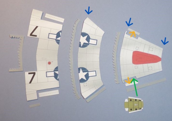

A rectangle (marked "REMOVE") in part 5 needs to be cut out to accommodate the cockpit (see the yellow arrow). There is a slot on both ends of part 5 (see the blue arrows) that also needs to be cut out. These small slots will join together to became 1 large slot for the wing assembly. I didn't cut the slots all the way to the edges to make joining the edges easier. Once the edges are joined, I will finish cutting out the slot(s).

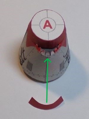

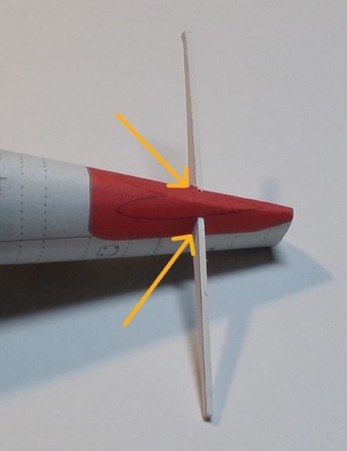

As mentioned in my previous post, a joiner strip is not provided to connect the first 2 sections of the fuselage (parts 1 and 3), but formers B and C can be butt joined together. I am not good at making smooth butt joints so I made a tabbed joiner strip for the front of the second section (part 3). After the joiner strip was glued in place, I inserted former C and glued it in place (former B was not used). Next, I glued sections 1 and 2 together using most of the tabs of the joiner strip. The 7 tabs on the bottom, which extended past section 1, were used to glue the air scoop part in place (see green arrow).

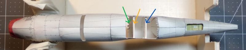

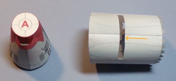

Here is the finished air scoop. Before shaping and gluing the edges of the fourth section (part 5) together, I partially cut the slots on the edges. After the part was constructed, I finished the cutting to make 1 long slot. The wing spar will be inserted into this slot (see the yellow arrow).

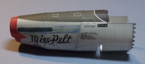

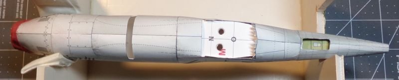

Finished the front half of the fuselage.

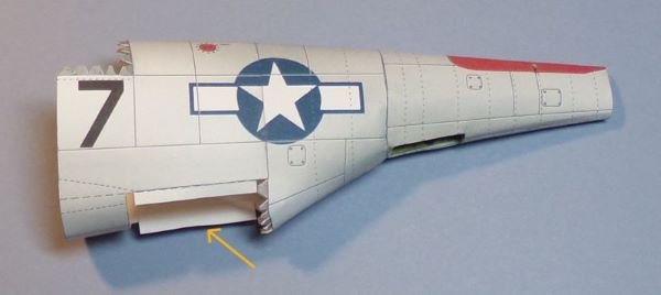

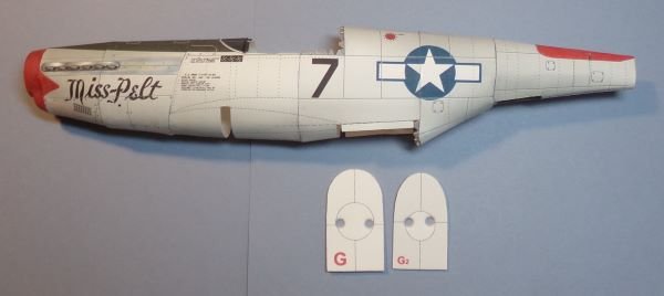

The rear half of the fuselage has 3 segments. Each segment has a glue tab along the edge and the front. I am making this model with landing gear, so I cut out the rear landing gear doors (see the yellow arrows). The rear wheel well will be located under this opening (see the green arrow). This subassembly has 3 former, which I forgot to include in this photo, but the formers positions are indicated by the blue arrows.

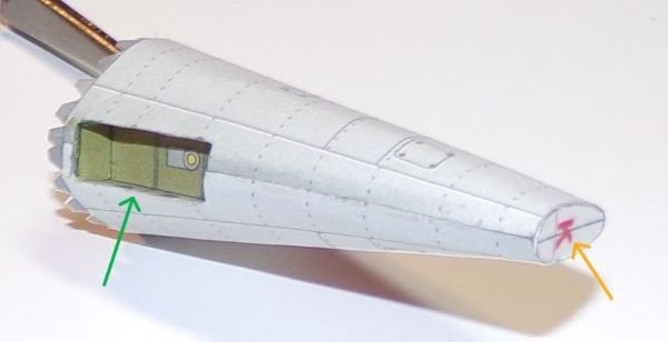

The rear most segment of the fuselage (part 9) needs some additional work after it is glued into a cone shape. The K former needs to be glued into the back end (see the yellow arrow). The rear landing gear wheel well is installed into the front end (see the green arrow).
There are 2 short black lines at the top of this segment, which indicates where the slots need to be cut for the elevator former (see the yellow arrows).

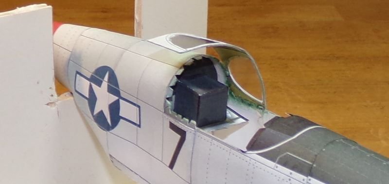

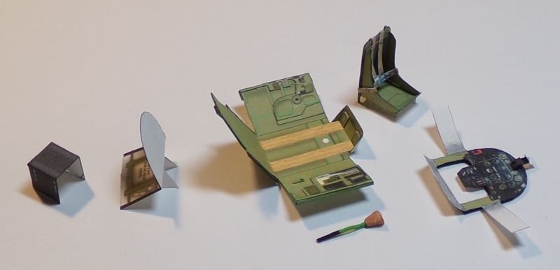

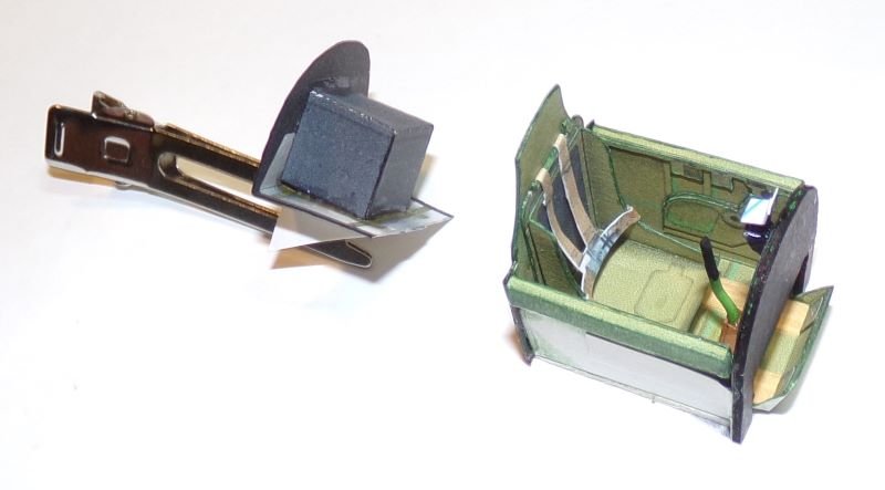

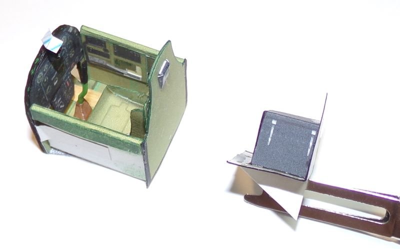

Now that the formers at the rear of the cockpit are in place it is time to do the cockpit assembly. The radio box and shelf are 2 simple parts (on the left in the photo). The cockpit itself consists of 4 subassemblies: the tub, which has several little 2D parts that are glued to the inside, the control stick, the pilot seat and the instrument panel.
Here are two views of the assembled cockpit and radio assemblies.

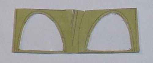

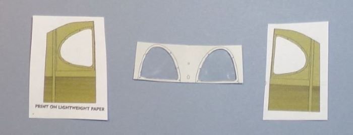

The rear window framing is 1 piece (part 7). There are 2 others green parts provided on page 3 of the instructions that can be glued to the inside surface of the window frame. These parts are intended for use when making transparent windows. I cut out pieces from an old document protector to make the transparent windows, which was my first time doing so. I used Beacon Zip Dry glue to mate the paper and plastic. This glue is thick and can be stringy if not placed carefully (it reminds me of rubber cement).
The odd black lines in the middle are a result of my using scraps to totally cover the inside wall. I don't think covering the inside was worth the effort because that area is rarely seen. The window piece can be installed before or after the cockpit is placed.
