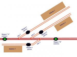

Here's something for those who are building operation-oriented layouts, I have some thoughts pertaining to the placement and use of magnets for uncoupling. I would appreciate some discussion from anyone else interested in the subject.
First, I will discuss what I did on my layout (I have since discovered that I could have done things a little simpler, which I will discuss in the next post). Anyway, good food for thought.
Looking at my diagram, assume there is a run-around track near the spurs which can be used to orient the engine for trailing point maneuvers as needed.
Scenario #1 : Setting out cars on spur 1 or 2. If train is traveling to the left, we are already set up for trailing point set-outs. If train is traveling to the right, we need to do a run-around to make the spurs trailing point.
Loco is oriented on the left end of the cars. Stop with the righthand coupler of the car to be set out over Magnet B. Uncouple.
For spur 1: Pull to the left past spur 1, then back into spur 1, uncouple the car to be dropped off over Magnet 1 and push car to location using delayed action.
For spur 2: Pull to the left past spur 2, then back into spur 2, uncouple the car over Magnet 2 and push car to location using delayed action.
Scenario #2 : Setting out cars on spur 3. If train is taveling to the right, we are already set up for trailing point set-outs on spur 3. If train is traveling to the left, we need to do a run-around with the loco to make the spur a trailing point spur.
Loco is oriented on the right end of the cars. Stop with the rear coupler of the car to be set out over Magnet A. Uncouple. Pull to the right past spur 3, then back into spur 3, uncouple the car over Magnet 3 and push car to location using delayed action.
I think that sums up the possibilities for a simple drop-off of a single car in these spurs. Now, add in pick-ups, setting out multiple cars that are spread throughout the train, cars that are being held at the industry but are in the way and need to be moved then put back, all these things add greatly to the fun of switching.
So, I have 5 magnets to switch these three spurs, 2 electros and 3 perms. But I think it can be done a bit simpler with only the two electromagnets. See next post.

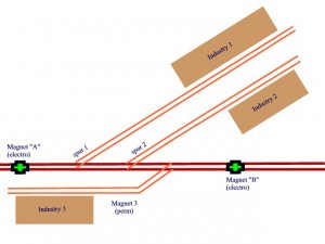

With only the two electromagnets at A and B, let’s consider the same scenarios:
Loco is oriented on the left end of the cars. Stop with the right end coupler of the car to be set out over Magnet B. Uncouple.
For spur 1: Pull to the left past Magnet A and stop with the left end coupler of the car to be dropped off over Magnet A. Uncouple the car over Magnet A and get the couplers in delayed mode. Push car into spur 1 and drop at the industry location.
For spur 2: Same as spur 1 but push car into spur 2
Scenario #2 : Setting out cars on spur 3. If train is traveling to the right, we are already set up for trailing point set-outs on spur 3. If train is traveling to the left, we need to do a run-around with the loco to make the spur a trailing point spur.
Loco is oriented on the right end of the cars. Stop with the left end coupler of the car to be set out over Magnet A. Uncouple. Pull to the right past Magnet B, stopping the coupler of the car to be set out over Magnet B. Uncouple the car to be set out, get in delayed mode, then back into spur 3 and push car to the location.
Now, I am thinking that my 5 uncoupler arrangement may be a bit more versatile for dealing with pick-ups and hold cars, and whatever maneuvering is needed, but I will have to deal with possible unwanted uncouplings over the perm magnets.
Would love to hear comments, I am just making all this up as I go. It seems like the logical ways this stuff could and should be done.

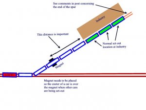

Another issues concerns length of spurs and magnet placement. I referred to this a bit in another thread. The diagram shows what I feel is important for spacing.
Another concern is the end of the spur. I think there should be a bumper placed on the end at the place where the last car would be spotted. This would help with coupling up to cars that need to be picked up. If the bumper is haphazardly placed, or if there is no bumper, sometimes the cars will be pushed back some before they actually couple up. This could cause the couplers of other cars being used as a handle to end up over the uncoupling magnet. A bumper would prevent this, and would situate the handle cars where the couplers would not be over the magnet.
Now, using electromagnets as in the second diagram above would render this topic void.
