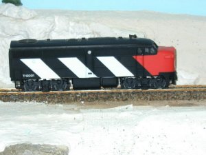

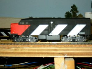

I have a couple of those HO FA Lionels, Ive tried one of the shells on an Athearn F7 ( Blue Box) and it seems like a usable fit. If you are willing to do a little adjustment it will work. I can check the fit again if you'd like, anyway that is my plans for the Lionel shell.Cheers Willis
Well it's a tight fit but it does fit, attached photos. One observation the Athearn trucks look a lot better than the Lionel trucks. There are other issues such as securing the body to the Athearn frame, fuel tank details, coupler ect. but it can be done. The best I have above the Christmas trainset range are Athearns so I have no idea if they can be mounted on Atlas, PK and whatever. Hope this is of some help.
Cheers Wilis

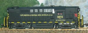

Ah! the trucks yes, on the models I'll be doing the trucks will be much different. The FA's used around here were built in Montreal (MLW's) and were different again. I have to do some research on this but that's some time in the future. What I do with the Athearn trucks is to saw the details off the side frames leaving enough of the Ath. side piece with the prongs to cement the proper side frame to it. Attached is a pic of my MLW RS18 ( frame and running gear Athearn GP7) and that is how I did the trucks on it. ( side frames from an RS11)
Cheers Willis
