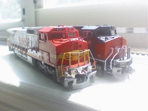

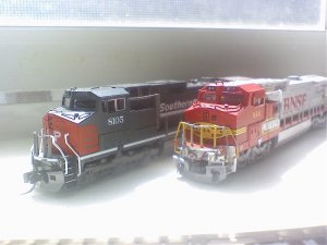

Whats going on everyone? Has anyone ever made any top of the nose grab irons for a Dash 8, either the C or the CW locomotives? I am impressed with the detail the Spectrum Dash 8s have. But the nose grab irons bother me because they are so thick. I have just gotten a hold of some brass wire. the only thing is that I have no idea how to bend it into that "bowl" shape . The Atlas Dash 8 locomotives have different handrails (they use the Dash 9 type) that use the six piece set instead of the four, so they are of no help. The first picture shows what can be done to the Bachmann locomotive to improve their grab irons. The ATSF unit is the Dash 8. The SP unit is the Dash 9. The Dash 8 handrails look fine but are way too thick. i wish to take it a step further and make it a bit more prototypical.

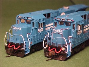

The Conrail Dash 8s are Atlas models, and I believe that if I can bend the brass wire to accomodate the wide cab unit, i can use the same wire to fit the nose grabs on the standard cab unit.

The BNSF unit, all I did was "pull up" the nose hand rails. they are included with the model but are painted black (white on conrail units). All I did was insert a small flat screwdriver and yank them upwards from the nose. Once they were at that height, they were painted with the ATSF red. All of the other parts (MU hoses, sunshades etc...) were factory installed by Bmann, including that grab iron on top of the cab. the Espee is a Kato. All ive done to it is add grab irons on the front of the nose, top of the nose, and the ones on the back of the locomotive.
That Atlas Conrail is a stock picture from the BLMA website I believe. I have a couple Atlas Dash 8s just like that and those are the types of modifications Im trying to make on em'. Sorry, I meant to post that but I forgot :mrgreen:

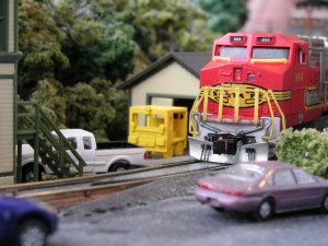

Nice! My BNSF B'mann Dash 8 must be an older Spectrum. It didn't have the lights and I had to install the plow and hoses, as well as take off the rapido coupler and install a microtrain. Clearly, I need to do some repainting where there was too little paint applied on the nose as well.

yeah, those handrails on yours are from the older run. They are the ones with the truck mounted couplers that you had to cut out to replace with the 1168s (I think). Nice job on that one. It looks nice.:thumb:
