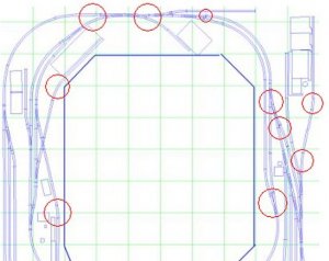

One thing you might want to do before locking down a plan is really go over it and make sure it will work. Unfortunately, just because it works on paper doesn't mean it will work on the board. You have a lot of track in a small space. I downloaded the picture of your layout and blew it up. The red circles are where I saw what looked like potential problems, odd angles, kinks, etc. I understand that from your original drawing, through uploading and downloading, and being enlarged, the quality drops off dramatically. What I was looking at was very fuzzy and so I can't say for sure that there are problems. They just didn't look quite right. I suggest that you take your original plan and go over it with a fine tooth comb. Enlarge it 4 to 6 times it's original. Then go over it bit by bit. Eliminate anything that even looks like a possible problem. Once you know that what you have is solid then you can start tweaking the fine points. A fraction of an inch here can be a disaster over there. Believe me, it's much better to be frustrated on paper than when your cars and locos keep falling off the track. :curse: :curse:
I hope I'm not discouraging you with all of this. Planning is one of the things that I enjoy most. Every plan I've ever done, I've torn apart down to the nuts and bolts a dozen times before I feel confident that there is a chance that it will work. I know that a lot of people just start laying track and winging it as they go. I tip my hat to them because I wouldn't feel good laying a piece of track if I didn't have a good idea of just where and how it should go.

Clark, you are definatly not discouraging me. In fact, you are just what I need. I am the kind of guy that would just say that looks good and start building. Thats why I have built so many layouts lately. I have finally learned its the little details that will make or break a trackplan. So please, anything you see, please tell me.
OK, maybe I should explain the trackplan. It is drawn with XTRK. Blown up to 1:1 all tracks flow smoothly and are joined. When I draw a piece of track, if it does not join, I will rotate or move the piece to join before I lay the next piece. At the size I have to use to upload, it makes the drawing kind of wavy, I guess you would say. I have studied the plan carefully and all tracks are joined. Plus, the graphic train with the program runs ok, and if there is a problem with a joint or a kink, it will derail. All curves have normal easment, and I am using Atlas custom line #4. Not snaps.

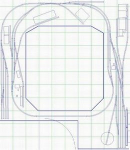

I made the changes you and Andrew suggested, here's the revision.
P. S. I also had the top section at 1.5' not 2' width. I resized it.
Thanks, Loren

I think that it looks really good Loren. I'm sure that you'll enjoy your switching duties much more with the runarounds. :thumb: :thumb:

The final design looks terrific. Every track has a purpose, and should be fun to operate.
