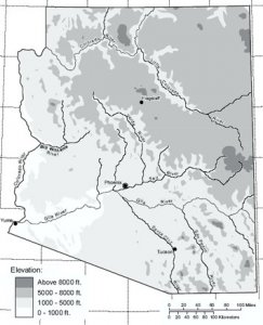

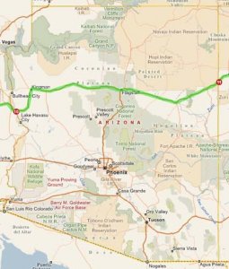

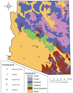

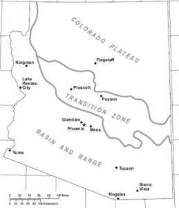

Will_annand said:
Elite Lancer, you have obviously never driven the area that Coyote is modelling. Arizona is all Plains and Desert. Only in the extreme West do you get the foothills, and then again, NO tunnels.
I'm not trying to correct you but being an Arizona native, actually, only about 1/3 of Arizona is desert, the other third is a transition zone and the final third is high plateau. Near Tucson is the furthest south ski slopes in all of the United States. Across much of the middle of the state stretches the Mogollon rim which consists of tall cliffs and expanisve pine forest. I do have to agree for the most part that the route along route 66 is pretty boring across that high plateau however, the region around Flagstaff is very diverse. The railroad passes through some beautiful pine tree forests across some pretty healthy canyons, through lots of rock cuts, and up and down some pretty steep grades. As the area around Flagstaff was very volcanic at one point, from a geologic standpoint, it is fascinating! There are some rail lines that do have tunnels but none along the route 66 corridor that I know of.
It was while camping up on the mogollon rim, that I broke my ankle. The camping trip was more than worth the inconveneince of the injury. Temps were over 100 degrees F in the valley (Phoenix area), and we needed jackets up on the rim. Sitting around the fire, in the silence of the pine forest, was an experience worth repeating.
Pete
Yeah, I've been to Arizona. I didn't know that the model was on a plateau. I couldn't find any geological maps that showed route 66 so I had to base my feedback on the vague information that it was in Northern Arizona which is what probably caused the confusion.
TrainNut said:
...actually, only about 1/3 of Arizona is desert, the other third is a transition zone and the final third is high plateau...Across much of the middle of the state stretches the Mogollon rim...beautiful pine tree forests across some pretty healthy canyons...
I felt that I needed some maps to back up what I was talking about and found some. While my fractions are off a little, you can see what I was talking about by the desert (ie. basin & range), transition zone and plateau (Colorado plateau). While route 66 does wander some, for the most part it follows I-40. Hope this helps. I will be visiting the Williams area in the next couple of weeks and can snap off some photos if you like although I have found lots of info on the net containing just such.
