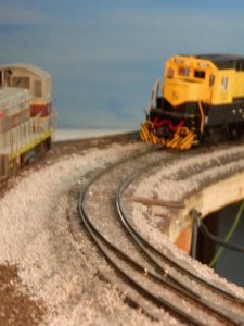

I just finished laying and wiring a new area of the layout and thought I'd post a couple shots. There is no scenery yet, just ballast. I actually posted a couple photos in the track planning thread then realized I should post a few here. The first local on the Garfield branch waits for the mainline freight to go by so it can enter the main.

Gary thats some nice ballast and trackwork.
Are the point rails on your turnout's one piece. I've handlayed track in the past but think I'll go with flex track on my new layout and build the turnouts only.
t.

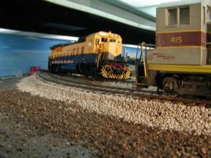

Thanks 88 and t, I've handlaid some of the trackage in this section, T, I am doing pretty much what you said you are going to do, handlay turnouts and use flex track elsewhere. My points are filed and bent to fit as one piece up past the frog. That's much easier than hinging them. The code 83 rail I used bends easily enough. Once its in place (I spike starting about 14 ties back from the points) I use a dremel cutoff disc to gap the frog. Before laying each rail, I use my Dremel drill press to drill a clearance hole for 20 gauge wire in the bottom, I solder the feed there. Each point has a feed, the frog has a feed, the stock rails have feeds. Operation is very smooth. I got a little carried away with one of the turnouts in this area. From point to frog is 13" on a 30" radius curve. Here is a photo. The gaps will be filled with styrene painted to match the rails.
Thats great work Gary, that is something I have never ever done, MAKE my own turnouts. I take my hat off to anyone who does.
Shamus
Originally posted by NYCentral
I agree with Shamus, I wish I could make my own turnouts! Great job Gary!!
I've never made my own turnouts either. And I have no desire to. To call my soldering skills "skills" would be an injustice to the word.:rolleyes: But I have done just the reverse: I've handlaid track (instead of using flex) and used commercial turnouts.
You're doing a great job, Gary :p :)
Wow. it feels great to be complimented by such talented modelers! Casey, I build my turnouts primarily because I can tailor them to fit a situation. In this case. a passing siding running along a backdrop out of easy reach required turnouts which would be within easy reach. By locating this one near the middle of a turnback curve at the end of a peninsula, it is easy to get at. I wanted it to match the curve of the mainline precisely, the outer route being a 30" radius, the inner only slightly smaller, thus the long points. BTW, there is no great amount of soldering involved, other than feeds, which all track requires anyway. Quite a bit of filing though! They don't have the fine details that some of the better commercial turnouts have, but they work great.
T, there is really no difference in building curved versus straight turnouts. I never work with a fixed frog #. After laying out the centerlines for each route and gluing down ties, I lay the stock rails first, filed to accept the points later. Then I file the frog points on two lengths of rail and use the NMRA gauge to locate where the point of the frog should be. When done this way it makes no difference what degree of radius you use. And you get nice flowing turnouts.
Gary

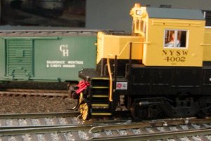

First, I can attest to the operation of your hand laid turnouts. Not one problem, all evening!
Then, it was nice to see the SM&CH boxcar in the background, Thanks. There was a JGL hopper running at Trainfest, and, I hope Tyson sees this, There was a Nantahala Midland box car there too.

Pete, Your car is featured more prominently (and noted) in a photo in the trackplanning thread Thoughts behind the design of the JGL. Also what I thought was the best photo of the Suskie units on the curve.
