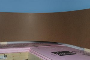

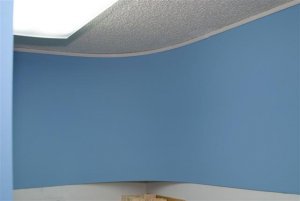

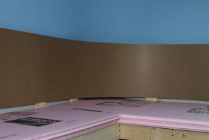

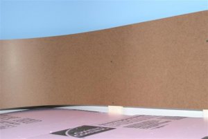

I am in the process of building a new layout (this time, it will be an "around-the-room" layout). After tearing out my old benchwork, I decided to address all the things about the room that I didn't like the first time around... so I put in new lights, a larger "panoramic" background, etc.
The benchwork is now up, except for the area in front of the train room doorway (it has a "pocket door" (sliding door - that stores inside the wall when opened). The main reason I had to give up on my old layout, was the pop-up in the center of the table was causing me to have constant back problems... so I do not want to have a "duck-under" at the doorway.
I need some advice on building a lift-out section... after a lot of thought, I have ruled out a gate section (as my aisleway in the center of my layout is only 22" wide, and that would just compound that shortcoming. A swing-up section is also a poor choice due to space & clearance.
Any suggestions will be welcome.... Bob :confused:
