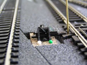

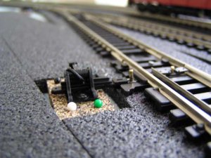

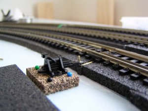

Update 07/27/2006

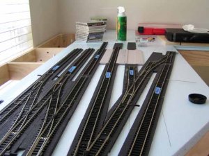

I tried my hand at installing some manual ground throws this weekend. A bit of .042 brass rod and some glue, and wow! I like it.
The staging area is about 75% done. In the pics, you can see my main line (to the far left), Yard A, Yard B, Loco Service A, Loco Service B, and the Programming and storage tracks.
I tacked down a few more feet of roadbed last night, and will be adding track to it tonight. I got my Digitrax system, and still have not hooked it up. I WANT TO RUN TRAINS!!!!!!

Lynn:
I have the ones with "spring" in them. They keep a constant tension on the points to keep them from moving. So far, I love them; they're just kinda tedious to put in.

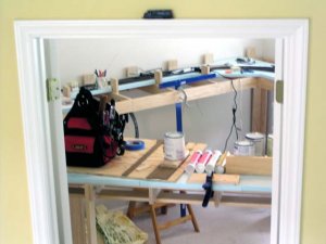

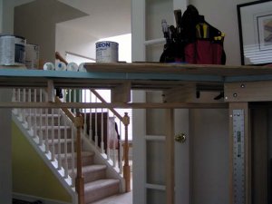

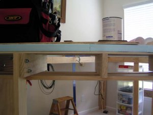

Update 07/29/2006
Well another Saturday has drawn to a close. I ran out of flex track on Thursday night, so I guess another visit to my LHS is in order :D . Too bad it is an hour away. Anywho, since I had no more track to place down, I spent today working on the duckunder part of the layout.
I torched my compound miter saw about 2 weeks ago, so before I could do anything today, a trip was needed to the local Home Depot to get me a new compound miter saw and the wood needed to finish. Boy am I glad my wife doesn't keep tabs on me and my trips to HD and LHS. . . .
The benchwork is complete and the extruded foam is on top drying as we speak. I'm going to visit my parents tomorrow, so no work scheduled. Here are some pics. Enjoy!
