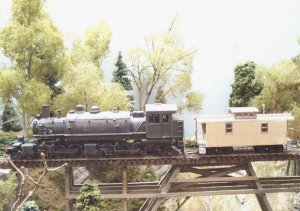

This is a Gloorcraft kit. It was supposed to be Delaware&Hudson caboose, but it didn't quite look like one. I just finished the construction. Once it's painted, it and the loco will get lettered for the Shinnecock Hills Lumber Co.

That articulated tank loco looks cool! Tell me something about the prototype!

The Loco is a Mantua, one of the 2-6-6-2T's that were standard gauge versions of the 3'gauge Uintah railroad. I removed the square tanks and replaced them with the wrap around tank from a Model Die Casting 0-6-0T. The loco cab is also from the MDC.
A very similar engine was used by the Feather River Lumber co., and Weyerhauser also had a similar engine. I used photos of these to modify the Mantua. I also used a considerable number of brass castings to "dress it up".
Sorry, it's not for sale, after all, it's articulated.
