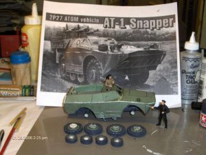

Altho too late for the competition, I am working on a 1:35 scale build of the attached. Work is in progress: need to learn the new camera!
Regards
Jim

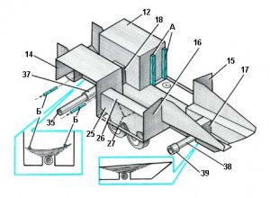

Building the "Junior Technician" 2P27 BRDM ATGM Vehicle

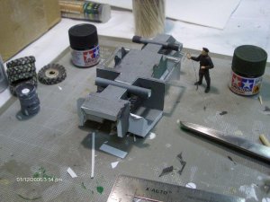

Work on this model is progressing slowly but surely.The hull assembly, springs and axle sleeves have been assembled. When /if I build this vehicle again, parts #25 (the sides of the belly wheel housing) need to be reinforced with heavier cardstock. So far, the fit of the parts has been reasonably good.
Next step is to assemble the wheels: 8 in all.

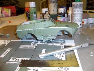

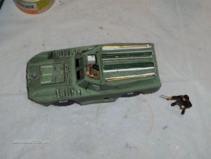

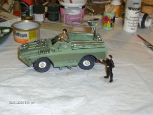

Work in Progress: (2P27 ATGM Vehicle)
I added inner fenders so that the model would photograph better. The front and side armour is in place. Fit so far: so good.
There are no locating points on the body shell for the detail parts, so I had to mark these myself from a scale drawing. The intention is to airbrush the entire model with good ol' Soviet Armor Green. Note that I have opened the hatches and made provision for a figure.
The vehicle is pretty close to 1:35 scale. Now for the "fighting compartment and the ATGM launcher.
More to follow!
Jim

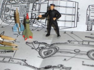

More W.I.P. Shots of the 2P27
Here are a couple of more pix of Work-in-Progress on the 2P27:
Jim

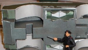

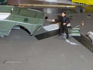

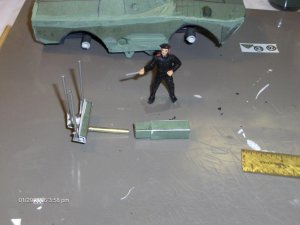

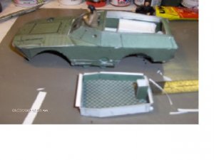

Here you will see the scratchbuilt trim vane for the front of the vehicle, awaiting attachment.
The rear section of the armour has not yet been secured to the vehicle sides, pending fabrication of the "fighting compartment". At this point, I discovered that the rear section of the armour was approximately 1/8" (3mm) too short, even allowing for the inward slope of the rear panel. This is, no doubt, due to an accumulation of errors in trying to fine-scale the vehicle. We will bash on regardless!

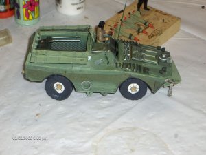

For every Problem, there is a Solution
I have to say that this is indeed an interesting form of modeling! You really need to plan ahead, much like scratchbuilding, or doing a wildlife carving for that matter! The encouragement helps a lot, guys & gals!

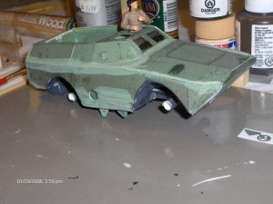

Here is a shot of the problem with the fit of the rear armour. It was solved by adding a strip taken from a spare sheet of parts (try doing THAT with a $35.00 plastic kit!!). The rear end of the vehicle has been tack-glued together after trimming (photo 10).
More to follow!
Jim

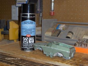

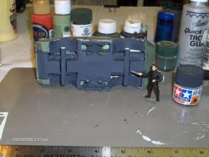

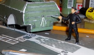

Building the 2P27 ATGM Vehicle, Cont'd

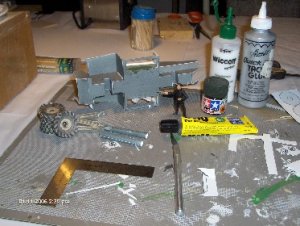

The model gets a couple of light coats of "Tuffilm" spray fixative. (This is like Testor's Dullcote, except much finer). This will seal the card surfaces to permit painting. Then the underside is painted with Tamiya Panzer Grey , and the "welds and joints" get a coat of light green acrylic "primer".
By the way: have plenty of ventilation when spraying TUFFILM!! Its vapors are quite vile......

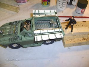

Socialist Industry?

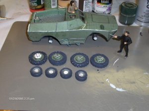

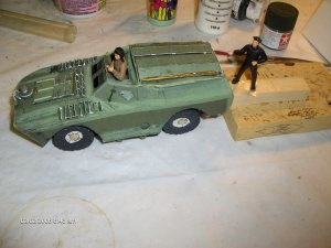

Here we see the vehicle so far. Some detail parts have been added, and the "Mark I" version of the overhead doors for the rocket compartment has been dry-fitted (as have the wheels). Note the "piano hinge" made out of .005 sheet brass and some rod. I do not like the overall appearance of these doors. I am going to re-make them, saving only the hinges.
More to follow!
Jim
