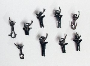

With Kadee's, there are quite a variety, even for NEM, this little lot is only part of my collection of differing Kadee types. Most Bachmann rolling stock have the facility to add the standard Kadee #5 or indeed sometimes comes with a similar type fitted. This website and the photos below should give you an idea.
http://www.ablehobby.com/kadee__parts_page1 couplers _june_03.htm
Shamus
