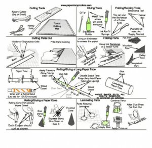

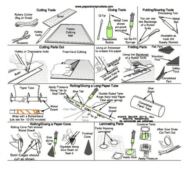

Tools
Here is a diagram that lists all of the basic tools you will need to start building paper model.
As you get better, you will find other things that you will want (or need) to help you make even better models.
Not only that, but if you see something in a thread (i.e. a techniques, or a tool, or what ever) that sparks your interest, contact that person and ask him/her about what ever it is that you are interested in.
I hope that this will help you.
Good luck and I look forward to seeing some of your work.
