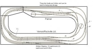

Here it is. There's a few things that need to be corrected, but it's close. The tracks on the outside are hidden to create "surround staging", a la, Mike Hammer. I don't have a bunch of industries, but I do have two interchanges and expect a bunch of through traffic to have to deal with while switching out a few cars going and coming from Rockville and other points beyond. I'm more of a scenery guy and like to see trains pass by.
AS you can see, I've tried about everything that Russ had mentioned, except instead of keeping it all one elevation I have the mainline leaving Vernon (notice double to single track bottleneck) rising and passing over the lead into the hidden staging. I didn't have to do it, but I was trying to hide the staging tracks, which will be covered with removable scenery chunks. I may regret it, but I'm leaving the design open-ended for changes. I designed it very conservatively knowing that there might be a slight chance of me making a mistake while designing it.sign1
The strange jog in the upper left corner is a swing-up bridge section that has a few tracks that need to align when dropped into place. The door needs to be reversed to swing out of the room, but I haven't filled out the proper evironmental impact statements yet to proceed. I may just wait until the inspector is out for the day and I can sneak in and suprise her.:rolleyes:

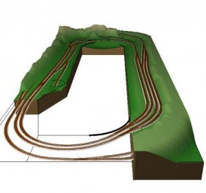

Sorry about my lack of terrain mesh manipulating abilities. I use the program just enough to barely remember how to do certain things. wall1
I use 3rd Planit if you were wondering. Cool program, but it takes some hours of playing to get used to.

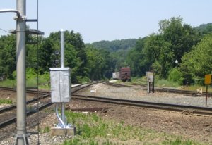

The real Palmer, MA

You're welcome to copy and slice and dice as you wish. There's a lot of double track in mine, but that's how it was in 1900, the era I model. you could very easily knock it down to a single track and stuff sidings in all over. With a 2 ft wide shelf you'll still have plenty of building's space.
It would be nice to have a couple of reversing loops to simulate the rest of the railroad and terminuses? termini?:confused:, but that's not gonna happen here. My office desk is below. It's a long u shaped table/desk making a 3ft walk way down the center and set the limits criteria, so the layout will be an exact outline of the desk. I thought about some protruberances for correct turntable location, but I decided I'd end up regretting even thinking about it.
The mean track height from the floor is 54" ( I like 'em high, plus I needed the room below). My last shelf layout was up high, too. It was actually a great testbed for this layout and it was only 12" deep. The perception of depth is easier to trick the higher you get to your eye level. However, being that high up puts everything between you and the backdrop in danger. In my case, I really didn't have a choice.
