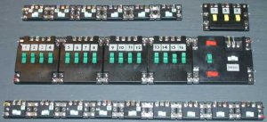

I am having problems with my layout when hooking in an Atlas Controller (#220) to control a turntable.
According to the Atlas wiring book, the common rail needs to come of the controller "C" terminal. I did that and my trains do not operate. If I take the "C" off the two cabs (soldered together), the trains do operate but the controller needs to be in a specific (presumably off) position. I can then use the reverse switch on the cabs and the locos does reverse correctly.
Again, according to the Atlas book, when you do use a controller, you should not use the reverse switches on the cabs but rather the reverse sliders on the controller, one for Cab A and one for Cab B
It seems like I have some type of short or perhaps a faulty controller.
This is for my main line, where I guess I could avoid the controller entirely since it is just for the motor of the turntable. But when I get to my yard, I have 2 reversing sections, for which I believe I will need the controller. And hance even greater concern.
Anyone care to offer suggestions or tips?
Thanks

answers to questions
Power pack A is connected directly to the controller
power pack B has one wire connected to the controller and another wire connected to a series of selectors that have all been connected together and to the controller via spade connectors (this connects to the second terminal for the power pack on the controller).
The positive and negative leads are both connected (one indirectly) to the terminals on the controller
The controller is not the first device connected to the power packs. It is for 3 of the 4 wires coming from the power packs. The 4th wire first connects to 4 selectors and then connects to the power pack. See the attachments on this thread for picture of the control panel
The X & Y are wired to the motor terminals that drives the turntable. I have the turntable bridge track connected to the same selector as the track that leads up to the turntable (same block). I am using an Atlas turntable. Could this be the problem? Based upon everything I have seen only the motor was supposed to be connected to X and Y, to turn the turntable clockwise and anticlockwise. the bridge track has been shown to be connected in parallel to usually the lead up track.

If you are using the Controller to control the turntable drive you are correct in connecting the X & Y from the Controller to the X & Y on the turntable.
There appears to be three problems with your wiring.
First, both of the positive and negative leads from both of the powerpacks need to be connected to the Controller.
Second, the turntable bridge should be wired as a seperate block from the turntable lead, any stall tracks and any other blocks on your layout.
Please refer to the Complete Atlas Wiring Book. The diagram in my 2000 version is on pg. 53, Figure 7-7.
Third is probably how you have your common grounds connected. There should be only one common ground connection to any of the Atlas wiring components that you are using. This should be connected to the C connection on the Controller. If you are using multiple Controllers it should be connected to the C connection of furtherest Controller that is ganged from your powerpacks.
Please refer to the Complete Atlas Wiring Book. The diagram in my 2000 version is on pg. 16, Figure 2-11.
If you have multiple ground connections, such as to blocks on the layout and the turntable, a way to wire that that you should considered is this.
Bring all common ground connections to one side of a terminal strip.
Cat # 274-670 at Radio Shack, $2.49 each.
Connect the terminals on the other side of the terminal strip using a jumper strip.
Cat # 274-650 at Radio Shack, $1.99 each.
If you have more than eight common ground connections,this might be the case if you gapped both rails instead of one. I did this. You can gang the jumper strip side of the terminal blocks by uisng an additional terminal strip cut to fit or using a wire to connect the jumper strip sides of the terminal strips.
Bring one wire from the jumper side of the terminal strip to the C connection on the Controller.
I think if you wire it in this manner, it will fix your problems. Let me know this helps.

Perhaps another question is worth asking. I have connected the power packs to the terminals on the RIGHT of the controller. I just looked through every layout book that I have that uses Atlas components and the cabs always connect to the controller on the LEFT terminals. I am wondering if perhaps, even though it has never been explicitly stated that the terminals are not symmetrical and that you must connect the cabs to the LEFT terminals and then the rest of components to the RIGHT terminals???
David,
That is the problem. The Controller must be on the left side of your control panel. If you look at Figure 2-9 on page 16 of The Complete Atlas Wiring Book, you will see a circuit diagram of the Controller and see why.
I'm sorry I didn't catch this earlier, but when I first replied to you, I didn't see your picture of your control panel. You did a nice job on the panel, but you need to bring the power in on the left side and move your Controller to the other end.
Yep, when i carefully read the electrical schematic of the controller, the left and right terminals are NOT symmetrical. the left are inputs and the right are outputs. If I was at Atlas, I might have labeled these as such to avoid this type of problem. There is not a single note anywhere that indicates this other than the implied arrangement from all their diagrams...
thanks again for the help. it all works now..
