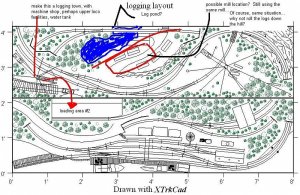

ok,heres my plan with some improvements,i removed the flume,got rid of the log pond and took away some town buildings near the mill since the grade would be too much anyway,although they could be half in half out of the hill...anyway i left the mill since i've started to build it and really love it so far.i added the heel boom in the right camp and a high lead in the left camp and would like to add a loader to this spar making the switchback for loading the mill and spar tree.i also replaced the open space where the pond wasa with the main camp.i figured it fit pretty well. i think the improvements made a big difference.theres a bunch of green space by the tunnels,partially hiding them,which was what i was goin for.anyway,comments are greatly appreciated.ill be making another plan as i've got some interesting ideas....anyway,here it is!--josh

Well, its looking good! My only real misgiving is the location of the mill. I'd rather see lower myself, so you'd get the sense of travel and moving materials from one place to another. What kinds of cars are you going to be using? Primarily flats with roughed/finished product?
Here's what I'm thinking (but these are just my thoughts...)- on the attached file...
However, there is more unity with all the major industries being on one side and the loggin operation on the other. I guess it is really up to you.
The original lillipu logger placed the mill next to the yard and docks...
Also, what type of track are you going to use? Do you know what parameter files you are using to plan this out with? I'm trying to find something that has templates for curved switches myself.
you've got some good points and ill try to switch it now,ill just keep the track generally the same but switch industrie sides.the original had it on the other side but also used a 15in minimum radius on the branch and it had a VERY small mill.i love the process so i wanted a large mill.ill post changes either in a minute or ill wait till tomorrow.
car wise ill be using anything 40ft and under.skeleton cars for logs,flats for lumber,boxcars for supplies,and some refridgerator cars for the packing plant.for track ill be using C83 flex with atlas turnouts.all this was done with Xtrk and came with the program.thanks.--josh

Josh, I think the changes you have made to both the lower yard and upper yard are spot-on. The only thing that seems awkward about your revised trackplan is the track that crosses though the backdrop to reach loading area #2. Perhaps what seems weird is to have a siding seemingly coming out of "nowhere" (through a hole in the backdrop) to service an industry. maybe eliminate the backdrop altogether, and hide the two halves of the layout with tall trees or a high ridge?
Kevin
i got rid of the mine and made it another loading area and made the switchback just that,as another loading area would crowd it and i dornwant to add a spur off of the switchback.ill jus say the huge mill supplies cash for the tunnels :mrgreen:.well here it is with inquiztrs ideas.--josh
