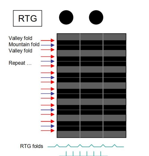

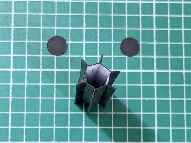

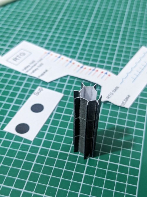

Radio-isotope Thermoelectric Generator:

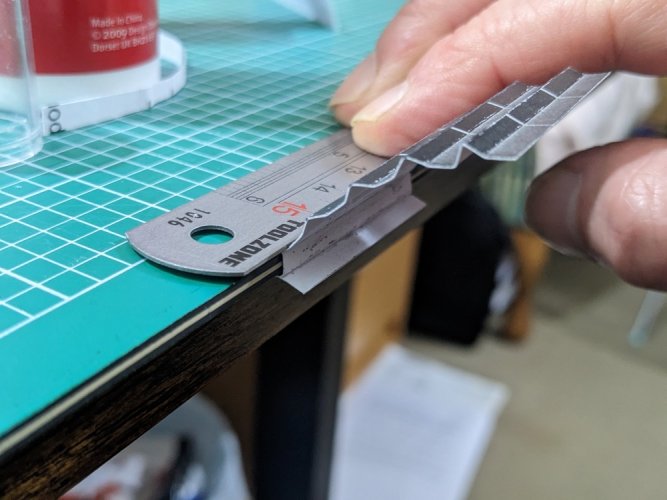

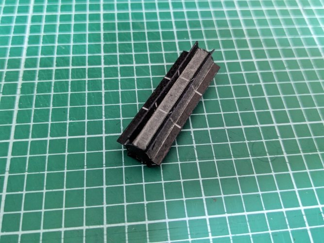

Folding and gluing the fins is fun! Requires patience - improvising clamping along their length off the end of the cutting matt/table! Hint: Folding the valley folds fully before gluing makes it easier to access the mountain folds which you glue together. It's more obvious when you've got the part in front of you than to describe well!

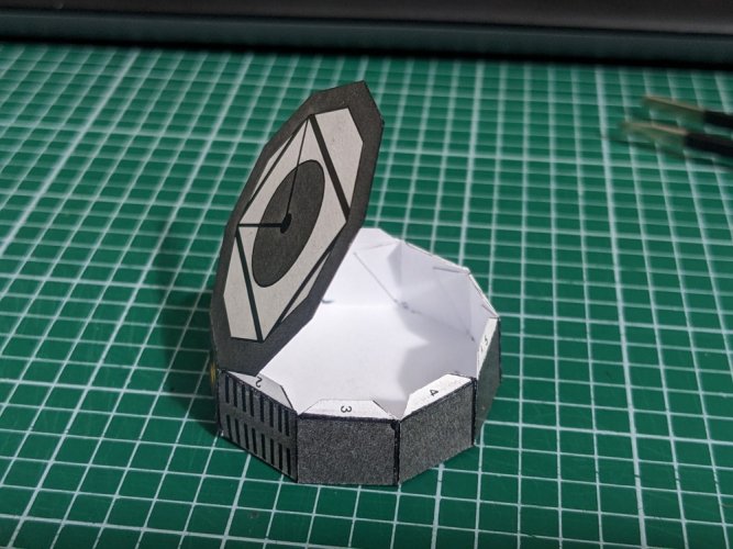

The mountain folds all glued up. Handily it sort of forms the circular shape required for gluing as a cylinder.

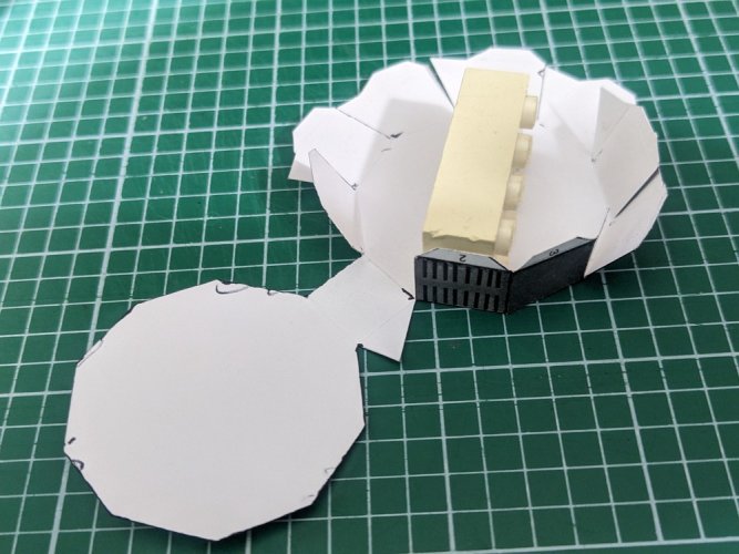

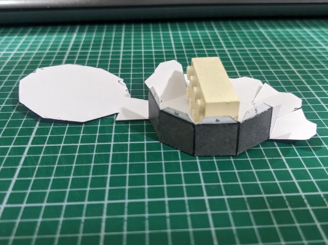

With the top and bottom circles added. I cut the circles slightly smaller so they fit better around the hexagon body. I thought as printed they're slightly too large.

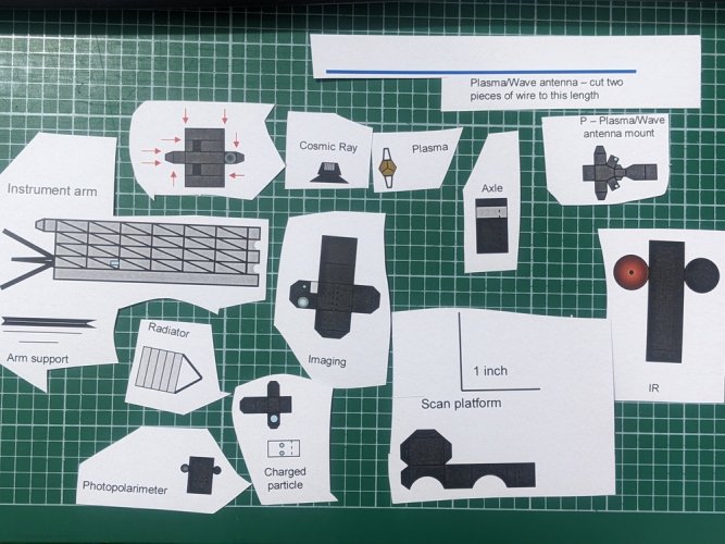

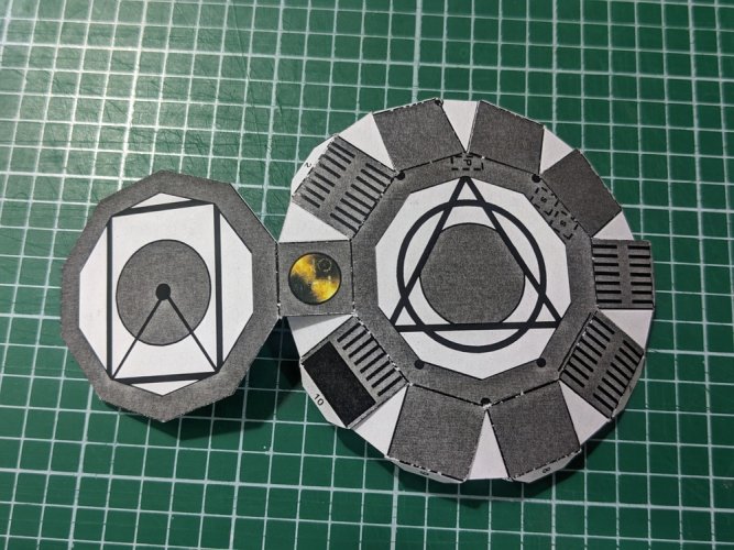

Instruments and Instrument Truss:
Here are all the instruments for the opposite side to the RTG. They look reasonably sized don't they?
They're not! Most are small and some are very small! :)

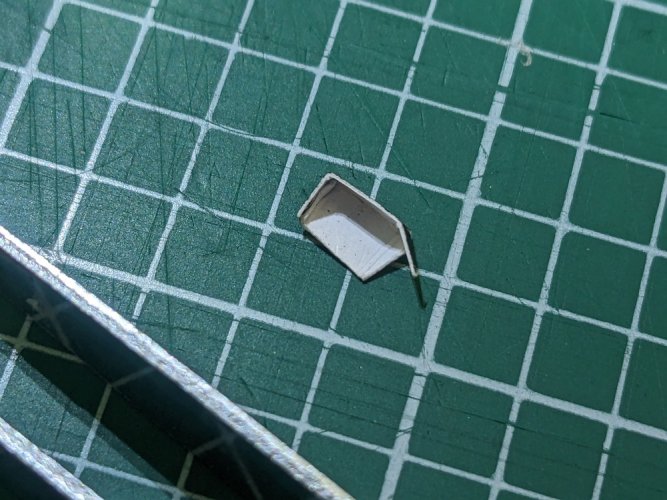

This is the Cosmic Ray Subsystem. The underneath flaps needed a tighter angle in order for the back to be able to fold over so the sides would make the right 3D shape.

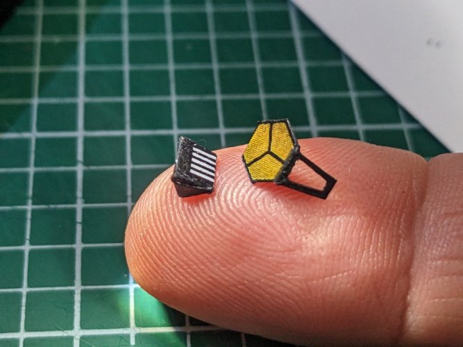

Cosmic Ray Subsystem and the Plasma Experiment. As you can see, pretty small!

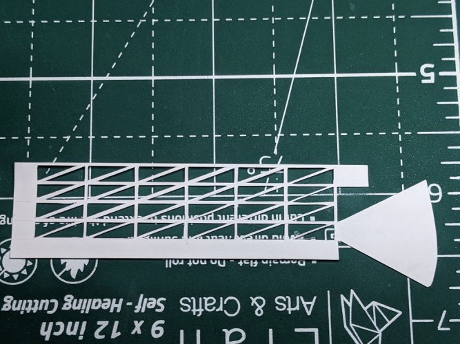

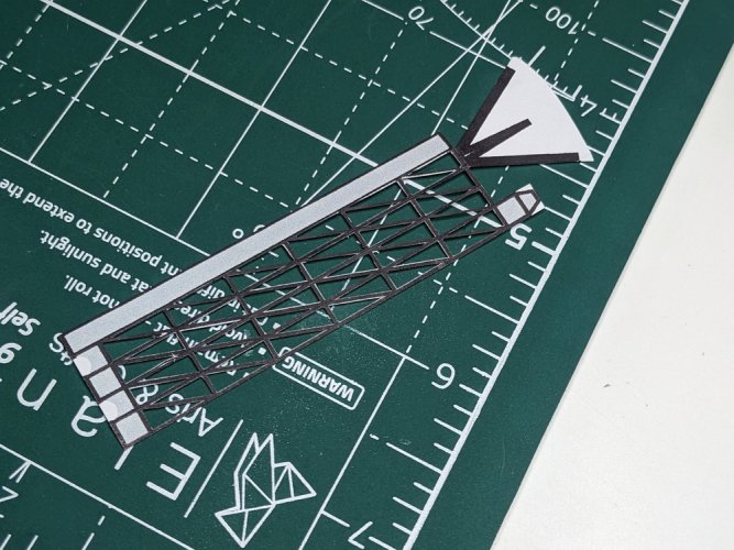

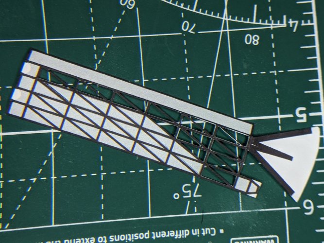

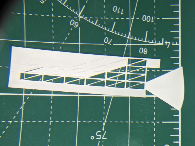

Instrument truss. The graphics on this are different from in the instruction photos - there the truss sections are the same shape as the MAG boom, whereas on the printed sheets they are elongated (each section = 2 sections on the photos), and are shaded in grey. I did consider seeing if I could make a proper frame of it by cutting out all of the grey and leaving the black "skeleton" but I don't think it'd have enough strength to hold everything. Perhaps once I've got the hang of reinforcing with Superglue I might have a go, also with thicker card. There are only 48 triangles to cut out (and working out a way to glue the long edge without overlapping card). The trouble is, if I do it for this one, I'm going to want to do it for the MAG boom on the other side (which we haven't got to yet), and that has ... 236 ... triangles to cut out. :surprise:

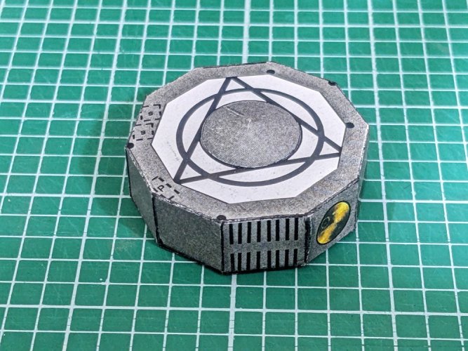

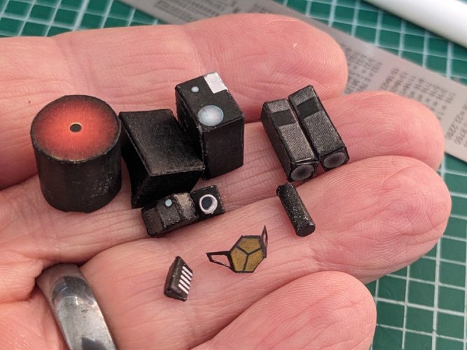

Here are most of the instruments made up. A little bit of colouring still required to tidy them up, but nearly there.

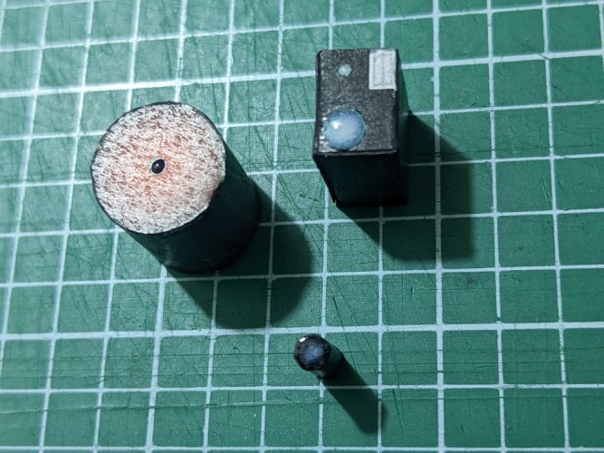

Having been shown the UV glue marvel, I took up @zathros 's suggestion and added some "lenses" (plus added a little more detail on the image camera on the right found on a pbs website photo of it https://www.pbs.org/the-farthest/science/voyagers-scientific-toolkit/). Thanks for the tip!

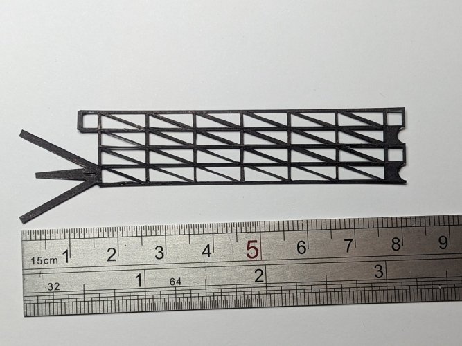

Instrument Truss:
I'm back! Did some work at the weekend ...
I previously posted a picture of the instrument truss as printed from the file. The gaps between the latticework are filled in with grey to reduce the effect.

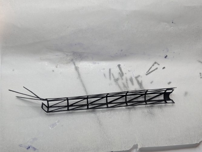

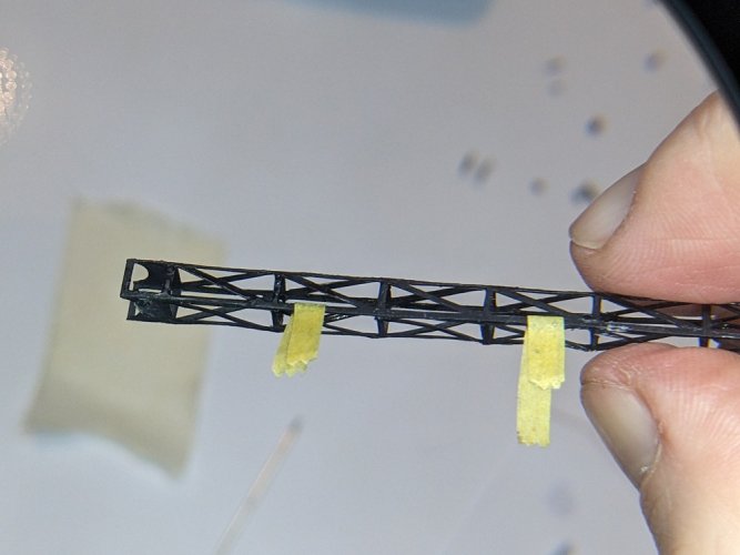

However, having been advised by Zathros (I listen to you Zathros ;)) to strengthen other trusses and thin support bracing with superglue, I decided to experiment with this and see if I could construct it as a proper hollowed out lattice.
So I cut out the 48 small triangles and other bits at the ends (having scored and folded along the length before I started cutting - knowing what remains would be very flimsy). 4 hours work, with only one slip and cut too far through one of the truss sections - repairable with glue later.
Then time spent blacking all the edges, tidying up here and there (the card started to delaminate at the fold lines in a few places because the width is so narrow, less than 0.5mm in some places); then trying to fold it as much as possible before gluing (it has to be superglued in the final shape because trying to score and fold once superglued is very difficult). 2 hours work.

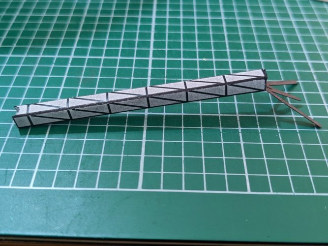

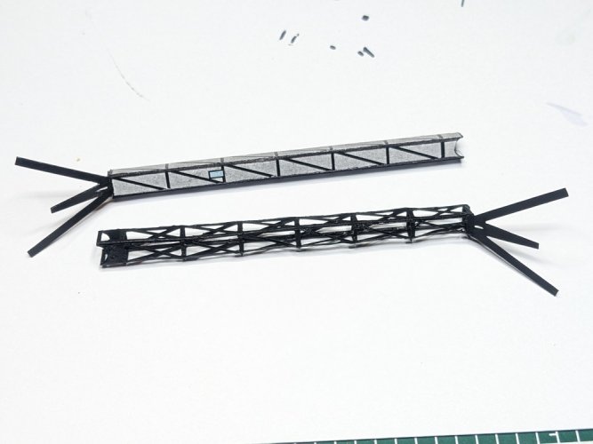

Then application of superglue down the length to make the box shape, one side at a time. I used Starbond EM-02 which is superglue with the consistency of water - it runs everywhere, bonds almost instantly, but is really easy to cover an entire face of this just by putting a few drops on a bit of greaseproof paper and rubbing the latticework over it. It's expensive here in the UK but worth it for certain applications.
Then applying normal superglue to the inside faces through the holes with a cocktail stick.
All the superglues I've used dry rather shiny or at least satin, so then needed to paint all surfaces, inside and out, with Tamiya Flat Black, and then a final coat of Vallejo Matt Varnish. Another 2-3 hours work.
I even managed to keep it relatively square on looking down the middle too (easier with the eye than a camera!)

It does make me think ... can I succeed at doing the same with the Magnetometer boom/truss - triangular cross section, 25cm long, 240 triangles to cut out ...
