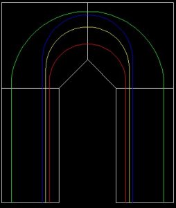

Has anyone made inside corners for an N-Trak layout? With the design I am going to try to build, I will need 2 3'x3' corners to complete a "U" shaped turn around. See drawing for idea of what I'm talking about:
Has anyone made these? What kind of turn radius can I get doing this? Any creative ideas on how to handle this?
These don't necessarily have to fit N-Trak standards on turning radius.... but I would like to have it at least run smoothly.
I don't know how much space you have or how important the mountain division is but a simple solution is to use standard 3' corners in the following configuration.

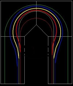

Here is something at least the shape you were looking for. Autocad Lite isn't the nicest program to sketch with (especially in the hands of an engineer or so the cad operators at work keep telling me)
Basically extended the straight portion of the yellow and blue lines to 8" and 12" respectively. This configuration gives the red line with about a 16" radius, the yellow line with a 17.5" radius the blue with a 19" radius and the mountain division is 32".
You should be able to make these a little bigger by curving the straight sections out a bit.

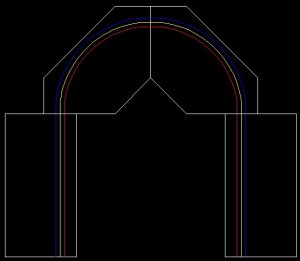

Guppyman, you say that you really don't want to connect your modules to others.
Now wouldn't it be possible to plan one end of your 'straight' modules together with the corner modules, so that you can lay out much broader and sweeping curves? This could also offer more scenic possibilities. :cool:
Just a suggestion. (And Garry, please excuse me for spoiling your drawing! :D :D :D )
