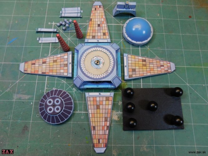

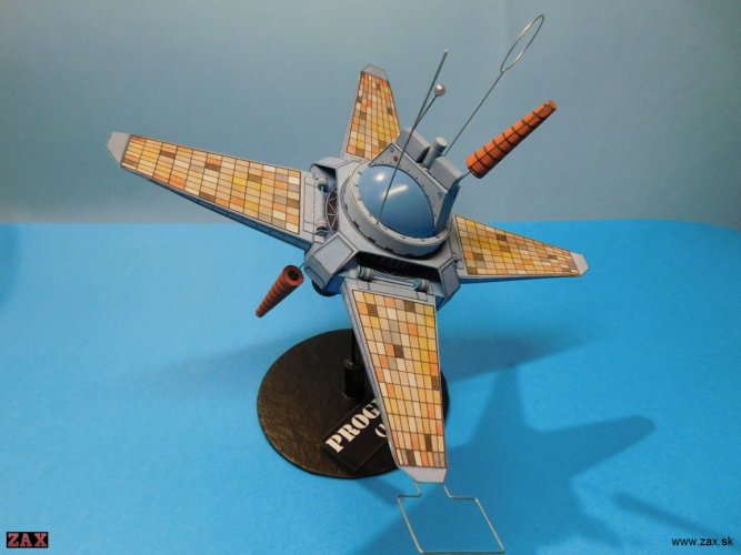

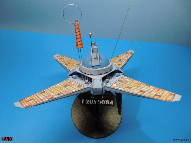

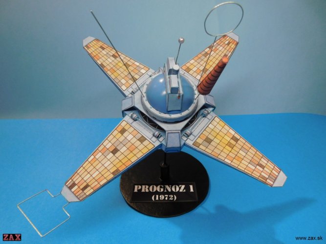

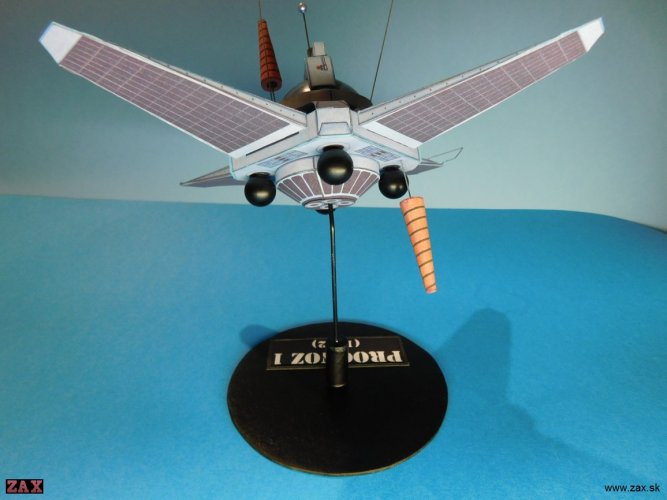

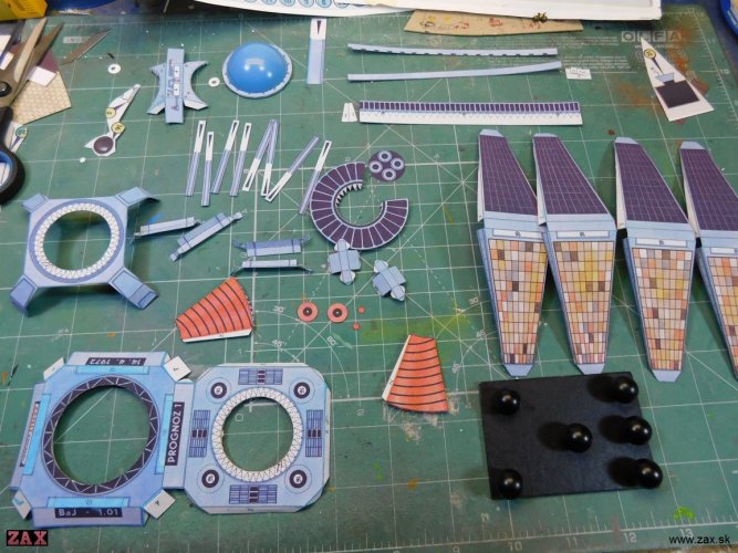

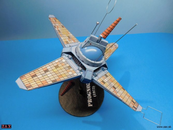

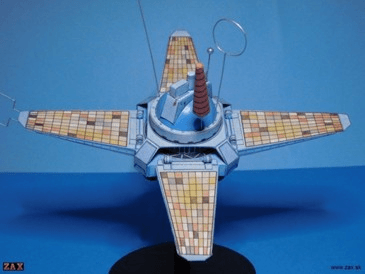

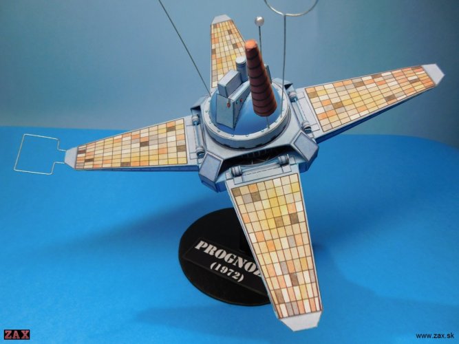

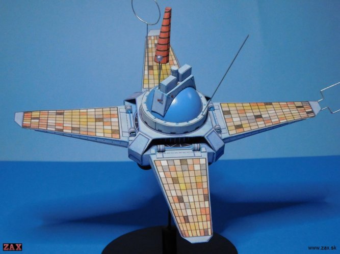

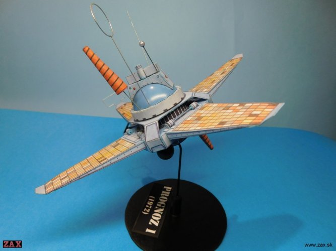

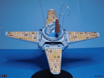

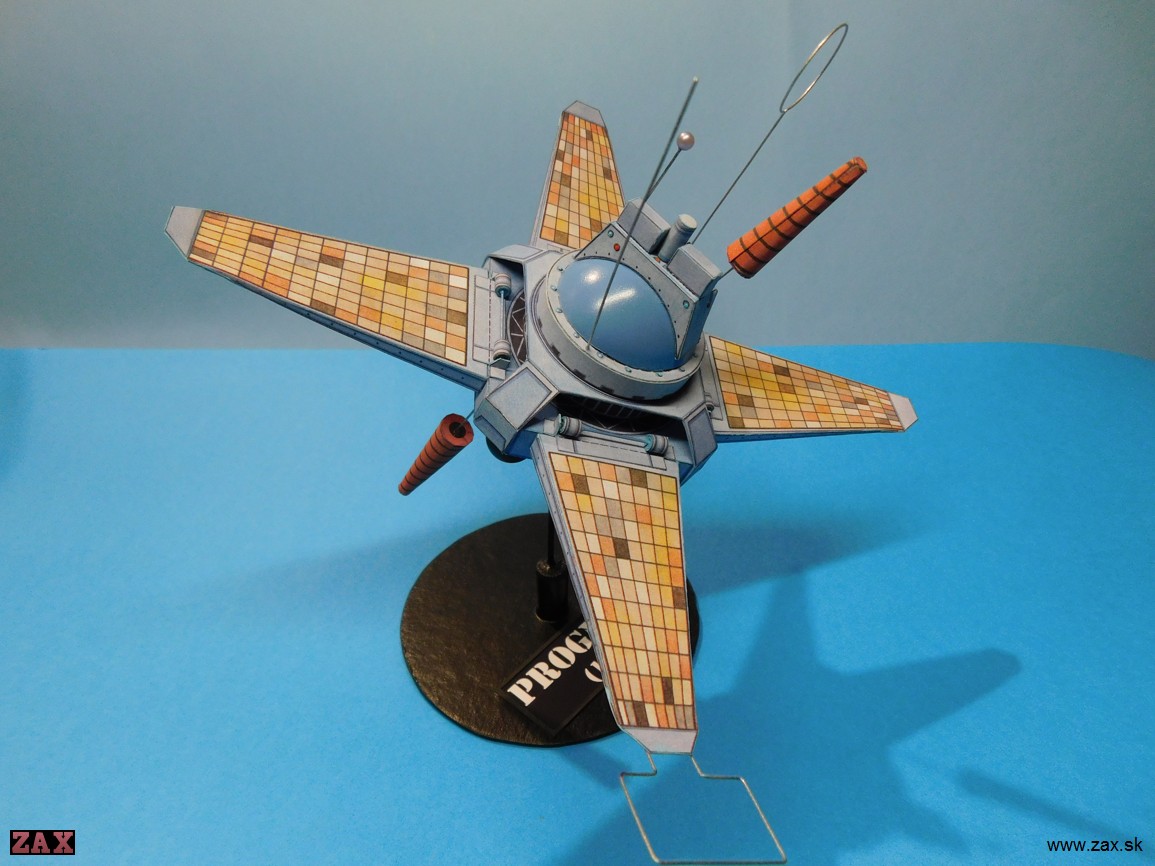

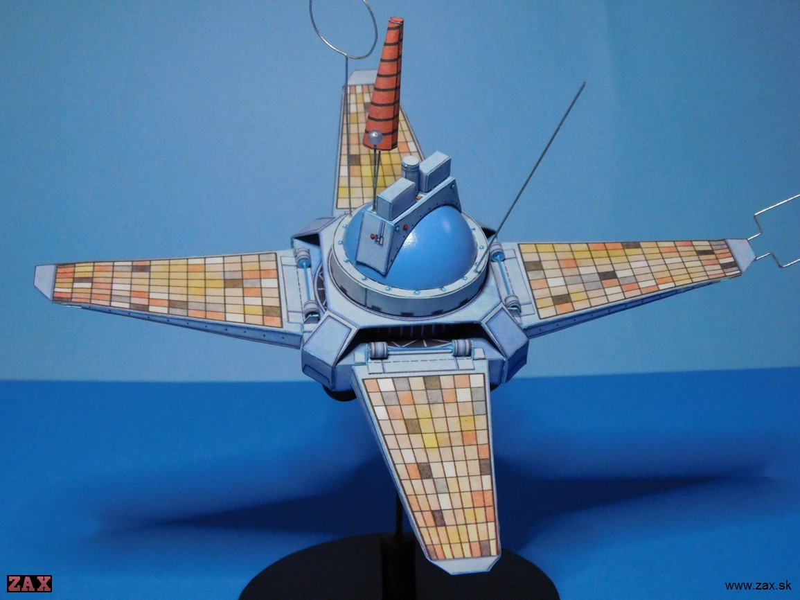

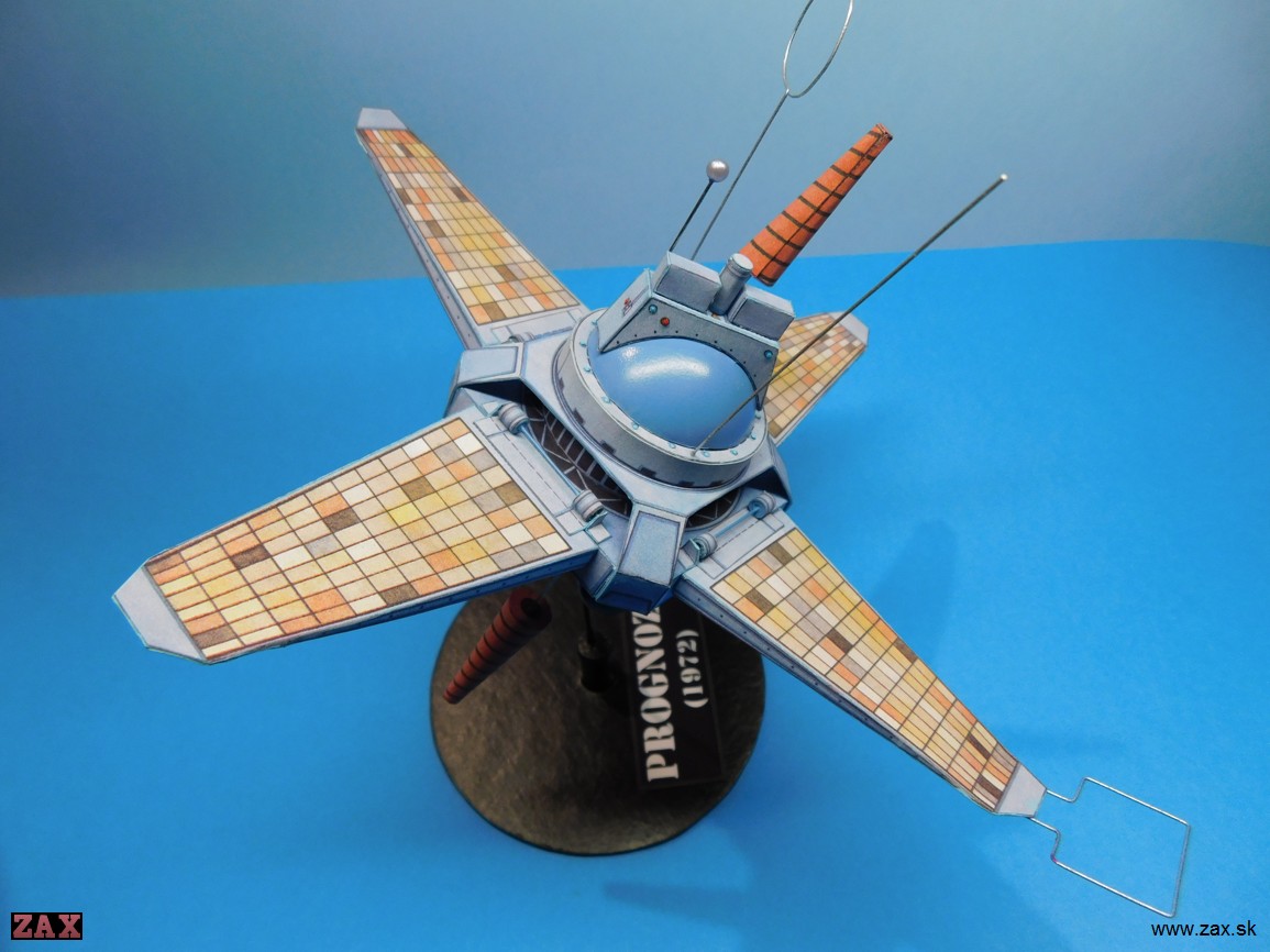

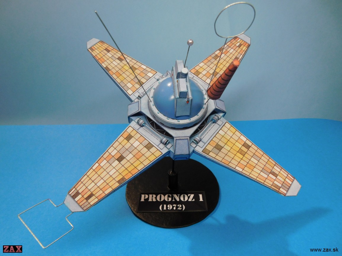

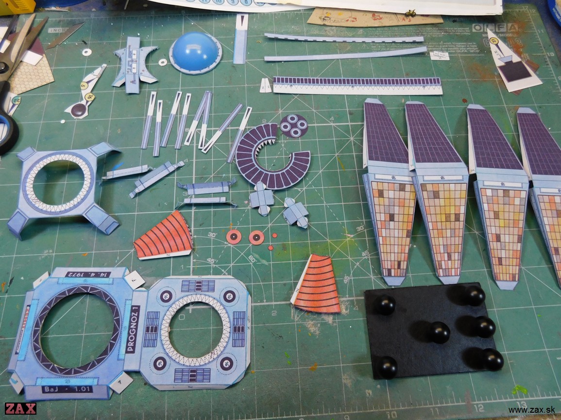

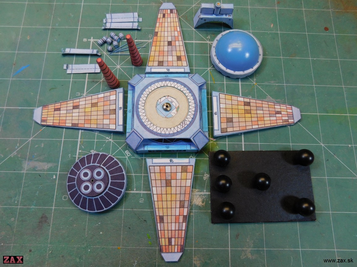

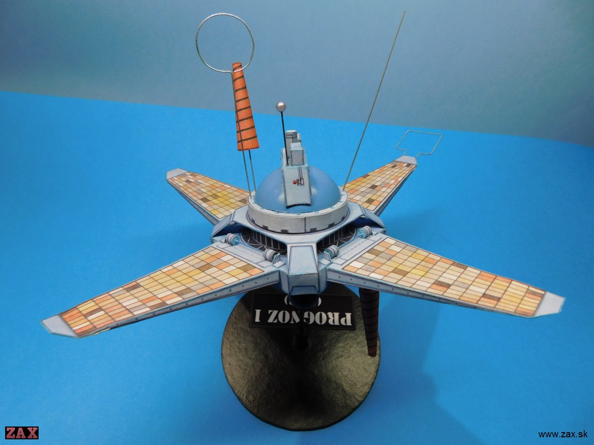

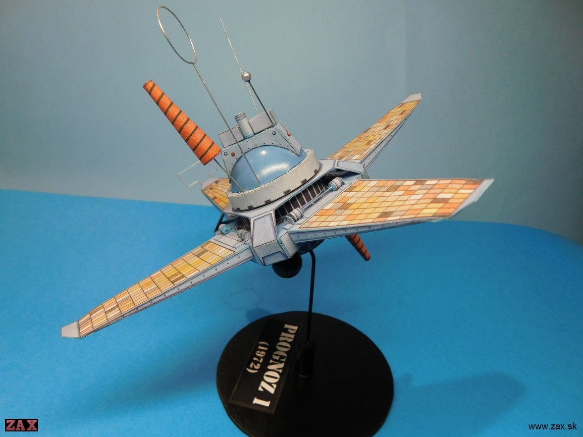

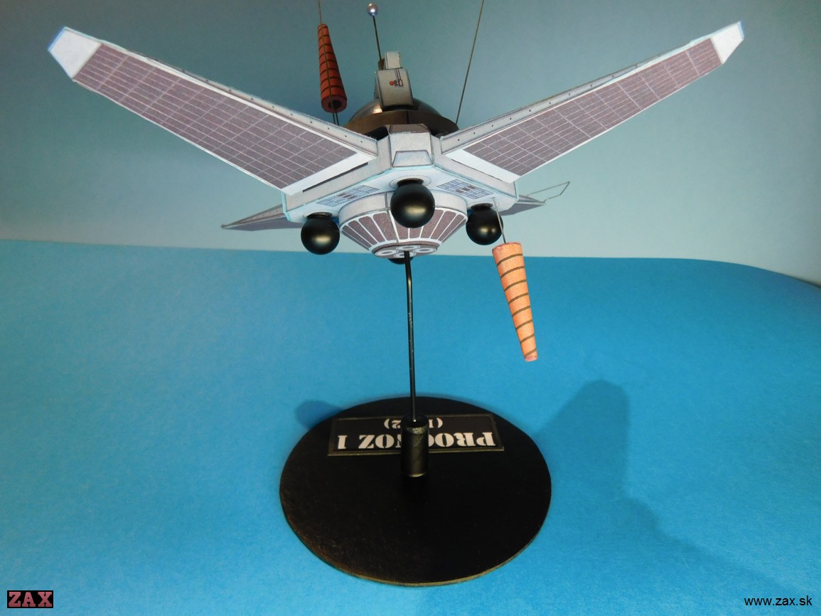

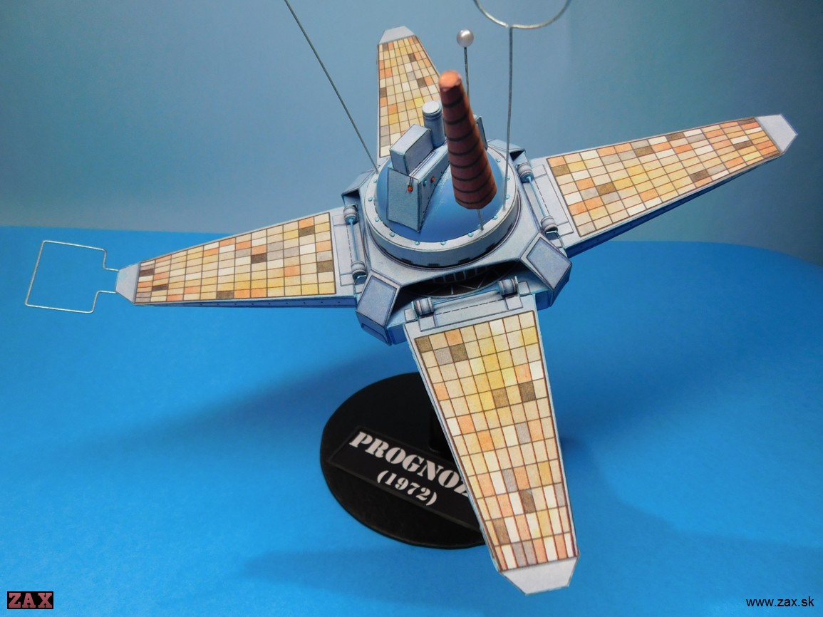

I'll glue the Prognoz probe first. I have the model cut and retouched, so I can start gluing. used non-paper parts:
-kupola (trimmed pinpong ball)
-antennas (wire)
-nitrogen tanks (bearing balls injected black)... I have the model cut and retouched, so I can slowly start gluing ... ;)
Slight progress, I have glued the basic parts of Prognoz 1, now I'm going to start assembling it slowly ... it stuck well, I just didn't think that if I glued some parts, it wouldn't fit me ... so I had to adjust a few things ... I glued the nipple inside the probe in preparation for the stand.
As a stand, I will use the spoke from the bicycle string, which will be anchored in the pad on one side and the other end will be screwed into the nipple in the probe ...

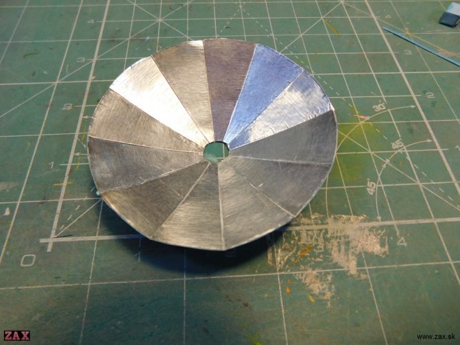

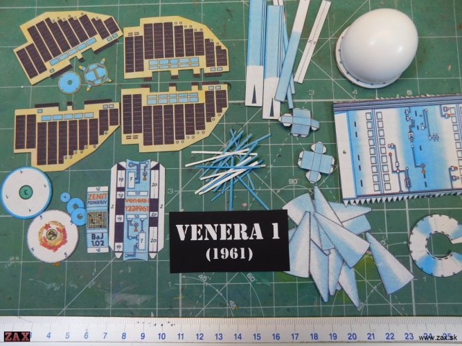

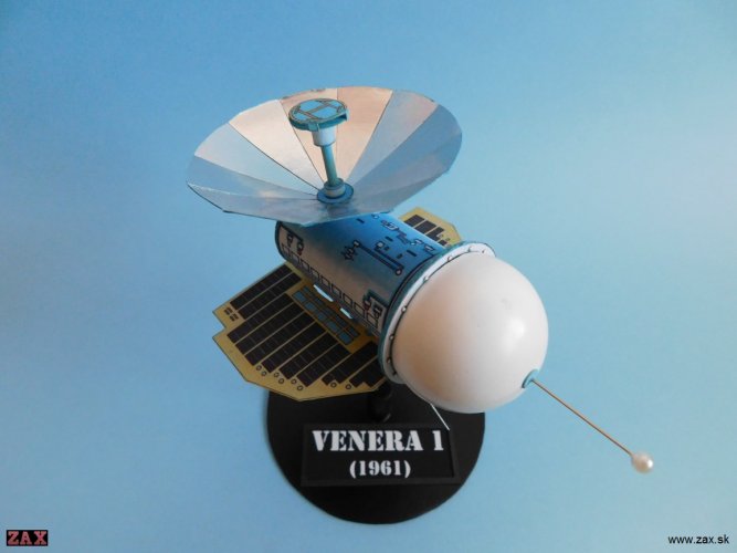

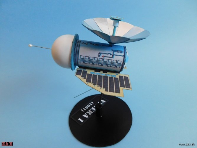

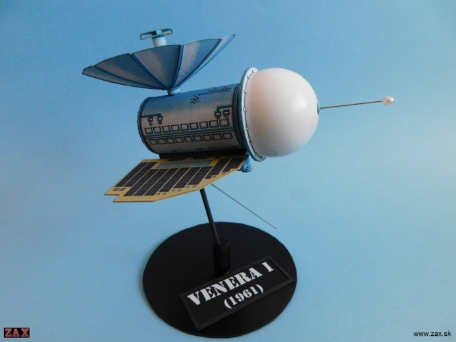

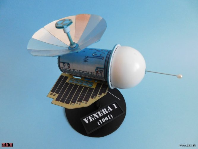

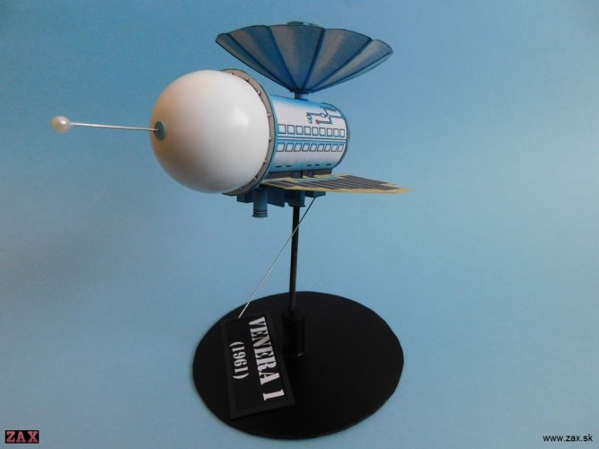

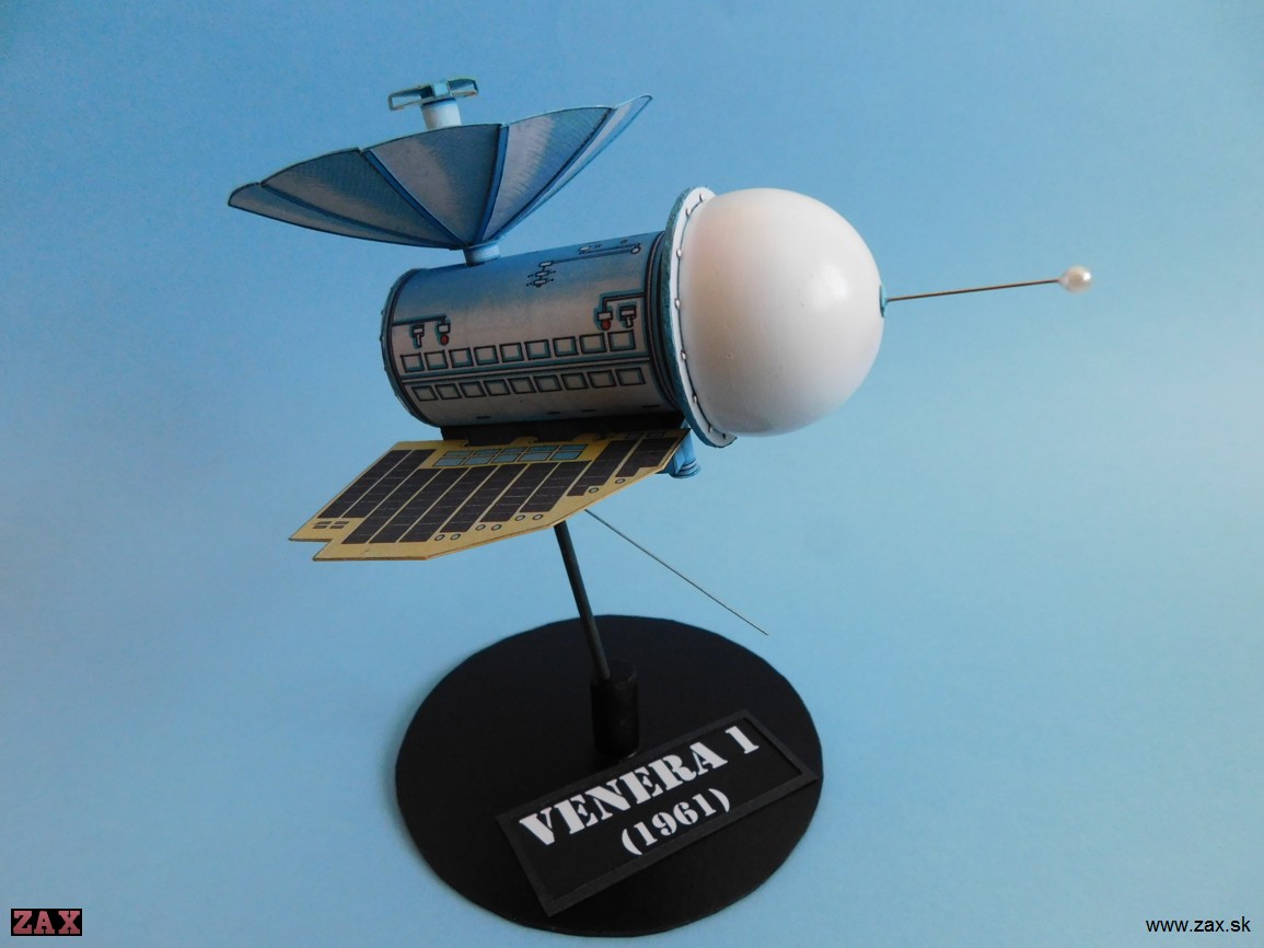

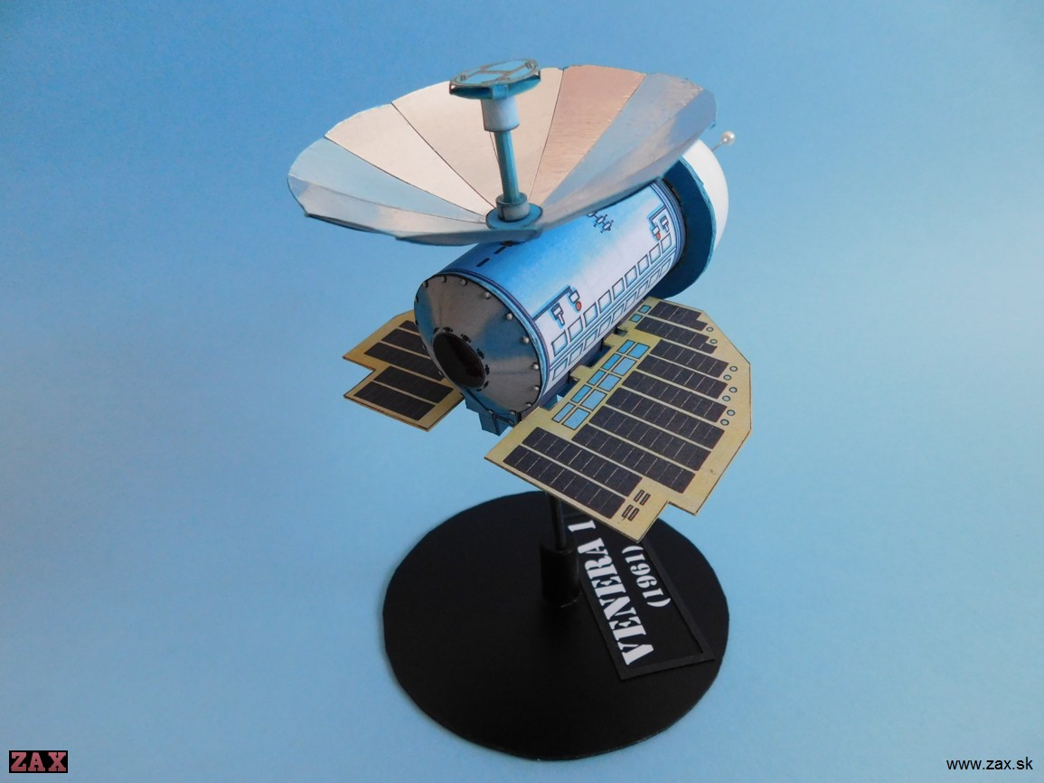

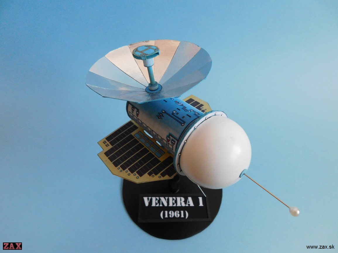

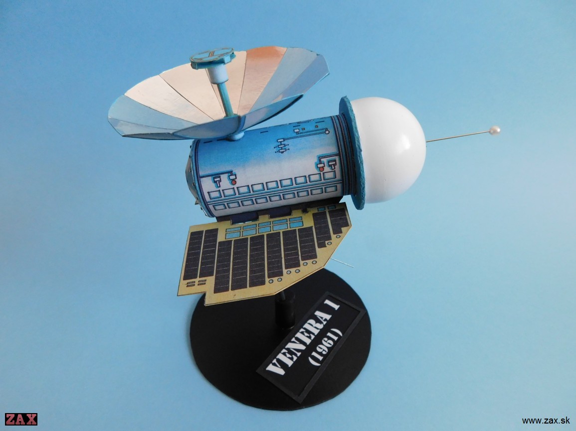

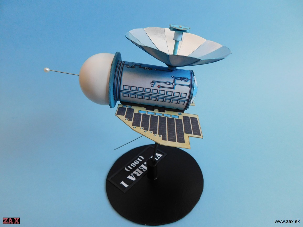

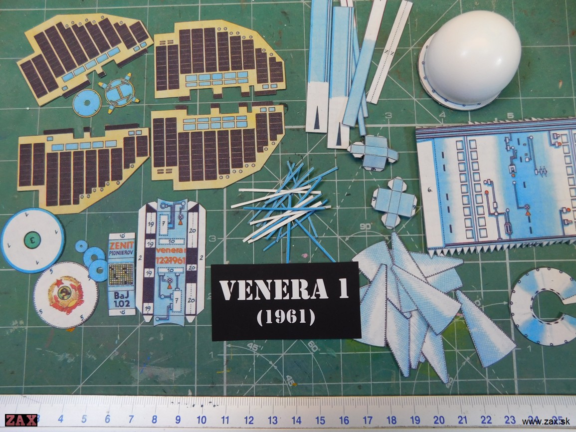

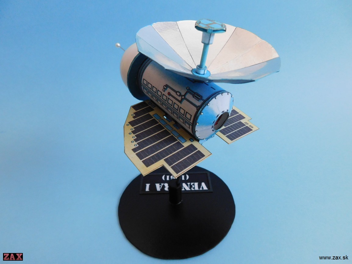

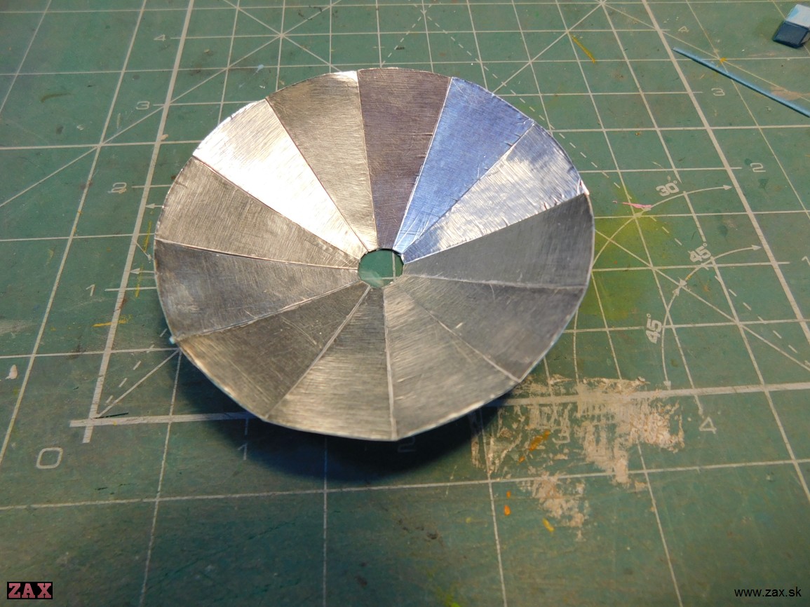

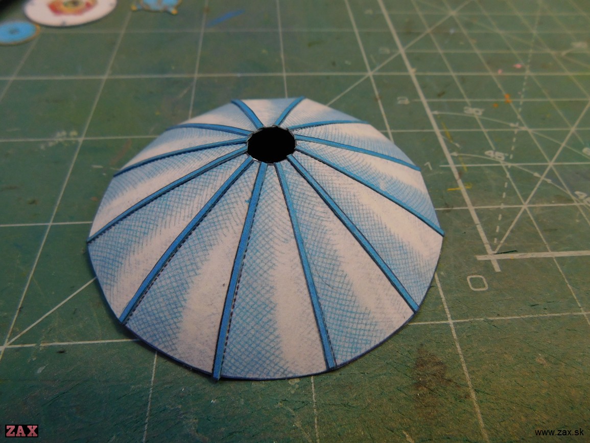

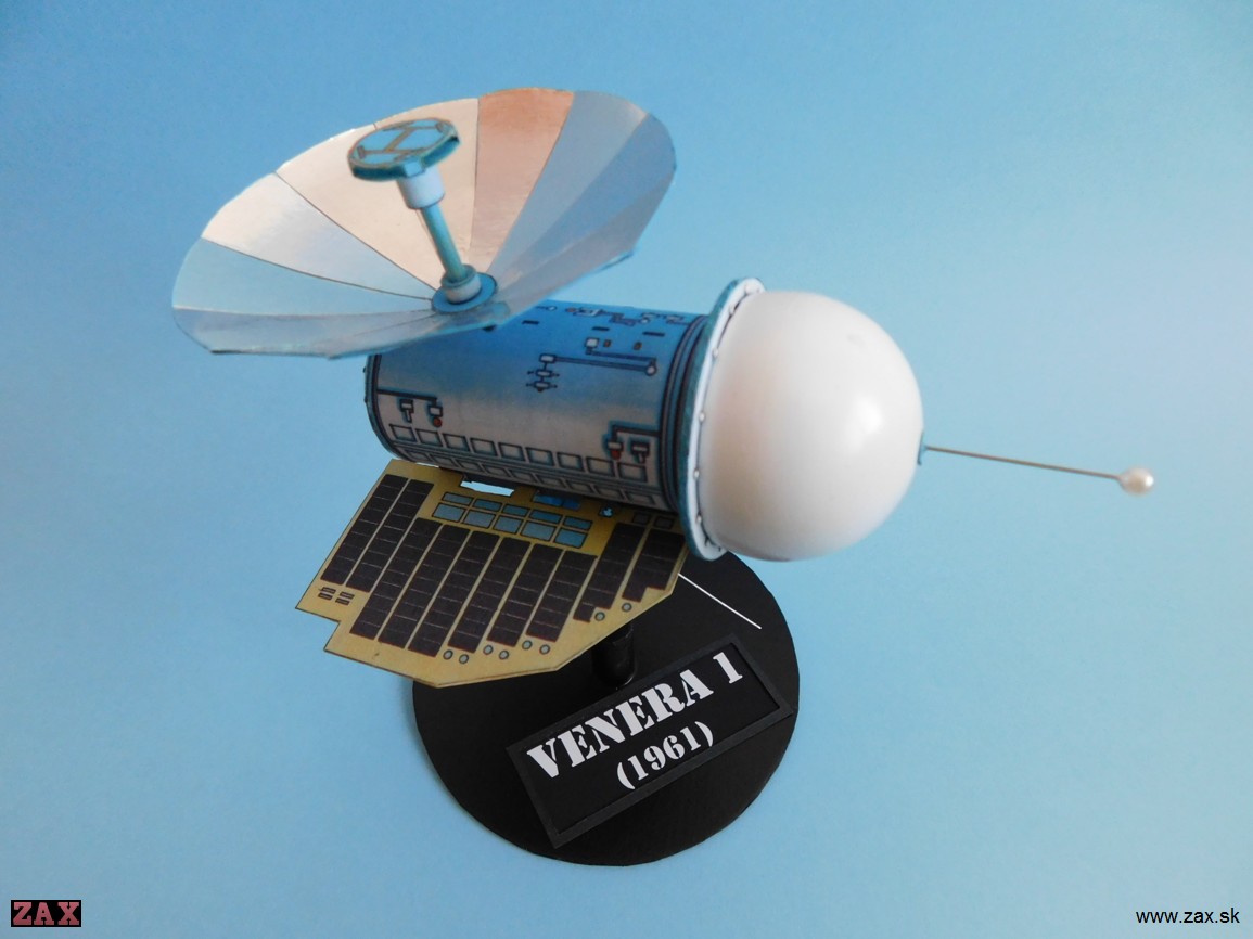

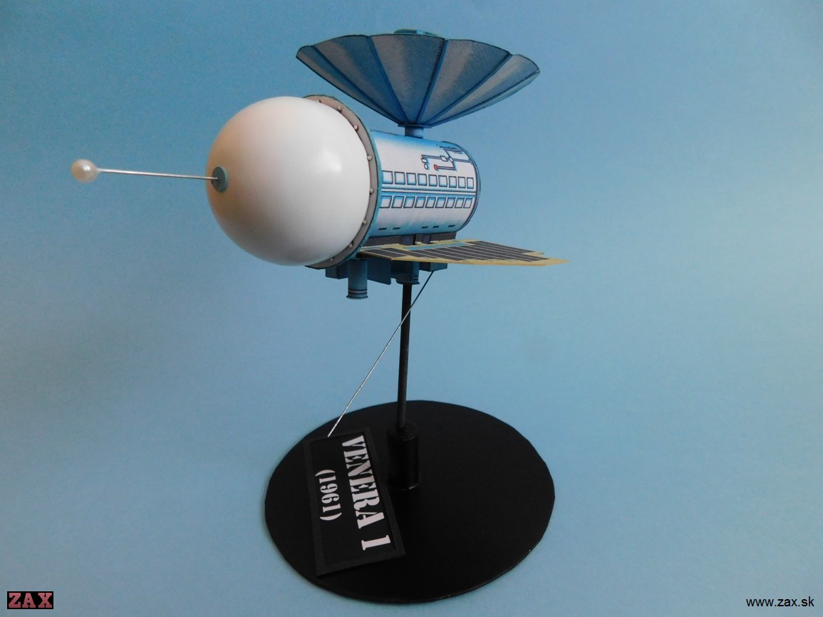

I work slowly on Venere 1, my model is cut. I started with probably the hardest parts of this model, and that is the dome of the ping pong ball, which in this case is more than half, which results in an unpleasant connecting groove ... I sealed it and sanded it and then sprayed ... it could be better, but I didn't have very good putty, so it must be enough like this ...

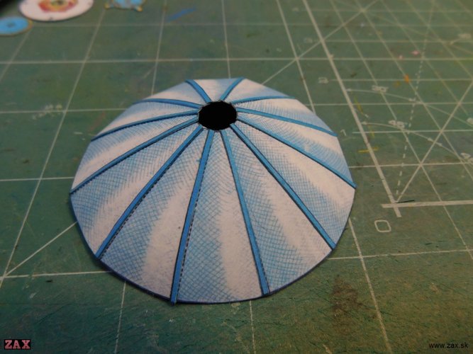

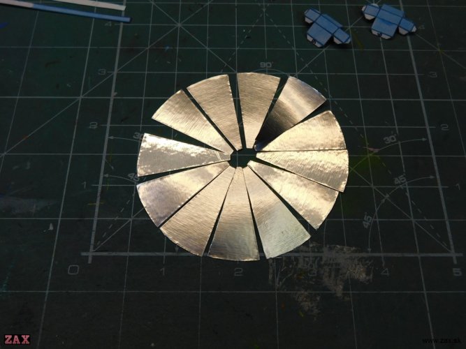

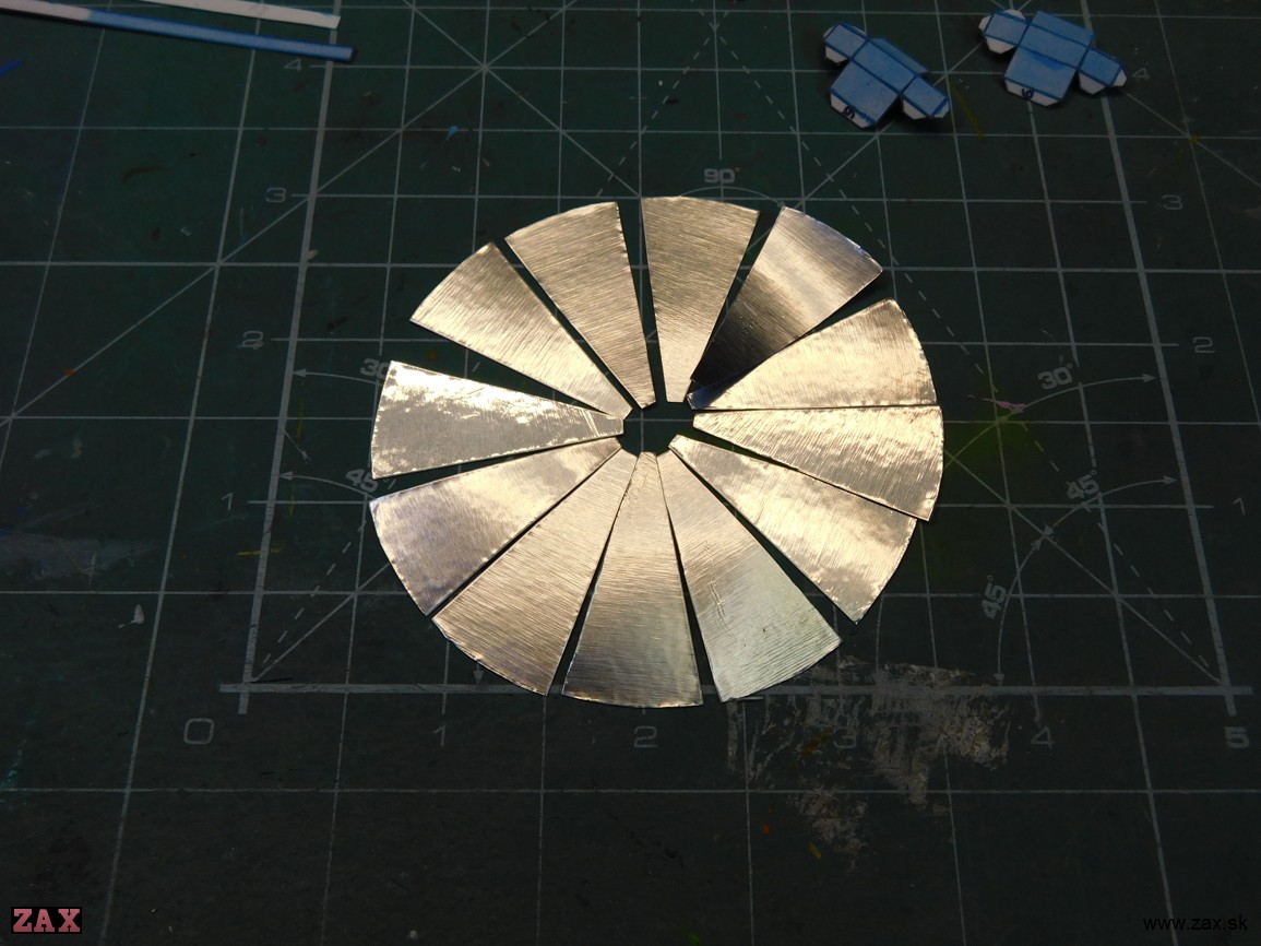

The second part I was worried about was the parabolic antenna ... I glued the inner part with aluminum tape, and it managed to stick quite well ...
Thanks ;)

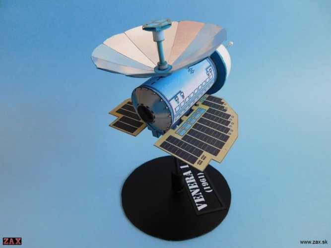

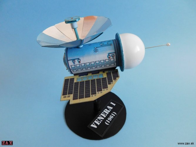

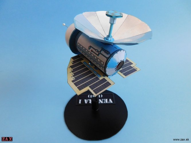

Venera 1 is complete. A few words about the probe itself:
Venera 1 was the first planetary spacecraft ever sent into space. It happened on February 12, 1961 from the Baikonur cosmodrome on the territory of the Soviet Union, which also built the probe.
After a successful start, it reached the Earth's orbit at an altitude of 196-275 km. Then, thanks to the ignition of the last stage of the rocket, it gained a second cosmic speed of about 4 km / s and thus got into orbit around the Sun. This was followed by a path correction. However, during the journey after the first week, the spacecraft fell silent 2 million km from Earth and communication with it was not restored. According to calculations of the trajectory of its orbit, it was found that it probably flew around Venus on May 20, 1961, at a distance of only 100,000 km.
1DSCN8442.jpg2DSCN8452.jpg3DSCN8458.jpg4DSCN8459.jpgDSCN8446.jpgDSCN8448.jpgDSCN8455.jpgDSCN8464.jpg
