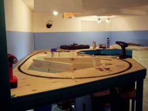

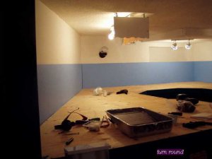

My new RR room is ready at long last.
interurban
Aug 21, 2002
4,407
78
Pickering. Ontario. Canada.

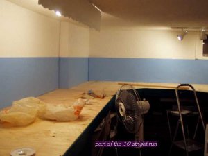

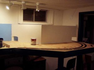

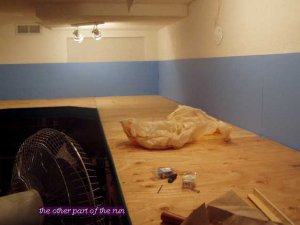

But I am to pooped to do any more. But at least I can now think about Track Plans. :cool:
A few shots of the room

Hey Chris, there is a LOT of work waiting for you! But it's always great when you have a chance for a new start. I wish you also a LOT of fun...
And I like your construction assistant. He really looks professional! :thumb: And I think he has just the right size for doing the wiring job below the layout table. :D :D :D
Ron

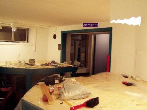

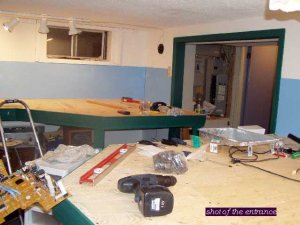

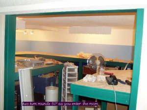

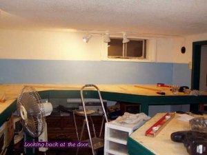

Here a the first shots.
I have started the elevation and will post them pics tomorrow.

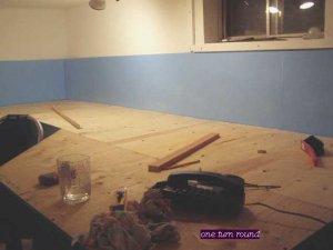

The first shot , I had to have access to the window, also me reaching days are over so all out of reach areas get covered :eek:
I have a chair on wheels that I use to scoot under to reach ares that need track cleaning and such. :cool:

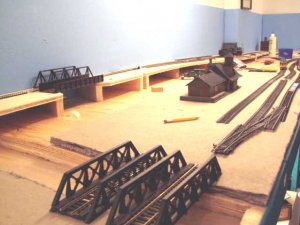

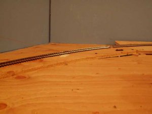

Some progress and wire up in a small section where I am going to put under a tunnel.
I will have to senic the cover soon as it will be hard to get to once the town table top is in place.

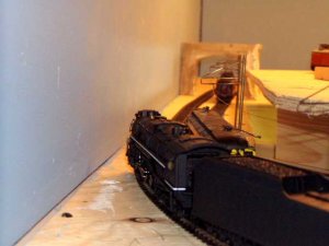

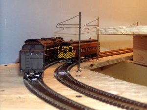

David - your proposal already has been put to practice! However, this one wasn't exactly a big mainline steamer! :D :D :D
Hehe Chris, you surely remember this thread?
Your layout is coming along fine. A question: Will everything be under catenary? Or do you have a steam/diesel road beside an electrified line?

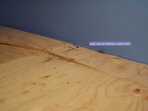

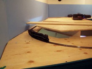

Chris it looks like great progress is starting to be made. I was wondering how did you cut the start of that incline after the plywood was already installed? Also in the second group of pictures you have a scenic divider installed will you access this area with some kind of cutout ? Thanks Pat
Hi Guys,
Ron I do remember that thread a fine elec/steam loco :thumb:
There will be a steam/diesel line and a Traction line getting the two to "gel" is the trick with the space avalible :( Problems are there to be solved , I hope :D :D
Hi Pat Yes I have access behind that section as i was out of reach , also the window can be used now.
I am about to go down to the railway 6am!! as I think I will do the same on the other side . Can not sleep till I go and look at it again. :rolleyes: :rolleyes:
I will :sleeping: later.
The incline , after marking out the area , I used a 1/2 inch hole cutter then used my trusty scroll saw . one side I placed a 3mm piece of wood underneath the raised section .on the other I screwed a piece of ply across the underneath with bit of ply screwed on that , both ways do the trick and gives you a gentle start to the elevation.

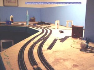

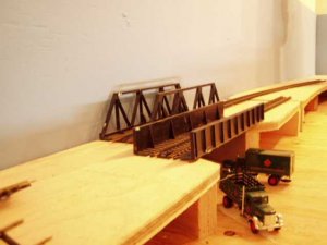

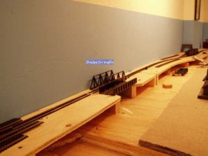

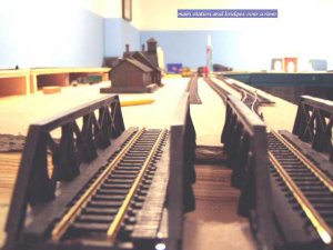

Here is the progress so far.
I am putting in two main lines one of course is traction.
I have it set in my thinking how it will pull together. the river is cut out and ready for cement, and the road bridge is in. :)
Here is the days work.

This is looking good, Chris! :thumb:
I love those sweeping curves in the third shot. I think I would choose it as my favorite railfanning spot for watching the trains go by. :wave:
Ron
